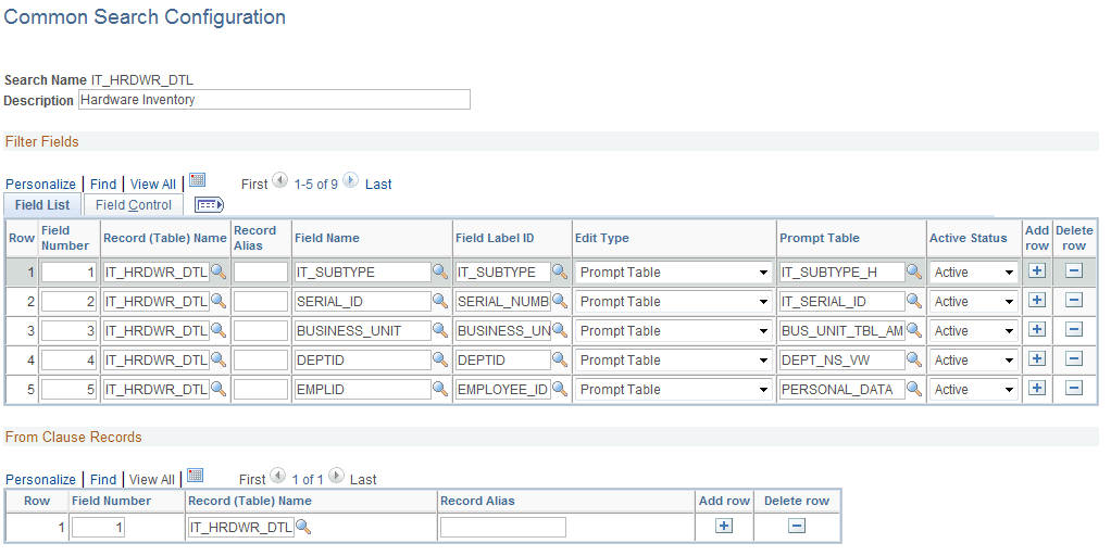

This example illustrates the fields and controls on the Common Search Configuration page: Field List tab. You can find definitions for the fields and controls later on this page.
Filter Fields – Field List tab
Field or Control Description
Field Number
Displays a number to define the order of the field.
Record (Table) Name
Displays the table name.
Record Alias
Displays a record alias. The alias is used in the SQL query for the record name.
Note: The record alias must match the value in the From Clause Records – Record Alias field.
Field Name
Displays the field name associated with the Record (Table) Name field.
Field Label ID
Select the field label ID associated with the Record (Table) Name field.
Note: Use this field to rename the field label on the search page.
Edit Type
Displays the type of edit to be used on the field. Values are:
Currency Controlled: The field is currency controlled.
No Table Edit: The system does not edit the data entered.
Prompt Table: The system uses a prompt table to display the values for that field.
Translate Table: The system displays a list of system defined values for that field.
Yes/No: The field is a radio button, select for yes, deselect for no.
Prompt Table
Displays the associated record name with a list of prompt values.
Note: This field is only available when you select Prompt from the Edit Type field.
Active Status
Select Active or Inactive.
From Clause Records
The From Clause Records section defines which records will be searched. The Record Alias defined in the Filter Field must match the Record Alias specified along with its record in the From Clause Records. The From Clause records, with their aliases, are used in the generation of the SQL at the search execution time.

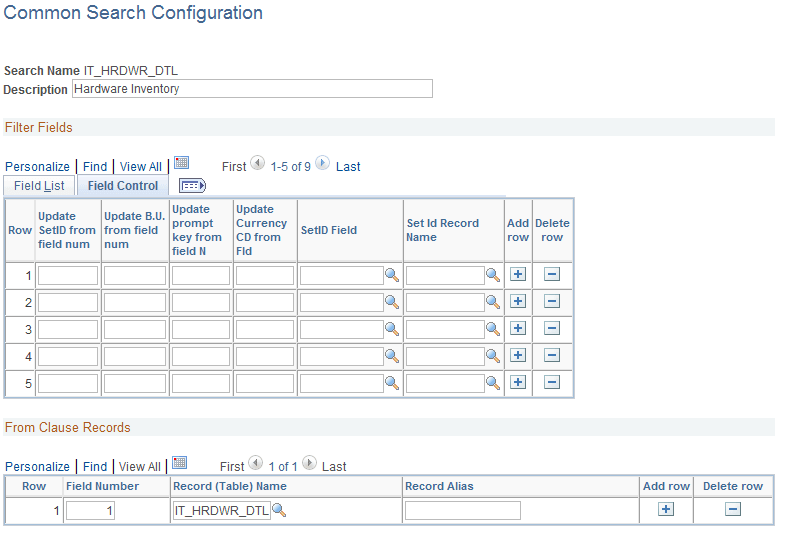

Filter Fields – Field Control tab
Select the Field Control tab.
This example illustrates the fields and controls on the Common Search Configuration page: Field Control tab.
