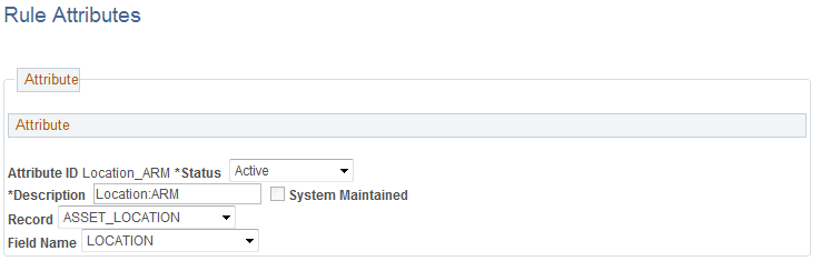

This example illustrates the fields and controls on the Rule Attributes page. You can find definitions for the fields and controls later on this page.

Field or Control Description
Attribute ID
Enter the unique system identifier for the ID.
Description
Enter the description for the attribute being defined.
Note: This description appears as an attribute and not the attribute ID.
Record
Select a record from the list. The list of records available for defining rule attributes are: ASSET, ASSET_CUSTODIAN, ASSET_LOCATION, and IT_HRDWR_CACHE.
Field Name
Select a field from the list. Values vary depending on the record that you selected.
Note: The Record field and Field Name field have a parent-child relationship. The field names vary depending on record selection.
System Maintained
This is a display-only field. ITAM delivers the SOFTWARE attribute that cannot be modified; in that case, theSystem Maintained check box displays as selected.
