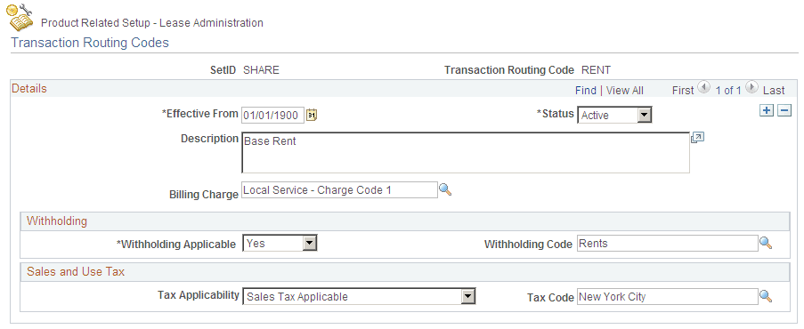

Transaction Routing Codes Page
Use the Transaction Routing Codes page (RE_TXN_ROUTE) to define transaction routing codes.
Navigation:
Set Up Financials/Supply Chain, and then Product Related, and then Lease Administration, and then Financial Terms, and then LA Transaction Routing Codes
This example illustrates the fields and controls on the Transaction Routing Codes page. You can find definitions for the fields and controls later on this page.
Details
Field or Control Description
Billing Charge
Select a billing charge. PeopleSoft Billing uses the billing charge code to process transactions for PeopleSoft Lease Administration. The billing charge classifies lease administration transactions.
Note: Billing charges apply only to receivables lease transactions.
Withholding Code
Withholding Applicable
Select whether withholding is applicable. The withholding applicable determines whether the voucher that is generated in PeopleSoft Payables is applicable to tax withholding. Values are:
Yes: Select if withholding applies on transactions associated with this transaction routing code. Withholding does not apply if the supplier on the lease does not withhold. Withholding from PeopleSoft Lease Administration overrides the withholding in PeopleSoft Payables.
No: Select if withholding does not apply.
Note: Withholding applies only to payables lease transactions.
See PeopleSoft Payables: Understanding the Withholding Process.
Withholding Code
Select the withholding code for the associated withholding applicable. The system applies the withholding code to the voucher in PeopleSoft Payables to determine the withholding amount for the lease transaction. If Withholding Applicable is set to Yes, and no value is selected for the withholding code, PeopleSoft Payables applies the standard default when the supplier is set up for withholding.
Set up supplier information accordingly on the Procurement Control - Withholding page for proper withholding defaults.
Sales & Use Tax Default
Tax Applicability
Select the tax that is applicable to payables transactions. Use this field to determine the excise duty and sales tax applicability details. Values are Direct Pay, Exempt, Exonerated, Sales Tax, and Use Tax.
Note: Tax applicability applies only to payables lease transactions.
Tax Code
Select the tax code to determine the tax percentage for a county. If Tax Applicability is set to Yes, and no value is selected for the tax code, PeopleSoft Payables applies the standard default from supplier.
See PeopleSoft Payables: Understanding PeopleSoft-Only Sales and Use Tax Processing.
