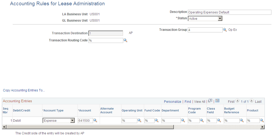

Accounting Rules for Lease Administration Page
Use the Accounting Rules for Lease Administration page (CA_ACCT_RULES) to define accounting rules for transaction destinations and transaction groups for lease transactions.
Navigation:
Set Up Financials/Supply Chain, Product Related, Lease Administration, LA Accounting Rules
When you add a new accounting rule for a lease administration business unit, you should use the same general ledger business unit that you selected on the Lease Administration Business Unit Definition - General page in the General Ledger field for that lease administration business unit.
This example illustrates the fields and controls on the Accounting Rules for Lease Administration page (partial). You can find definitions for the fields and controls later on this page.
When you define the lease administration accounting rules, you must keep in mind that the lease administration business unit can only be mapped to a single general ledger business unit. PeopleSoft Lease Administration does not support interunit accounting, therefore, only the accounting rules defined for the lease administration business unit and general ledger business unit combination can be used to generate accounting entries. For example, the lease administration business unit of US001 mapped to general ledger business unit US001 uses only those accounting rules that are defined by this business unit combination. Accounting rules defined for any other business unit combination cannot be used for processing.
