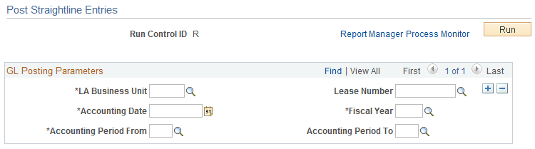

Post Straightline Entries Page
Use the Post Straightline Entries page (RE_STGL_RUNCNTL) to enter the run control parameters and run the process to insert data into the journal interface tables for the selected period.
Navigation:
Lease Administration, and then Integrations, and then Post Straight Line Entries
This example illustrates the fields and controls on the Post Straightline Entries page. You can find definitions for the fields and controls later on this page.
Field or Control Description
LA Business Unit (Lease Administration Business Unit)
Select the Lease Administration business unit to post your transactions. If you do not select a business unit, the system will process all business units.
Accounting Date
Select the date of the accounting entry recognized in the general ledger (system date or the run date).
Fiscal Year
Select the fiscal year you want to post your transaction.
Accounting Period
Select the accounting period (period in which transactions can be posted) of the transactions you want to post to the journal staging table.
