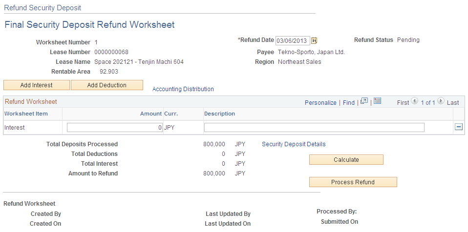

Refund Security Deposit - Final Security Deposit Refund Worksheet Page
Use the Refund Security Deposit - Final Security Deposit Refund Worksheet page (RE_REFUND) to process a security deposit refund.
Navigation:
Lease Administration, and then Receivables Leases, and then Refund Security Deposit
This example illustrates the fields and controls on the Refund Security Deposit - Final Security Deposit Refund Worksheet page. You can find definitions for the fields and controls later on this page.
Field or Control Description
Refund Date
Enter the date on which you want the system to process the refund. The system uses the current date by default, but you can change this value to any future date.
Payee
Displays the payee. If the amount to refund is positive, the payee is the entity to whom the system refunds the security deposit. If the amount to refund is negative, the payee is the entity who is responsible to pay the amount.
Add Interest
Click to insert an additional worksheet item for adding interest that was accrued for the security deposit. The system does not calculate interest for security deposits for a lease; therefore, you must track the interest manually. You can code interest to a different transaction routing code, which enables flexibility for a distinct general ledger account.
Add Deduction
Click to add deductions for damages to the property or any final charges to be paid by the tenant. You can code deductions to a different transaction routing code, which enables flexibility for a distinct general ledger account.
Refund Worksheet
When you click the Add Interest or Add Deduction button, the system inserts a new row in the refund worksheet.
Worksheet Item
Displays Interest or Deductions, depending on whether you select the Add Interest or Add Deduction option.
Total Deposits Processed
Displays the total deposits that were processed from the Security Deposits page. The system totals all of the processed deposit amounts to calculate this value. When the refund worksheet is in a processed state, the system retains the value in the worksheet and does not recalculate it.
Total Deductions
Displays the total deductions that were added to the refund worksheet.
Total Interest
Displays the total interest that was added to the refund worksheet.
Amount to Refund
Displays the amount to refund or collect. The system calculates the final refund on a worksheet that is processed back to the payee. The refund can be negative or positive, which means that the tenant might owe the landlord additional funds or the landlord might refund the deposit back to the tenant. If the refund amount is positive, then the system sends the transaction to PeopleSoft Payables. If the refund amount is negative, the system creates a billing transaction to bill additional funds to the tenant.
Security Deposit Details
Click the link to view the security deposit log on the Security Deposits page.
Calculate
Click to calculate the amount of security deposit refund. Because the security deposit refund page uses a worksheet model for processing, you can click the Calculate button as many times as needed to create what-if scenarios. The system calculates the amount to be refunded as (Total Deposits Processed + Total Interest − Total Deductions).
Note: Calculation is automatically performed when the worksheet is saved.
Process Refund
Click to send the refund request to the transaction queue for PeopleSoft Payables processing. If the deductions are greater than the security deposit amount, the system sends a request to the transaction queue for PeopleSoft Billing to send an invoice to the tenant for additional fees. The details are sent to PeopleSoft Billing even if the refund amount is zero.
After a refund worksheet is processed, the refund status is changed to Processed and the worksheet becomes read-only. When there is a pending refund transaction in the transaction queue, another refund cannot be processed.
