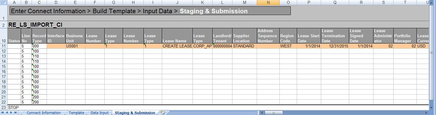

Importing Lease Information with the Excel to Component Interface Utility
The PeopleSoft system provides a template to import and add lease details and financial data from the spreadsheet to Lease Administration tables with the Excel to Component Interface utility.
Here is an overview of the steps to add lease information using import data from an Excel spreadsheet:
  1. Connect to the database by entering the database connect information on the template Connect Information tab.
    You need the PeopleSoft web server name, port, PeopleSoft Pure Internet Architecture or portal name, and default local node.
  2. Select the predefined component interface (RE_LS_IMPORT_CI) to populate the template on the Template tab.
  3. Select the fields that are used to enter data.
    Select New Data Input to format the Data Input tab with the selected data fields for the component interface.
  4. Input data for all identified and selected record levels on the Data Input tab.
  5. Stage the input data to the Staging & Submission tab.
  6. Review the data that is ready for staging on the Staging & Submission tab.
    Submit data for error-checking and transmission to the database, if successful.
  7. Errors are returned to the Staging & Submission tab; select the Post Results option to return processing errors to the Data Input tab for reworking.
  8. Submit data to the PeopleSoft Lease Administration database as needed to successfully transmit all input data to Lease Administration.
  9. Preview the lease and financial terms data, using the menu option for reviewing lease interface.
  10. Run the Process Lease Interface process to add leases to the database.
This example illustrates the fields and controls on the Example of Input Data page – Staging & Submission sheet.
Example of Input Data page Staging and Submission sheet

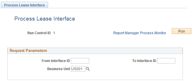

Process Lease Interface Page
Use the Process Lease Interface page (RE_RUN_LS_IMPORT) to process the leases in the interface tables.
Navigation:
Lease Administration, and then Integrations, and then Import Leases, and then Process Lease Interface
This example illustrates the fields and controls on the Process Lease Interface page. You can find definitions for the fields and controls later on this page.
Field or Control Description
From Interface ID and To Interface ID
Enter the interface IDs to process the interface transactions from the interface tables.
Note: The process selects only the interface transactions with processing status as New.

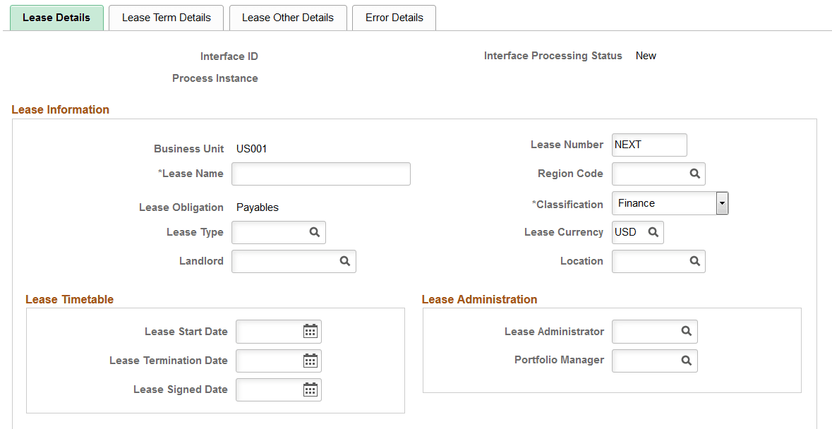

Review Lease Interface - Lease Details Page
Use the Review Lease Interface - Lease Details page (RE_INTFC_LS) to review and update the transactions in error status. You can also use this page to create Interface Leases.
Navigation:
Lease Administration, and then Integrations, and then Import Leases, and then Review Lease Interface, and then Lease Details
This example illustrates the fields and controls on the Review Lease Interface - Lease Details page.
ReviewLeaseInterface_LeaseDetails_Page_1of2
ReviewLeaseInterface_LeaseDetails_Page_2of2
Lease Obligation
Select Payables or Receivables from the drop down list.
Recognize Monthly Expense
Select this option to create monthly lease interest accounting entries for finance lease assets and monthly right-of-use (ROU) amortization for operating lease assets.
This option is available only when you select the Apply ASC 842, IFRS 16 and GASB 87 Accounting option on the Installation Options - Lease Administration page.

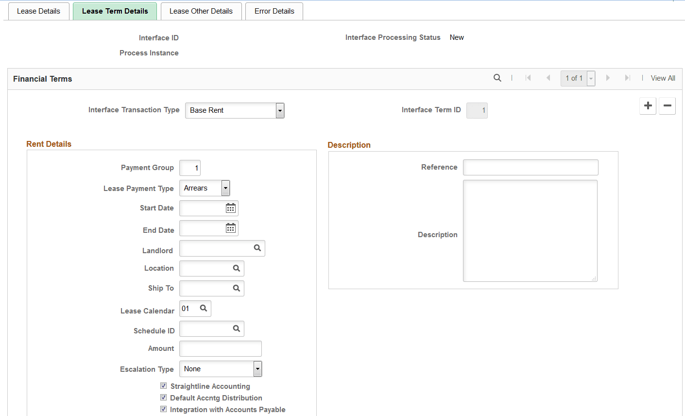

Review Lease Interface - Lease Term Details Page
Use the Review Lease Interface - Lease Term Details page (RE_INTFC_TRM) to review and make corrections to lease term details.
Navigation:
Lease Administration, and then Integrations, and then Import Leases, and then Review Lease Interface, and then Lease Term Details
This example illustrates the fields and controls on the Review Lease Interface - Lease Term Details page.
ReviewLeaseInterface_LeaseTermDetails_Page
Interface Transaction Type
Select the type of interface transaction. The available options are:
  • Base Rent
  • Initial Direct Cost
  • Lease Incentive
  • Misc Rent
  • Opex
  • Opex Category
  • Prepaid Rent
  • Purchase Option
  • Renewal Option
  • Rent Escalations
  • Termination Option
Interface Term ID
Identifies each Lease Term and is unique for each financial term like Base Rent/ Opex/ Misc Rent.
All the transactions that relate to a particular financial term have the same Interface Term ID.

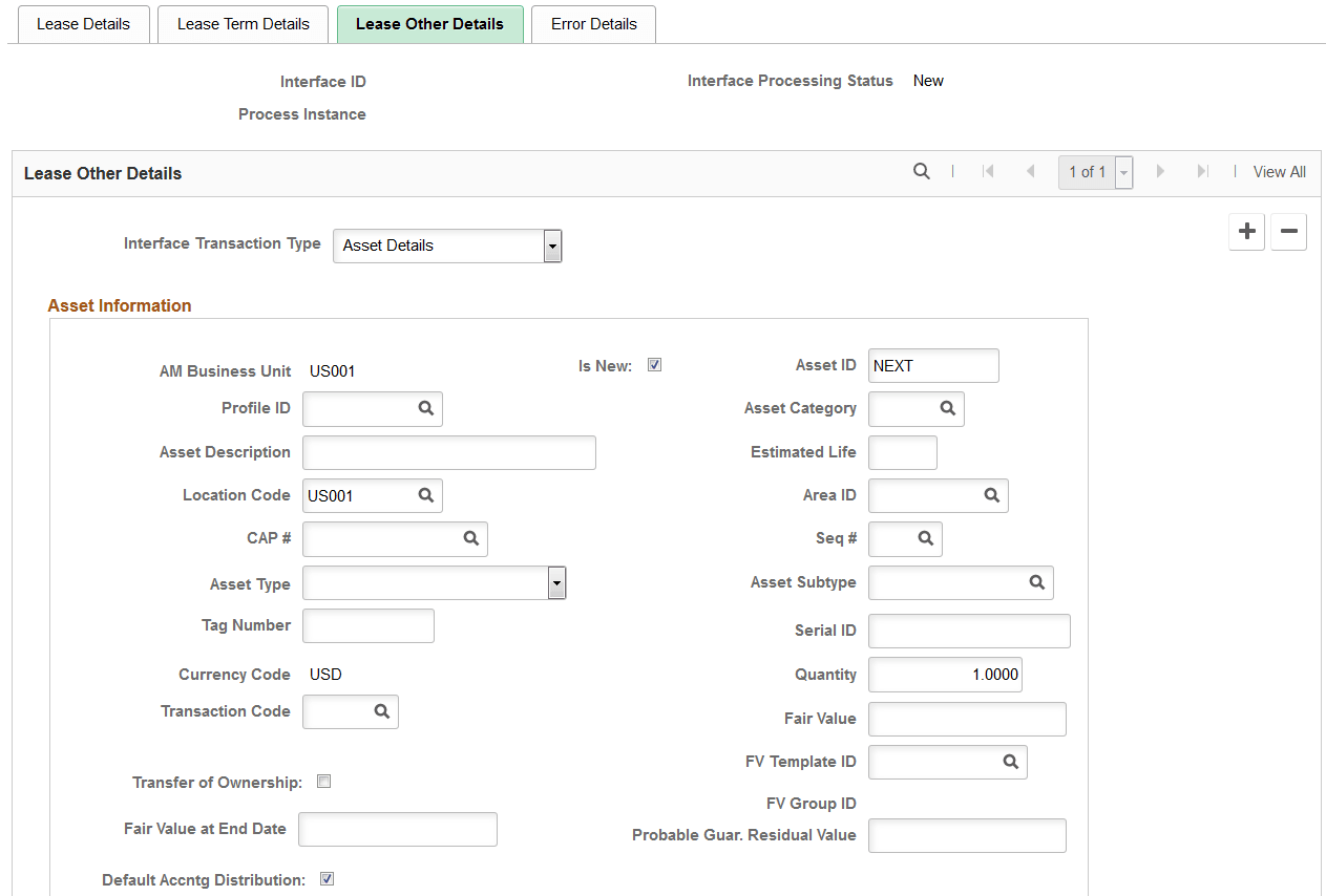

Review Lease Interface - Lease Other Details Page
Use the Review Lease Interface - Lease Other Details page (RE_INTFC_OTHR) to review and make corrections to lease details.
Navigation:
Lease Administration, and then Integrations, and then Import Leases, and then Review Lease Interface, and then Lease Other Details
This example illustrates the fields and controls on the Review Lease Interface - Lease Other Details page.
ReviewLeaseInterface_LeaseOtherDetails_Page_1of2
ReviewLeaseInterface_LeaseOtherDetails_Page_2of2
  • Asset Details
  • Clauses
Default Accounting Distribution
Select this option to use the default accounting distribution.
If you deselect this option, the Accounting Distribution grid appears, where you can modify distribution values.

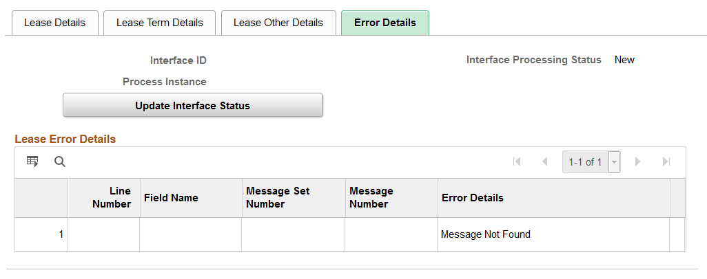

Review Lease Interface - Error Details Page
Use the Review Lease Interface - Error Details page (RE_INTFC_ERR) to review error details from the Excel to Component Interface import process.
Navigation:
Lease Administration, and then Integrations, and then Import Leases, and then Review Lease Interface, and then Error Details
This example illustrates the fields and controls on the Review Lease Interface - Error Details page.
ReviewLeaseInterface_ErrorDetails_Page
Update Interface Status
Click the Update Interface Status button to set the processing status to New after reviewing and correcting the errors to enable the lease interface process to process the lease again.

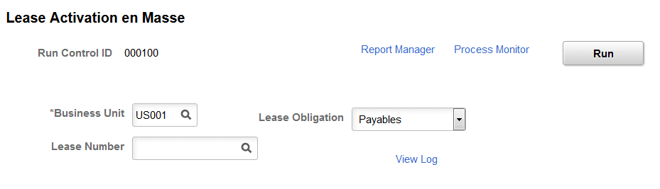

Lease Activation En Masse Page
Use the Lease Activation en Masse page (RE_LS_MASS_ACT) to activate multiple leases at once.
Navigation:
Lease Administration, and then Integrations, and then Import Leases, and then Lease Mass Activation, and then Lease Activation en Masse
This example illustrates the fields and controls on the Lease Activation en Masse page.
This page enables you to activate multiple leases at once by business unit or lease obligation type. You can also activate an individual lease by lease number.

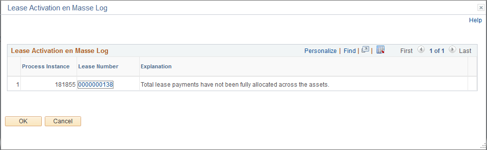

Lease Activation En Masse Log Page
Use the Lease Activation en Masse Log page (RE_RUN_MAS_LOG_SEC) to view processing and validation error information for the lease activation en mass process.
Navigation:
Lease Administration, and then Integrations, and then Import Leases, and then Lease Mass Activation, and then Lease Activation en Masse, and then Click the View Log link.
This example illustrates the fields and controls on the Lease Activation en Masse Log page.
The log only displays leases that were not activated due to a validation error. If a lease is activated without an issue, it does not appear in the log.
The Lease Number link enables you to access the Maintain Lease - General page.
