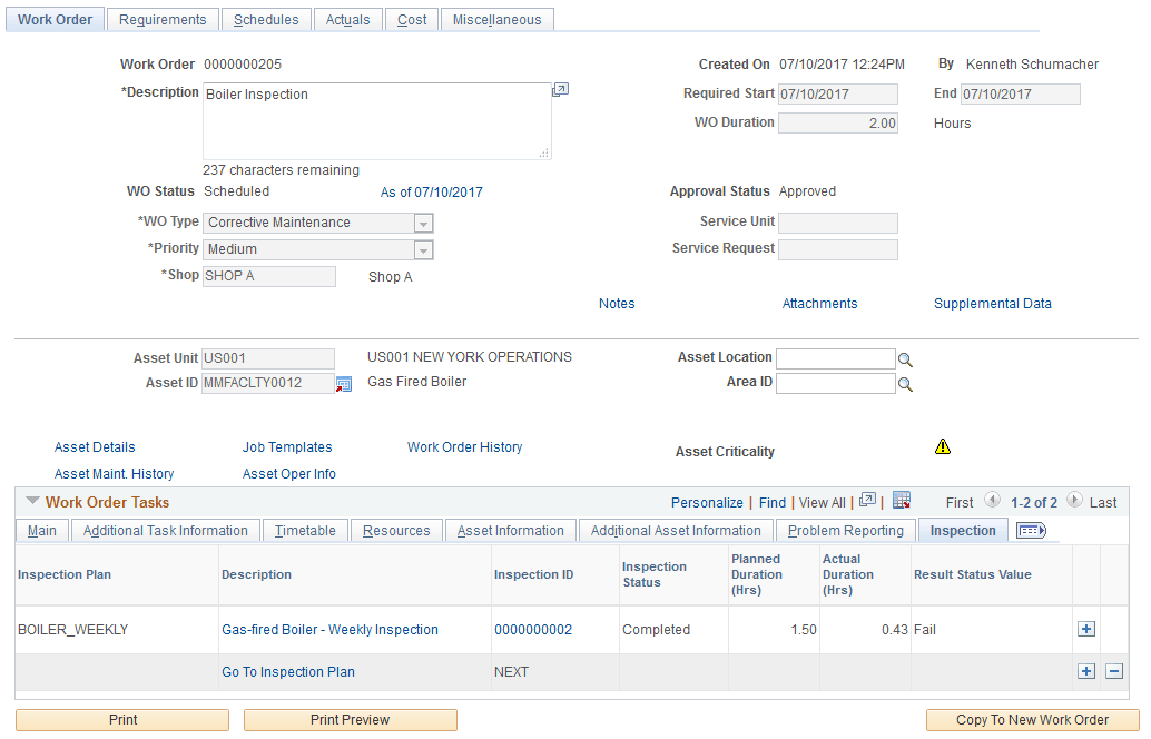

Work Order Page
Use the Work Order page (WM_WO_HDR) to enable work order tasks to be associated with inspection plans. Work orders created through PM Batch processing can automatically generate work order inspections if the Generate PM Inspections option is selected on the Work Order-Definition page. You can associate only one asset inspection instance per task.
Associating work order inspection to a task is optional.
Navigation:
Maintenance Management, and then Work Order Management, and then Work Order
Click the Inspection tab.
This example illustrates the fields and controls on the Work Order page-Inspection tab. You can find definitions for the fields and controls later on this page.
Work Order Inspection Tab
Field or Control Description
Inspection Plan
Displays the inspection plan associated to the task.
Description
Displays the inspection plan details. Click the Go To Inspection Plan link and select the required inspection plan for the task.
Inspection ID
Displays the sequential inspection ID automatically generated for the new inspection instance. Click the ID to view the details of the inspection.
Note: The inspection plan details displays in a new window. You can either start working on the inspection in the new window or access the inspection instance using the Work Order Inspection component.
See Completing Work Order Inspections.
If an inspection plan is not associated to the task, the field displays the value as NEXT.
Inspection Status
Displays the status of the inspection.
Planned Duration
Displays the total time required to complete all the inspection activities.
Actual Duration
Displays the total time taken to complete all the inspection activities.
Result Status Value
Displays the inspection result value.

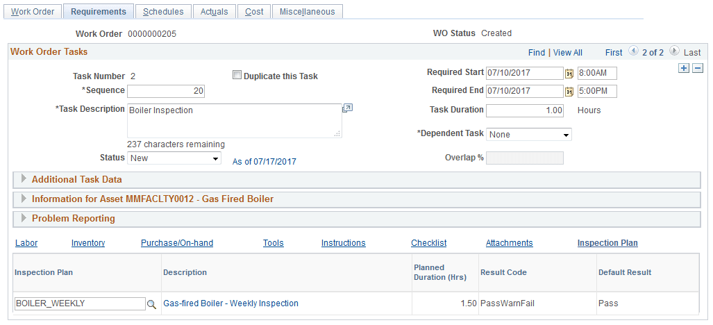

Requirements Page
Use the Requirements page (WM_WO_TASK_RQMT) to select the inspection plan for the particular work order task.
Navigation:
Maintenance Management, and then Work Order Management, and then Requirements
Click the Inspection Plan tab.
This example illustrates the fields and controls on the Requirements page-Inspection Plan tab. You can find definitions for the fields and controls later on this page.
Work Order Requirements Page Inspection
Inspection Plan
Click the Search icon to select the related inspection plan for the task. The selected inspection plan displays in the Work Order page and Schedules page.
Description
Click this link to view the current inspection plan details or to modify them.
Result Code
Displays the possible inspection result values as set in the inspection plan.
Default Result
Displays the expected inspection result as set in the inspection plan.

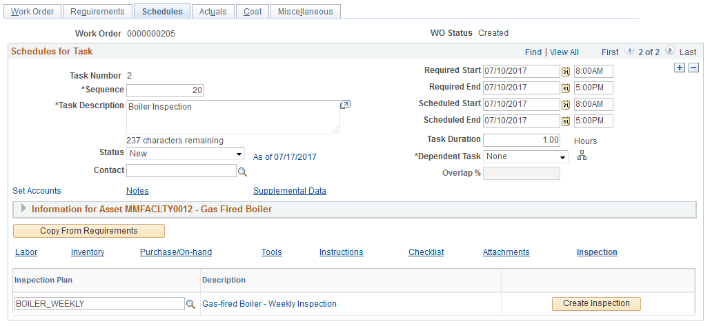

Schedules Page
Use the Schedules page (WM_WO_TASK_SCHED) to create an actual inspection.
Navigation:
Maintenance Management, and then Work Order Management, and then Schedules
This example illustrates the fields and controls on the Schedules page-Inspection Plan tab. You can find definitions for the fields and controls later on this page.
Work Order Schedules Page Inspection Tab
Create Inspection
Click this button to create the work order inspection instance. In the new window displayed, make the required changes to the work order inspection and save it. After saving the work order, both the Schedules and Inspection tabs display the automatically assigned next available sequential inspection ID as tracked on the associated WO Business Unit definition.
Click the ID to initiate the inspection in the new window. Also, you can separately work on the inspection instance using the Work Order Inspection component.
