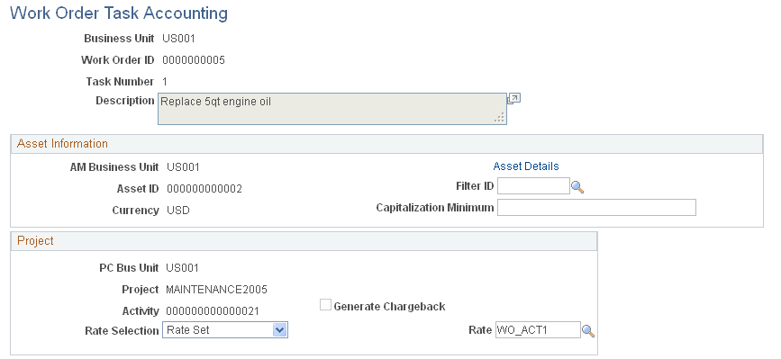

Work Order - Task Accounting Page
WM_WO_TSK_ACCTG
Set up asset capitalization and chargeback information.

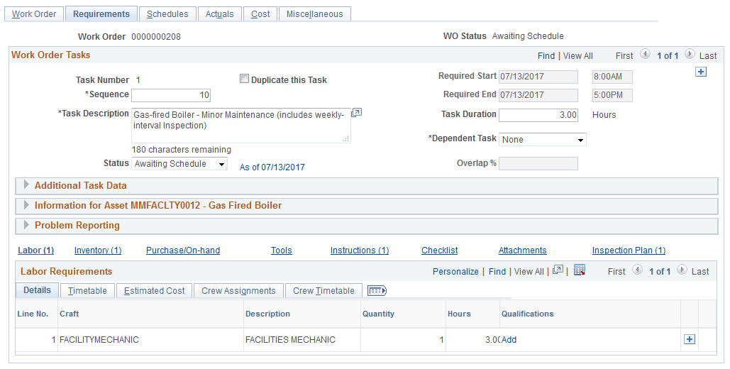

Requirements Page
Use the Requirements page (WM_WO_TASK_RQMT) to create and update work order tasks and task requirements.
Navigation:
Maintenance Management, and then Work Order Management, and then Work Order
Select the Requirements tab.
This example illustrates the fields and controls on the Requirements page. You can find definitions for the fields and controls later on this page.
Requirements page
Field or Control Description
Task Number
The system generates a number for each task.
Duplicate this Task
Select the check box and then click the plus sign in the upper right corner of the Work Order Tasks group box to create a copy of this task.
Note: You can also click the plus sign in the upper right corner of the Work Order Tasks group box to insert another blank task. You can create as many tasks as needed using this method. You can click the minus sign in the upper right corner of the Work Order Tasks group box to delete a task.
Sequence
Enter the number that represents the numerical order within the work order in which to complete this task.
Required Start and Required End
Select the start and end dates and times. The default start and end date values are derived from the work order header. You can override this information.
Task Description
Enter a brief description of this task. This field is required.
Duration
Enter the total number of hours and parts of an hour that the task will take to complete.
Dependent Task
Select the task that must be performed before this task can be started for work orders associated with more than one task.
Status
Select the user-defined status for this task based on the statuses in the list. The work order task status values are user defined and correspond to system-defined internal statuses. The values that display in this list are determined by the allowable status transitions that are set up when you set up the work order task statues. Workflow approval also affects the statuses that you can choose from. For example, if workflow approval is required (based on the business unit, work order type, or shop setup), then only the Open, Canceled and On Hold statuses are available until the work order task is approved. Tables that define the behavior of each status are defined in the Setting Up Service Request and Work Order Statuses topics.
See Understanding Work Order Task Completion.
As of mm/dd/yyyy
Click this link to access the Task Status History page, which lists the changes in status for this task as of the date specified in this link.
Overlap % (overlap percentage)
Enter the percentage that this task overlaps with the dependent task. You can load this information into Microsoft Project.

Set Accounts
Click this link to access the Work Order Task Accounting page.

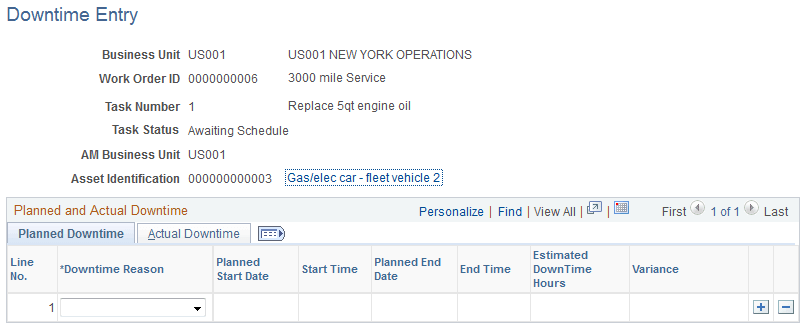

Downtime Entry Page
Use the Downtime Entry page (WM_WO_DOWNTIME) to enter the start and end dates and times that the asset will be unavailable for use.
Navigation:
  • Click the Asset Downtime link on the Requirements page of the Work Order component.
  • Click the Asset Downtime link on the Schedules page of the Work Order component.
  • Maintenance Management, Work Order Processing, Downtime Entry
  • Click the Downtime link on the Task Actual Dates/Time tab of the Work Order Tasks grid in the Technician Workbench
This example illustrates the fields and controls on the Downtime Entry page. You can find definitions for the fields and controls later on this page.
Downtime Entry page
The Downtime Entry page header information is derived from the asset description in the work order task.
Planned Downtime
Select a reason for the downtime and then select the proposed start and end downtime dates and times, and enter the number of yours that you think the asset will be down. When you save the page, the variance field initially displays the hours of proposed downtime.
Actual Downtime
You can modify the Downtime Reason if necessary. Enter the actual dates and times that the asset was down and the number of hours that it was down. When you save the page, the variance on the Planned Downtime tab displays any difference. For example, if you planned for the asset to be down for repair for 4 hours and it only took two hours to repair it, then the Variance field will display – 2.000.
Click the Set Accounts link on the Requirements page to access the Work Order Task Accounting page.
This example illustrates the fields and controls on the Work Order - Task Accounting page. You can find definitions for the fields and controls later on this page.
Asset Information
AM Business Unit Asset Management business unit
The default value is derived from the business unit set up in the User Preferences, and then Maintenance Management page.
Asset ID
This value only displays if you select an asset in the work order header or in the work order task.
Filter ID
Select the an express asset filter ID. These filters are set up in the Set Up Financials/ Supply Chain, and then Product Related, and then Project Costing, and then General Options, and then Express Asset Filter Criteria. Filters specify in PeopleSoft Project Costing which transaction costs are allowed to make up the cost basis of the asset. The delivered sample data filters are "Filter 1" and "Filter 2". Filter 1 identifies that Material and Labor actuals should be considered for capitalization, and Filter 2 identifies that only Labor actuals should be considered.
See PeopleSoft Project Costing: Express Asset Filter Criteria Page.
Currency
The currency value is derived from the primary book of the Asset Management business unit.
Capitalization Minimum
Enter the minimum cost for maintaining or repairing the asset associated with this work order task that must be reached before the costs are capitalized by PeopleSoft Project Costing.
Project
PC Bus Unit
This default value comes from the Project Costing business unit set up in the work order business unit's Integration page.
Project and Activity
These values are based on the project and activity associated with the work order and work order task.
Rate Selection
Select Rate Set or Rate Plan, which are set up in PeopleSoft Project Costing. The default value in this field is set up on the work order business unit's Integration page. Rate sets and rate plans work in conjunction with chargeback to a calculate premium or discount to chargeback based on work performed.
See Work Order Business Unit Integration Options.
Rate
Select the user-defined rate based on whether you selected Rate Set or Rate Plan for the Rate Selection field.
Generate Chargeback
Select this check box to enable PeopleSoft Project Costing to calculate chargeback amounts for this work order task based on the selected rate set. When you select this check box, the following field display for you to enter the accounting information necessary to complete the chargeback in PeopleSoft Project Costing.
Note: To enable this check box, you must select the Enable Organization check box on the Installation Options - Project Costing page. You must complete any of these fields that display on the page if you want chargeback processing to occur in PeopleSoft Project Costing for this work order task. The fields that display are determined by the set up of the General Options - Organization Hierarchy for PeopleSoft Project Costing product-related setup.
GL Business Unit
Select the GL Business Unit to associate with this chargeback. This field appears if you select the Generate Chargeback check box.
Department
Select a department to which these work order task costs should apply depending on your organization's setup.
Fund Code
Select a fund code to which these work order task costs should apply depending on your organization's setup.
Activity
Select the project activity to which these work order task costs should apply.
Product
Select the product to which these work order task costs should apply, if applicable.
