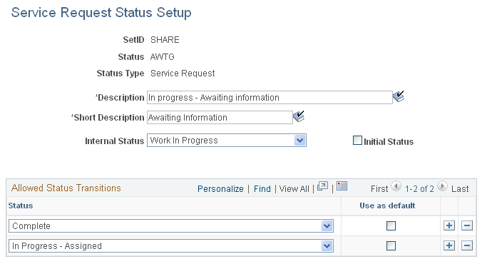

Service Request Status Setup Page
Use the Service Request Status Setup page (WM_STATUS) to defines service request status values specific for an organization and matches them with the Maintenance Management required system-defined internal statuses.

This example illustrates the fields and controls on the Service Request Status Setup page. You can find definitions for the fields and controls later on this page.
Field or Control Description
Status
Enter a status code when you add a new value that is recognizable to your end users. This value is matched with one of the required system-defined internal status values.
Status Type
Displays default value of Service Request.
Internal Status
Select the Internal Status to match with this user-defined status. Internal statuses for service requests include:
  • Canceled.
  • Closed.
  • Complete.
  • Open.
  • Work in Progress.
  • Work Order Created.
Initial Status
Select this check box if you want this value to be the initial status when a service request is created. You can only select one of the service request statuses at any given point in time.
Allowed Status Transitions
Status
Lists allowable status transitions based on the internal status transition you select and the number of defined statuses you created.
Note: The Allowed Status Transitions group box appears only if you create a status with an internal status value of Open, Work in Progress, Work Order Created, and Complete. It does not display if the internal status value is Canceled or Closed.
Use as default
Select one or more of the Use as Default check boxes to indicate the new status of the service request when a user clicks the Reopen or Close buttons on the Service Request. If two or more transition statuses have the same internal status, then you can only check one of them. Oracle recommends that you do not change the status setup as delivered, but if you do, make sure the transition grid for the Complete status contains at least one transition status for Work in Progress and one for Closed selecting the Use as Default check box on each.
For example, the current status of a service request is Complete and you want to reopen the service request by changing the status back to Assigned. If you have multiple user defined assigned statuses, then you must identify which of these user defined assigned statuses is the default status that you want to display when you reopen a service request. This also applies when you close a service request.
