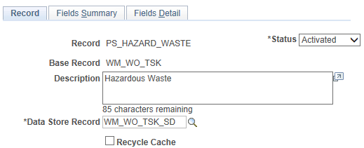

Define Record - Record Page
Use the Define Record - Record page (SD_RECDEFN) to defines the supplemental data record associated with the base record and identifies where to store this record.
Navigation:
Set Up Financials/Supply Chain, and then Product Related, and then Maintenance Management, and then Supplemental Data, and then Define Record, and then Record
This example illustrates the fields and controls on the Define Record - Record page. You can find definitions for the fields and controls later on this page.
Field or Control Description
Record
Enter a name for a supplemental data record. For example a possible supplemental data record name used for PeopleSoft Maintenance Management may be PS_WASTE.
Base Record
Select a base record on the Define Record page to associate with this supplemental data record. For example, a PeopleSoft Maintenance Management base record is WM_WO_TSK.
Status
Select a status of In Design during the time that you are defining this record. Change the status to Activated to indicate that you completed mapping the supplemental data fields.
Note: If you update a record, before you add a field or make changes to a record, you must change this status back to In Design. When you have completed the modification, you must change the status back to Activated before saving and exiting the component.
Data Store Record
Select one of the data store records that you previously registered that you want to use to store this supplemental data record. For example, the data store record for this supplemental data record in PeopleSoft Maintenance Management is WM_WO_TSK_SD.
Recycle Cache
Select the check box to clear the cache when you save the configuration.

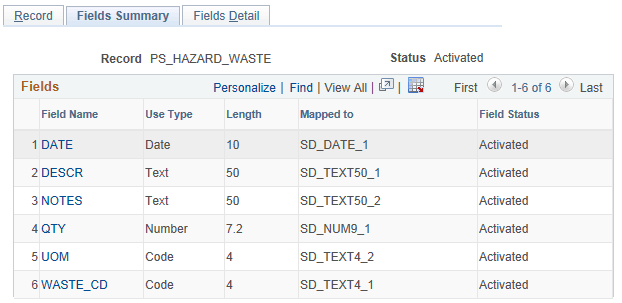

Define Record - Fields Summary Page
Use the Define Record - Fields Summary page (SD_RECFLD) to maps fields to the data storage fields.
Navigation:
Set Up Financials/Supply Chain, and then Product Related, and then Maintenance Management, and then Supplemental Data, and then Define Record, and then and select the Fields Summary tab.
This example illustrates the fields and controls on the Define Record - Fields Summary page. You can find definitions for the fields and controls later on this page.
Field Name, Use Type, Length, Mapped to and Field Status
Click the Field Name link to access the Fields Detail page. The remaining fields on this page are all defined in the Fields Detail page. Once you finish adding all the fields and their descriptions on the Field Details page, and change the Status value in the Record page to Activated, each new field name and its characteristics appear on this summary page. You may then click on each field name and access the field name's detail information in the Define Record - Fields Detail page.

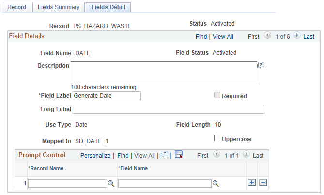

Define Record - Fields Detail Page
Use the Define Record - Fields Detail page (SD_RECFLD_DTL) to defines a field's detail information.
Navigation:
  • Set Up Financials/Supply Chain, and then Product Related, and then Maintenance Management, and then Supplemental Data, and then Define Record, and then Fields Detail
  • Click a field name on the Define Record - Fields Summary page.
This example illustrates the fields and controls on the Define Record - Fields Detail page. You can find definitions for the fields and controls later on this page.
Field Name
Enter a name for the supplemental data field and a description of the field. For example, in PeopleSoft Maintenance Management this field might be called WASTE_CD.
Field Label
Enter the a label to display on the page for this field. For example, in PeopleSoft Maintenance Management this field might be Waste Code.
Use Type
Select one of the following based on how the field will be used:
  • Code
  • Number
  • Signed Number
  • Text
  • Time
  • Date
  • Prompt
  • Section
  • Yes/No
Field Length
Select a length based on the selected Use Type:
  • If the use type is a number or signed number consisting of an integer or decimal position, the field lengths may only be: 9.0, 7.2, and 15.4.
  • If the use type is text, the field length may be 4, 20, 50, or 100.
  • If you select any of the remaining use types, each type's field length is dictated by the specific length of the selected use type.
Mapped To
Select the data store field to which you want to map this field.
Once you change the status to Activated on the Record page, the information listed above, with the exception of the description and field label, becomes read-only and cannot be modified.

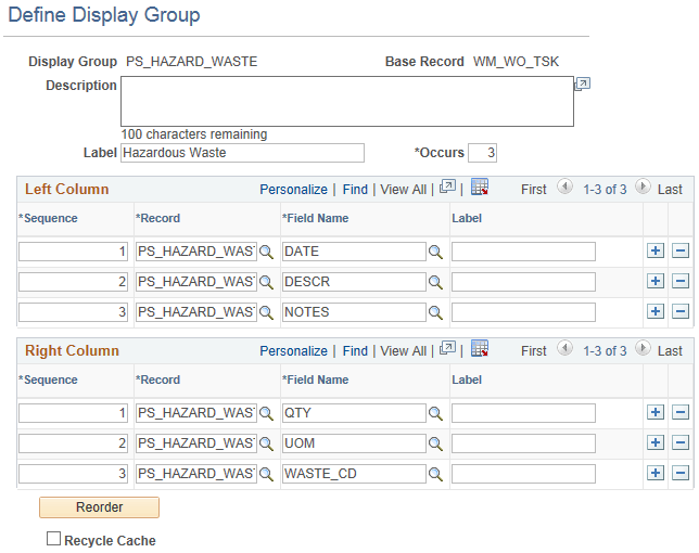

Define Display Group Page
Use the Define Display Group page (SD_GRPDEFN) to defines a display group and associates any records and fields, as well as identifies the order in which the fields appear on the page.
Navigation:
Set Up Financials/Supply Chain, and then Product Related, and then Maintenance Management, and then Supplemental Data, and then MM Define Display Group
This example illustrates the fields and controls on the Define Display Group page. You can find definitions for the fields and controls later on this page.
Display Group
Select a base record to associate this new display group with and enter a name for this display group in the Define Display Group Add page.
Label
Enter a label for the display group data group box.
Occurs
Enter the number of rows of data to display in the group box.
Recycle Cache
Left and Right Columns
The supplemental fields that you want to appear on a page are defined in left and right columns.
Sequence, Record, Field Name, and Label
Select the record and field name, enter a label that you want to display on the page for the field name for each supplemental data field. Enter a sequence number to determine the order in which the fields should display on the page for each column.

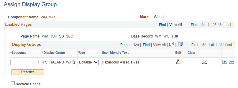

Assign Display Group Page
Use the Assign Display Group page (SD_PAGE_GRP) to assigns one or more display groups to a supplemental data-enabled component and page.
Navigation:
Set Up Financials/Supply Chain, and then Product Related, and then Maintenance Management, and then Supplemental Data, and then MM Assign Display Group
This example illustrates the fields and controls on the Assign Display Group page. You can find definitions for the fields and controls later on this page.
Component Name and Market
Select the component that is enabled for supplemental data and with which you want to associate a supplemental data display group in the Assign Display Group Search page. The Market for which this component was defined displays as read-only along with the Component Name.
Enabled Pages and Display Groups
This group box displays the name of the pages within the component that are enabled for supplemental data, their associated base record, and any associated display groups. You may also add the display groups that you want to appear in this component and page.
Sequence, Display Group, Use
Add a supplemental data display group that you want to associate with this component and this page, and select whether you want the text associated with the display group to be Editable or Read-only.
User Friendly Text
Describes the condition associated with this display group in easy to understand terminology.
Edit
Click the Edit icon to access the Assign Display Group - Conditions page where you can establish conditions that control when a display group appears. For example, you could set a condition so that a display group appears only when there is a hazardous asset associated with a work order task, or when the work order is of the type CM (corrective maintenance).
Clear
Click the Clear icon to remove the condition that is associated with this display group.
If the supplemental data page is registered as a search page, then you may add only one display group to the page; you must select 1 as the value in the Occurs field for the selected display group; you must define all fields for this display group for the same record definition; and you must map this record to a data store record defined with a Search Supplemental Search record. With PeopleSoft Maintenance Management, you can only search based on supplemental data for the Work Order Header.
