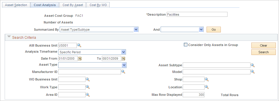

Cost Analysis Page
WM_COST_ANALYSIS
Search for the assets that you want to display and analyze on this page based on one or more specific dimensions.

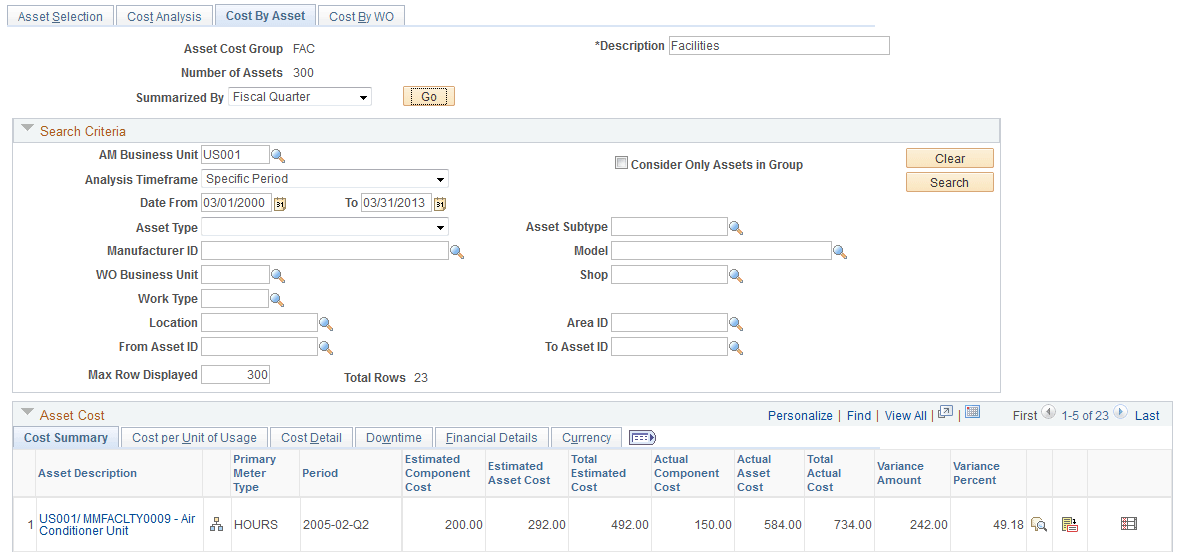

Maintenance Cost by Asset
WM_COST_BY_ASSET
Review the work order and non-work order related maintenance costs for a specific asset.

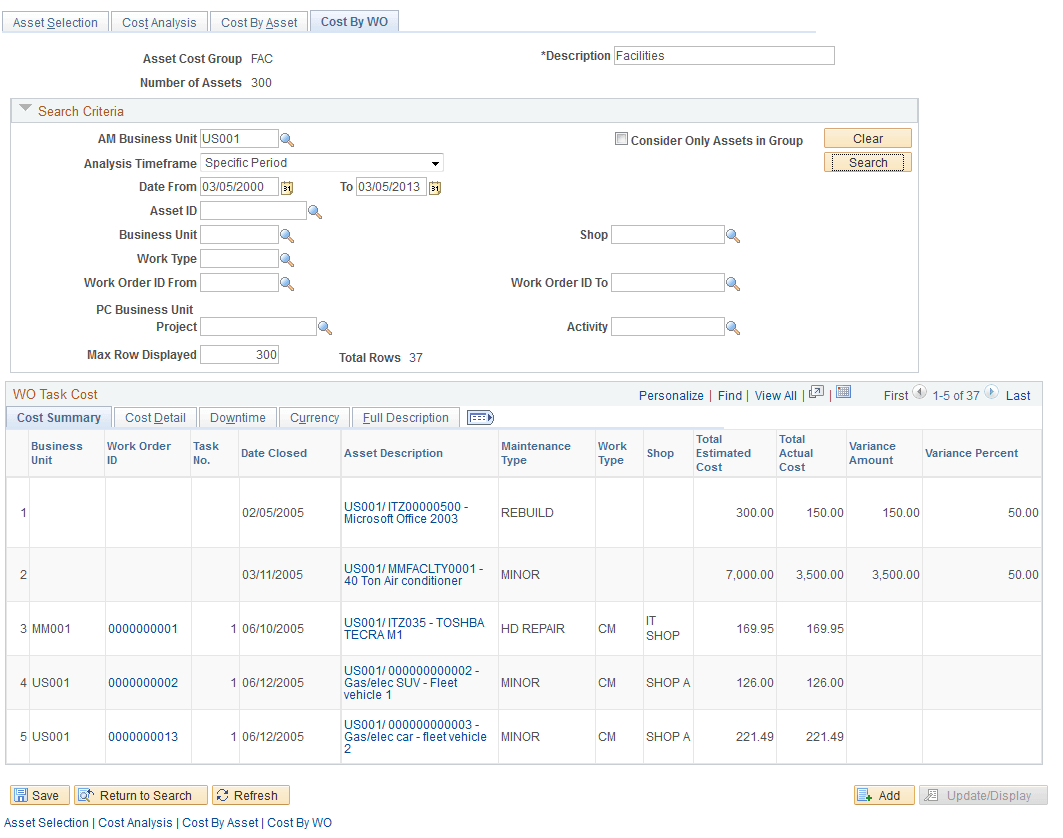

Maintenance Cost by Work Order
WM_COST_BY_WO3
Review any work order costs associated with the selected asset.

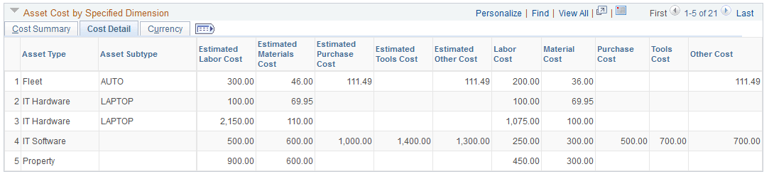

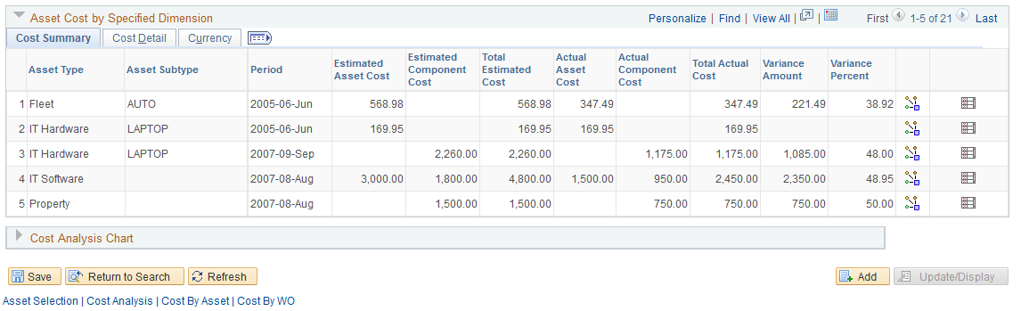

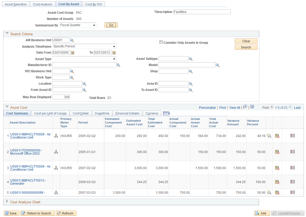

Asset Maintenance Cost Inquiry Overview
Use the Asset Maintenance Cost Inquiry in PeopleSoft Maintenance Management to analyze work order and non-work order related asset maintenance costs for assets based on a specified time frame. The work order costs are based on work orders that are closed in PeopleSoft Maintenance Management and updated in the Asset Maintenance History. The non-work order costs are entered manually in the Track Service and Repairs component in PeopleSoft Asset Management. Both work order and non-work order costs are derived from the Asset Maintenance History in PeopleSoft Asset Management and comprise the overall costs in the Asset Maintenance Cost Inquiry.
You can specify an asset dimension and time frame and view the total summary maintenance costs and detail maintenance costs for the specified dimension such as asset type and subtype for an asset group or for all assets. You can also drill down from the Cost Analysis page for a selected asset cost dimension to view the individual asset costs within that dimension on the Cost by Asset page. In addition, you can drill down from the Cost by Asset page for a selected asset to view all the work order and non-work order data associated with the selected asset on the Cost by WO (work order) page.
If you only want to view the costs by asset, you can select the Cost By Asset tab, enter the appropriate search criteria and view the asset costs. If you only want to view the costs by work order, you can select the Cost By WO tab, enter the appropriate search criteria and view any work orders or non-work orders associated with one or more assets.
The Asset Maintenance Cost Analysis divides the cost per unit of usage, such as run time hours or miles driven into the maintenance cost per vehicle. This metric enables you to compare which assets are costing more or less than others to maintain. The maintenance planner can examine other factors, such as the manufacturer, the location, the region in which the asset is operated, the skill level of the maintenance technicians repairing the vehicles, the way the vehicles are operated, and more to determine various methods for lowering the cost of maintenance.
The Asset Maintenance Cost Inquiry enables you to:
  • Create one or more asset cost groups and analyze the maintenance costs for assets in a specific group.
  • Perform an asset search based on selected asset criteria.
  • View a maintenance cost summary and detail costs of all of the assets within a specified dimensions.
  • Analyze asset maintenance costs based on a various dimensions.
  • Analyze asset maintenance cost per unit of usage.
  • View the asset maintenance cost per unit of usage by meter type.
  • View the asset maintenance cost for a selected asset.
  • View the asset maintenance cost by maintenance type.
  • View asset maintenance cost by work order.
  • View the maintenance costs associated with child (component) assets for a selected parent asset and given time frame.
    This is the component cost roll-up to the parent asset based on maintenance history and asset hierarchy structure history.

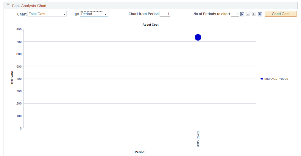

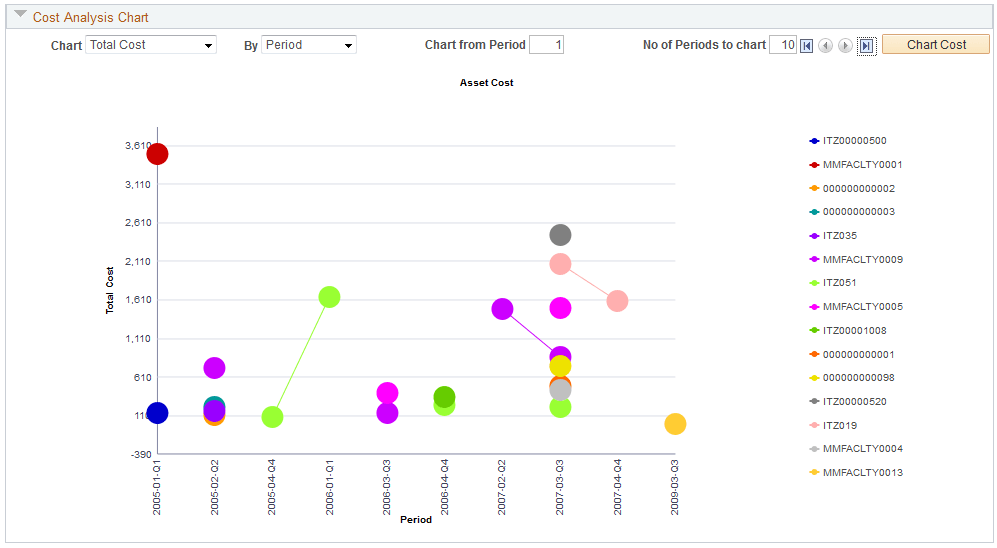

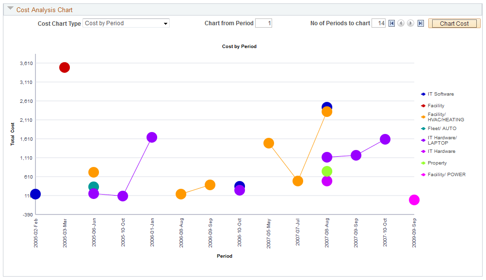

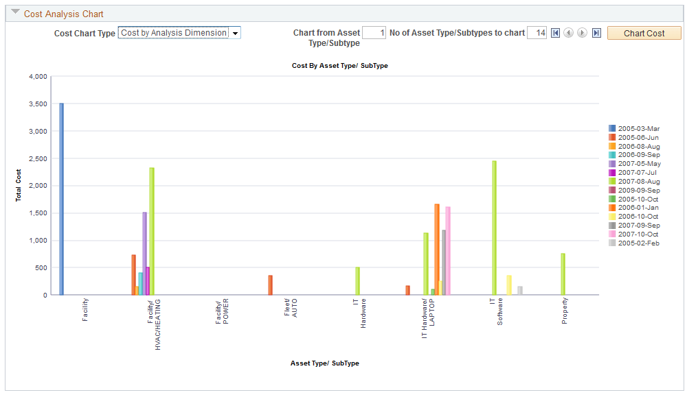

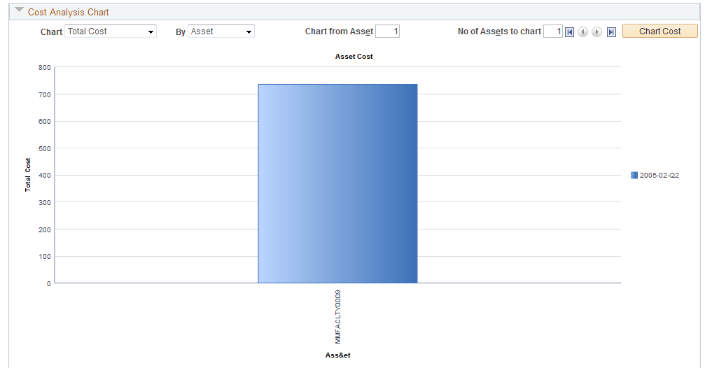

Cost Analysis Charts
Based on the data you choose to analyze, you can create charts to view these costs in a graphic format. These charts include:
  • Cost by Analysis Dimension chart
    This charts the asset maintenance costs for a specified number of specific categories that fall under the asset dimension that you select to display in the Asset Cost by Dimension grid. For example, if the dimension is asset type and subtype, you might want to display the maintenance costs of the asset types facility, hardware, and software on chart.
  • Total Cost by Period chart
    This charts the asset maintenance costs for each period for a specified number of periods. This data is based on the specified dimension data and the periods that appear in the Asset Cost by Dimension grid.
  • Estimated, Total, or Unit Cost by Asset chart.
    This charts either the estimated, total, or unit cost for a selected number of assets from the Asset Cost grid.
  • Estimated, Total Cost, or Unit Cost by Period chart.
    This charts the estimated, total, or unit cost for a selected number of periods for assets that appear in the Asset Cost grid.

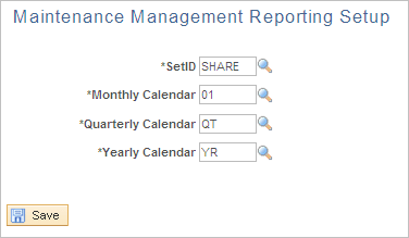

Maintenance Management Reporting Setup Page
Use the Maintenance Management Reporting Setup page (WM_REPORTING_SETUP) to specify the monthly, quarterly, and yearly summary calendars, which the system uses when it runs the Maintenance Cost Data Extraction Process.
Navigation:
Set Up Financials/Supply Chain, and then Product Related, and then Maintenance Management, and then Setup, and then MM Reporting Setup, and then Maintenance Management Reporting Setup
This example illustrates the fields and controls on the Maintenance Management Reporting Setup page. You can find definitions for the fields and controls later on this page.
Fiscal calendars are set up in the sample data and are usually set up when you set up all of your financial data.
Field or Control Description
SetID
Enter the SetID associated with the cost analysis data that you want to analyze.
Monthly Calendar
Select the monthly fiscal calendar to apply when running the Maintenance Cost Data Extraction process.
Quarterly Calendar
Select the quarterly fiscal calendar to apply when running the Maintenance Cost Data Extraction process.
Yearly Calendar
Select the yearly fiscal calendar to apply when running the Maintenance Cost Data Extraction process.

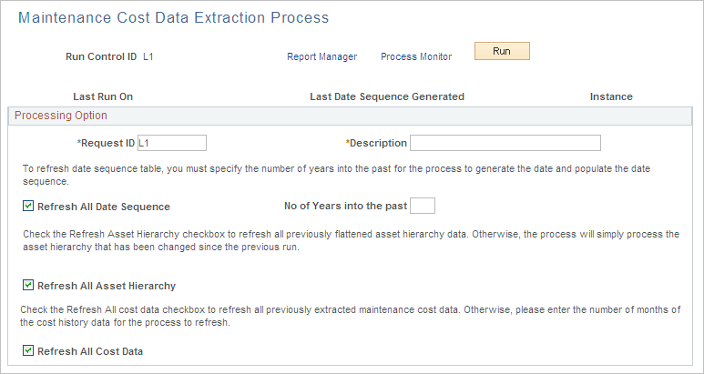

Maintenance Cost Data Extraction Process Page
Use the Maintenance Cost Data Extraction Process page (WM_COST_RUN_OPT) to extracts and summarizes all of the asset cost history data to use to perform an online asset cost maintenance analysis for work order and non-work order related assets the first time it is run.
Subsequent runs should extract only new cost history or recently updated cost history.
Navigation:
Maintenance Management, Work Order Management, Work Order Processing, Maintenance Cost Extraction
This example illustrates the fields and controls on the Maintenance Cost Data Extraction Process page. You can find definitions for the fields and controls later on this page.
Last Run On
Displays the date and time that this process was last run.
If this is the first run of this process, this field is blank.
Last Date Sequence Generated
Displays the date of the last date sequence that the system processed.
Instance
Displays a process instance number after you run this process. If a second process instance number appears to the right of the Last Date Sequence Generated field, this is the process instance generated for the run prior to this current process run. In other words, this process instance number appears if the process has been run before.
You can click the Process Monitor link to view the status of the process on the Process Server tab. You can also review the Server List and click the Details list to review the various details regarding each process instance.
Request ID
Enter this ID on the Extract Maintenance Cost - Add a New Value when you add a run control ID. You can change this ID on the Maintenance Cost Data Extraction page.
Description
Enter the description of the Request ID.
Refresh All Date Sequence
Select this check box to refresh the date sequence table.
No of years into the past (number of years into the past)
Enter the number of past years that you want to include in the date sequence refresh process.
Refresh All Asset Hierarchy
Select this check box to refresh all previously flattened asset hierarchy data. Otherwise, the system processes only the asset hierarchies that were changed since the previous run.
Refresh All Cost Data
Select this check box to refresh all previously extracted maintenance cost data, or leave this check box blank to display the No of Months of Cost Data check box.
No of Months of Cost Data (number of months of cost data)
Enter the number of months of cost that you want to refresh.
Run
Click this button to run the Maintenance Cost Data Extraction process (WM_ASSETCOST).

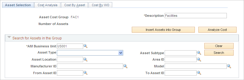

Asset Maintenance Cost Inquiry - Asset Selection Page
Navigation:
Maintenance Management, and then Inquiries and Reports, and then Asset Maintenance Cost Inquiry
This example illustrates the fields and controls on the Asset Maintenance Cost Inquiry - Asset Selection page (1 of 2). You can find definitions for the fields and controls later on this page.
This example illustrates the fields and controls on the Asset Maintenance Cost Inquiry - Asset Selection page (2 of 2). You can find definitions for the fields and controls later on this page.
To create an Asset Cost Group on the Asset Maintenance Cost Inquiry - Add a New Value tab by entering a name for the Asset Cost Group and clicking the Add button.
Asset Cost Group
The name of the Asset Cost Group that you created on the Add a New Value page appears in this field.
Description
Enter a description of this Asset Cost Group.
Number of Assets
This is the total number of assets in the group and is updated when you search for and select the assets that you want to include in this group, click the Insert Assets into Group button, and save the page.
Click this button to search for and select the assets that you want to include in this group.
The Asset Search page appears where you can select asset search criteria to narrow your search and click the Search button.
A list of assets appear in the Search Results grid.
You can also select the assets that you want to include in the asset cost group and click the Copy Selected Assets button.
Note: If an asset is associated with an asset component hierarchy, the Hierarchy icon displays in the Search results for the asset. You can click this icon to access the Asset Component Hierarchy page and view the asset hierarchy structure.
Note: You can add only three hundred assets to a group at a time due to the page restrictions.

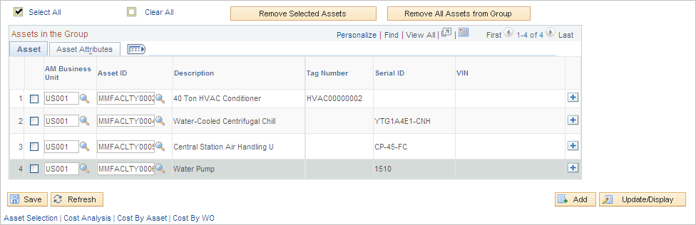

Search for Assets in the Group
Use this group box when you access an existing asset cost group and want to search for specific assets within this group. Select the asset criteria to narrow your search and click the Search button inside the group box. Only the assets within this asset cost group that meet your search criteria appear on the Assets Selected for Analysis grid.
Assets in the Group
Select the assets that you want to analyze in this grid before you click the Analyze Assets button.
Remove Selected Assets
Select the assets that you want to remove from the asset cost group from the Assets Selected for Analysis grid and click this button to remove those assets.
Remove All Assets from Group
Click this button to remove all of the assets in this asset cost group. A page appears asking if you are sure you want to remove all the assets in the group. If you select Yes, all of the assets in this asset cost group are removed.
Analyze Assets
Click this button to display the Maintenance Cost Analysis tab in order to perform the maintenance cost analysis.
See Asset Search Page (WM_ASSET_SRCH_SEC).

Use the Cost Analysis page (WM_COST_ANALYSIS) to search for the assets that you want to display and analyze on this page based on one or more specific dimensions.
Navigation:
Maintenance Management, Inquiries and Reports, Asset Maintenance Cost Inquiry, select the Cost Analysis tab.
This example illustrates the fields and controls on the Asset Cost Analysis Inquiry - Cost Analysis page (1 of 4). You can find definitions for the fields and controls later on this page.
This example illustrates the fields and controls on the Asset Cost Analysis Inquiry - Cost Summary grid - Cost Analysis page (2 of 4). You can find definitions for the fields and controls later on this page.
This example illustrates the fields and controls on the Asset Cost Analysis Inquiry - Cost Detail grid - Cost Analysis page (3 of 4). You can find definitions for the fields and controls later on this page.
This example illustrates the fields and controls on the Asset Cost Analysis Inquiry - Currency grid - Cost Analysis page (4 of 4). You can find definitions for the fields and controls later on this page.
Summarized By
Click the down arrow to display and select one of these options:
  • Area ID
  • Asset Type/Subtype
  • Location
  • Manufacturer/Model
  • Shop
    The system does not perform a unit cost analysis for a shop.
  • Work Order Type
    The system does not perform a unit cost analysis for a work order type.
And
  • Blank (none)
    Select the blank field and the system summarizes the data by the timeframe specified in the search criteria.
  • Accounting Period
    The system summarizes the data by fiscal accounting period.
  • Fiscal Quarter
    The system summarizes the data by fiscal quarter.
  • Fiscal Year
    The system summarizes the data by fiscal year.
Go
Click this button after selecting the previous two dimension values.
Any asset maintenance costs that fall under the selected criteria appear on the tabs in the Asset Cost by Specified Dimension group box.
Note: Use the Search Criteria group box described below to narrow your search criteria to expand the number of assets or just assets in the selected group before you select this button.
Search Criteria
Use this Search Criteria group box to narrow your search for all assets or just assets within this group to display in the Asset Cost by Specified Dimension group box.

Cost Summary
Click this tab to display a summary of the asset maintenance costs for assets associated with work orders and assets entered manually in PeopleSoft Asset Management. The grid fields are based on the dimensions that you specified at the top of the page. The system obtains the estimated costs from the Asset Maintenance History records. The Work Order Close (WM_CLOSE) process, which processes the scheduled costs, and manual entries in the PeopleSoft Asset Management Track Service and Repairs component update these Asset Maintenance History records. The system displays the following summarized information:
  • Period
    Displays the period based on your specifications in the summarization options and search criteria. If you do not select a value in the Summarized By And field, this column does not appear in the grid.
  • Estimated Asset Cost
    Displays the sum of all the resource estimated costs including labor, tools, materials, purchasing, and other costs for all of the assets included in the cost dimension and period. The costs for work order related assets are derived from the scheduled cost data of closed work orders, which are updated in the Asset Maintenance History records. The estimated costs for non-work order related assets is derived from the data entered in the Track Service and Repairs component in PeopleSoft Asset Management.
  • Estimated Component Cost
    Displays the sum of all the resource estimated costs including labor, tools, materials, purchasing, and other costs for all of the component assets included in the selected cost dimension and period.
    Note: Only parent assets can have component costs.
  • Total Estimated Cost
    Note: This is the sum of the Estimated Asset Cost and the Estimated Component Cost values.
  • Actual Asset Cost
    Displays the sum of all the resource actual asset costs including labor, tools, materials, purchasing, and other costs associated directly with the maintenance of the asset. If the assets within the specified summarization dimension are associated with a work order, the actual costs are derived after the work order is closed and the data is update in the Asset Maintenance History record. Non-work order actual costs are derived from values entered manually by users in the Track Service and Repairs component in PeopleSoft Asset Management.
  • Actual Component Cost
    Displays the sum of all the resource actual component costs including labor, tools, materials, purchasing, and other costs associated with the component assets.
  • Total Actual Cost
    Displays the sum of the Actual Asset Cost and the Actual Component Cost.
  • Variance Amount
    Displays the variance between the estimated and actual cost amounts.
  • Variance Percent
    Displays the percentage of variance between the estimated and actual cost amounts.
  • Unit Cost by Meter icon
    Click this icon to access the Asset Maintenance Cost by Meter Type page for a specific row. This page lists the Meter Types associated with assets in the selected dimension, and the Total Actual Costs, the Total Usage, the Cost per Unit of Usage, and the Currency for each meter type. The costs are based on the time frame selected in the Search Criteria of the Maintenance Cost Analysis page and the selected row.
  • View Cost by Asset icon.
    Click this icon to display and access the Maintenance Cost by Asset tab (page.)
Cost Detail
Select this tab to view a summary of the detail values based on the selected dimension and period. The fields on this tab are:
  • Estimated Labor Cost
  • Estimated Materials Cost
  • Estimated Purchase Cost
  • Estimated Tools Cost
  • Estimated Other Cost
  • Labor Cost
  • Materials Cost
  • Purchase Cost
  • Tools Cost
  • Other Cost

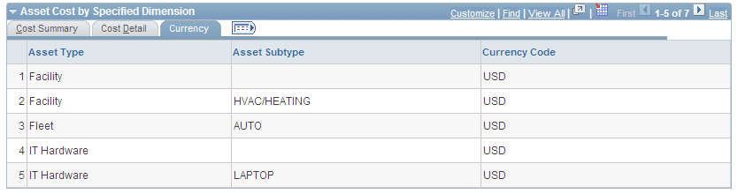

Currency
Select this tab to view the currency associated with these summarized asset maintenance costs. This is the base currency derived from the Asset Management business unit and the default book, such as CORP, associated with Asset Management business unit.
Charting Maintenance Costs by Specified Dimension or Period Data
Navigation:
Click the Cost Analysis Chart group box (click the down arrow) to select options that result in the display of various charts of the summary asset maintenance cost data.
This example illustrates the fields and controls on the Cost Analysis Chart by Period. You can find definitions for the fields and controls later on this page.
This example illustrates the fields and controls on the Cost Analysis Chart by Dimension. You can find definitions for the fields and controls later on this page.

Charting Cost by Period
Cost by Period
Select this option to create a chart based on the values selected for Summarize By fields and the Analysis Timeframe field. For example if you chose Asset Type/Subtype, Fiscal Quarter, and specified a period from 01/01/2008 to 12/31/2009 clicked the Chart Cost button,
After you select the Cost by Period option, the Chart From Period and No of Periods to Chart fields appear on the chart.
Do not enter any values in these two fields the first time you create a chart. Click the Chart Cost button. This will chart all data in the Asset Cost by Specific Dimension grid. The No of Periods to chart field will be updated with the total number of distinct periods in the grid.
The system displays the total costs per period for total number of periods included in the Asset Cost by Dimension data for each asset dimension. Each dimension is identified by a different color.
For example, you select:
  • Asset Type/Subtype for the Summarized By: field.
  • Fiscal Quarters for the And: field.
  • Specific Period for the Analysis Timeframe field.
  • 01/01/2000 for the Date From: field.
  • 01/01/2008 for the To: field
  • The Go button to run the Asset Cost Maintenance Analysis process.
    The resulting cost data appears on the Asset Cost by Specified Dimension grids with each dimension broken down by the specified period characteristics, or based on our example the cost of each Asset Type/Subtype dimension (12) per quarter over a period of seven years.
  • Select Cost by Period as the Chart Type.
  • Click the Chart Cost button.
    The chart displays the total cost by period for of each the dimensions.
    In the example the first chart created displays the total cost per quarter over a period of seven years for each of the 12 asset cost/subtypes dimensions. The twelve dimensions are represented by 12 different colors of lines defined on the chart.
    To narrow the amount of data that appears on the chart enter data in the Chart From Period and No of Periods to Chart fields.
Chart From Period
Enter the number of the period from which you want to start charting.
Based on our example, if you enter 1, the first period on the X axis of the chart will be Q1, 2000 for each of the asset type/subtypes.
No of Periods to Chart (number of periods to chart)
Enter the total number of periods that you want to appear on the X axis of the chart for each of the asset type/subtypes.
Based on our example, if you enter 12, the periods that display on the X axis of the chart will be:
  • Q1 2000
  • Q2 2000
  • Q3 2000
  • Q4 2000
  • Q1 2001
  • Q2 2001
  • Q3 2001
  • Q4 2001
  • Q1 2002
  • Q2 2002
  • Q3 2002
  • Q4 2002
This chart will display the total cost per period for the previous listed 12 periods, with each of the 12 dimensions represented by a different colored line.
Charting Cost Analysis by Dimension
Select this value from the Chart Type dropdown list.
When you select this option, the system will create a chart based on the data that appears on the Asset Cost by Specified Dimension grids after running the Asset Maintenance Cost process for one of the following dimensions:
Asset Type/Subtype
Manufacturer/Model
Location
Area ID
Shop
WO Type
After you select Cost Analysis by Dimension, the fields Chart From (cost dimension such as Asset Type/Subtype) and No of (cost dimension such as Asset Type/Subtypes appear.
The first time you create the chart, leave these fields blank and click the Chart Cost button.
Assume that you selected Asset Type/Subtypes as the cost dimension for the analysis. When you click the Chart Cost button, the system charts the Total Costs on the Y axis for each asset type/subtype on the X axis that were included in the data after you ran the Asset Cost Analysis process.
For example, after clicking the Chart Cost button for the asset type/subtype dimension, the chart displays the following asset type/subtypes on the X axis of the chart.
Facility
Facility/HVAC Heating
Fleet/Auto
Fleet/Truck
IT Hardware
IT Hardware/ Laptop
IT Software
Property
Property/Building
Equipment
Equipment/Network
Machinery
The amount of data in a chart containing a large number of asset type/subtypes may difficult to read. To narrow the number of asset type/subtypes that you want to appear on the chart and make it easier to read, you now enter numbers in the additional fields that appear on the chart.
Chart From (Cost Dimension)
Enter the number of the cost dimension from which to start charting.
The field name that displays is based on the cost dimension value that was selected for the analysis. For our example, the field name appears as Chart From Asset Type/Subtype
Enter the number of asset type/subtypes you want to chart from based on the total number that appeared on the first chart you created.
In the example twelve asset types/subtypes appeared on the first chart that was run. Now it is required to start the next chart from IT Hardware, which is the fifth asset type/subtype in the X axis of the original chart. Therefore, enter 5 in the Chart From Asset Type/Subtype field.
Note: The cost dimension (e.g. Asset Type/Subtype, Location, etc.) will be in alphabetical order on the X-Axis of the chart. This field indicates the Nth cost dimension from which the chart will start.
No of (Cost Dimensions) (number of cost dimensions)
Continuing with our example, this field name appears as No of Type/Subtypes.
Enter the number of asset type/subtypes that you want to view on the X axis of your chart based on the number you entered in the Chart From Asset Type/Subtype field.
Based on the example, assume that it is necessary to chart the total costs for the asset type/subtypes: IT Hardware, IT Hardware/Laptop, IT Software. Since 5 was entered in the previous field to start counting from, enter 3 in this field.
Click the Chart Cost button again, the chart displays the total costs for IT Hardware as the first value on the X axis, then the total costs for IT Hardware/Laptop as the next value on the X axis, and the total costs for IT Software as the final value on the X axis.
Note: If your data includes a large number of cost dimensions (for example, 30 asset type/subtypes), you can click the arrows to the left of the Chart Cost button to view all of the charted data.
Chart Cost
Click the Chart Cost button to display the chart based on the selected and entered criteria such as chart type, chart from period/dimension and more.
Note: Use the scroll arrows to the left of the Chart Cost button to view any additional Cost Dimensions or Periods depending on the selected chart type. For example, if you indicated that you wanted to chart the total costs of twelve asset type/subtypes, and only four asset types/subtypes appear on the first page of the chart, click the arrow to scroll through the remaining pages of the chart to view the total costs for the remaining eight asset type/subtypes.
Costs by Asset Page
Navigation:
Maintenance Management, and then Inquiries and Reports, and then Asset Maintenance Cost Inquiry, select the Cost by Asset tab; or drill down by clicking the View Cost by Asset icon for a selected dimension on the Cost Analysis tab.
This example illustrates the fields and controls on the Select Cost by Asset tab to display Cost By Asset page. You can find definitions for the fields and controls later on this page.
This example illustrates the fields and controls on the Select Asset Cost by Specified Dimension Row to access the Cost By Asset page. You can find definitions for the fields and controls later on this page.
Selecting the Cost By Asset Tab
When you select the Cost by Asset tab to access the Cost By Asset page, you can search for an view the costs of multiple assets either within the asset cost group, specify a subset of assets within the asset cost group, or include assets outside the group. Selecting this tab enables you manipulate the search criteria according to your specifications. or for all assets in the system. Setting up a subset of assets enables you can to perform a more detailed side-by-side analysis using the subsequent data and charting capabilities.
Selecting the View Costs by Asset Icon for a Row on the Cost Analysis Page
View
Click the View Cost by Asset icon for a row in the Asset Cost by Specified Dimension grid on the Cost by Analysis tab. The asset cost data for the selected row appears on the Cost by Asset page as display-only. You can not modify this information.
When you click the View Cost By Asset icon for a specific row in the Asset Cost by Dimension grid on the Cost Analysis page, the Cost By Asset page displays assets in the Asset Cost grid based on the criteria that you originally specified for that row on the Cost Analysis page. You cannot modify the search criteria on the Cost By Asset page. The only assets that appear in the Asset Cost grid are the assets that fall within the dimensions that you specified on the Cost Analysis search page. This presents a much narrower range of assets to analyze and chart.
For example, if you analyze the cost by asset type and subtype and select a row where the asset type and subtype is Fleet/AUTO and the period is April, 2003-04, when you click the Maintenance Cost by Asset icon to drill down to the asset level view, only assets and cost data belonging to the Fleet/AUTO asset type and subtype and fall within the cost for period April, 2003-04 appear on the Maintenance Cost by Asset page.
Reviewing the Cost by Asset Page
Whether you access the Cost By Asset page by selecting the Cost By Asset tab or clicking the View Cost by Asset icon, an Asset Cost grid appears on the page with these tabs.
Cost Summary
This tab displays the summarized estimated, total estimated, actual, total actual costs, along with the variance for each asset that displays in the grid. If you selected the Cost By Asset tab, these costs will be summarized based on the specification you selected on this page. If you selected the View Cost by Asset icon, these costs will be summarized based on the dimensions that you specified on the Cost Analysis page.
In addition, you can:
  • Click each asset's link in the grid to view the Asset Information page, which describes the basic information about the asset.
  • Click the View Cost by Maintenance Type icon for each asset's row and access the Asset Cost by Maintenance Type page. This page the displays Cost Summary, Cost Detail, Downtime, and Currency tabs for each maintenance type associated with the selected asset in the specified time frame.
  • Click the View Cost by Work Order icon for each asset's row to display the Cost By WO (work order) tab for the work order and work order tasks associated with the selected asset only.
    The Cost By WO tab displays a WO (work order) Task Cost grid lists each work order and work order task associated with the selected asset during the specified time frame. This gird displays the work order information related to the selected asset on Cost Summary, Cost Detail, Downtime, Currency, and Full Description tabs.
    You can click the Work Order ID link to view the specific work order and its tasks. You can also click the Asset Description link to access the Asset Information page, which contains a detailed description of the asset along with other asset information.
Cost by Unit of Usage tab
Click this tab to display the cost by unit of usage if the asset is associated with a meter. If the asset is associated with an meter, you can click the Unit Cost by Meter Type icon to display the Asset Cost by Meter Type page.
The Asset Cost by Meter Type page lists each type of meter associated with the specified asset based on the selected criteria and the total actual cost, total usage, unit of usage, and the cost per unit of usage for each meter.
Cost Detail tab
Click this tab to display the estimated and actual labor, materials, purchases, tools, and other costs associated with this asset.
Downtime tab
Click this tab to display the estimated and actual downtime entered for this asset based on the specified time frame.
Financial Details tab
Click this tab to display the replacement costs, net book value and insured value of each asset.
Currency tab
Click this tab to display the currency code that applies to each asset.

On the Cost By Asset page (tab), click the Cost Analysis Chart arrow.
Navigation:
  • Maintenance Management, Inquiries and Reports, Asset Maintenance Cost Inquiry, select the Maintenance Cost by Asset tab.
  • Click the Maintenance Cost by Asset icon for a selected row on the Maintenance Cost Analysis page for an asset.
This example illustrates the fields and controls on the Cost Analysis Chart - Total Cost by Period chart based on selection of the Cost by Asset tab. You can find definitions for the fields and controls later on this page.
This example illustrates the fields and controls on the Cost Analysis Chart - Total Cost by Asset chart based on selection of the Cost By Asset Tab. You can find definitions for the fields and controls later on this page.
This example illustrates the fields and controls on the Cost Analysis Chart - Total Cost by Period chart based on selection of View Cost by Asset icon. You can find definitions for the fields and controls later on this page.
This example illustrates the fields and controls on the Cost Analysis Chart - Total Cost by Asset chart based on selection of View Cost by Asset icon. You can find definitions for the fields and controls later on this page.
Chart
These field determine the Y axis of the chart. Select one of these values:
  • Est Cost (estimated cost)
    Displays the estimated costs for one or more assets depending on the number of assets listed in the Asset Cost grids based on your specifications in the Summarized By field and the Search Criteria on the Maintenance Cost by Asset page and running the Asset Maintenance Cost Analysis process.
  • Total Cost
    Displays the total costs for one or more assets depending on the number of assets listed in the Asset Cost grids based on your specifications in the Summarized By field and the Search Criteria on the Maintenance Cost by Asset page and running the Asset Maintenance Cost Analysis process.
  • Unit Cost
    Displays the unit cost for one or more assets depending on the number of assets listed in the Asset Cost grids based on your specifications in the Summarized By field and the Search Criteria on the Maintenance Cost by Asset page and running the Asset Maintenance Cost Analysis process.
By
These fields determine the X axis of the chart. Select one of these values.
  • Asset
    After selecting one of the values listed previously for the Chart: field, when you select this value and click the Chart Cost button, a chart displays either the estimated cost, total cost, or unit cost for each asset listed in the Asset Cost grids. The assets are all listed in alphabetical order on the X axis.
  • Period
    After selecting one of the values listed previously for the Chart: field, when you select this value and click the Chart Cost button, a chart displays either the estimated cost, total cost, or unit cost per period for each asset listed in the Asset Cost grids.
Charting Estimated, Total, or Unit Costs by Asset
If you selected estimated, total, or unit cost and asset as the values to chart by, you should click the Chart Cost button to display the costs for all of the assets listed in the Asset Cost grids. This helps you determine the value that you want to enter in these fields:
Chart from Asset
Enter the number of the asset from which you want to start charting the data.
For example, if ten assets appeared in the first chart that you ran and you wanted to view the chart starting with the 3rd asset, you enter a 3 in this field. The chart will display with the third asset appearing on the X axis in the first position.
No of Assets to chart
Enter the number of assets to chart.
For example, if ten assets appeared in the first chart that you ran and you only want to view 5 of them on the chart, then you enter 5 in this field. The chart will display five assets starting with the asset number you indicated in the Chart from Asset field. Based on our example, the chart will display the estimated, total, or unit costs (depending on your selection) for assets 3, 4, 5, 6, and 7.
Chart Cost
Click this button to display the charted asset cost data.
Charting Estimated, Total, or Unit Cost by Period
If you selected estimated, total, or unit cost and period as the values to chart by, you should click the Chart Cost button to display the costs for all periods listed for the assets in the Asset Cost grids. This helps you determine the value that you want to enter in these fields:
Chart from Period
Enter the period number from which you want to start charting the data.
For example, if you select Fiscal Year for the Summarized By field, Specified for the Timeframe Analysis field, 01/01/2000 for the Date From: field and 01/01/2008 for the To: field, when you run the Asset Maintenance Cost Analysis process (select the Go button), the system will display asset cost data for eight fiscal years for each asset in the Asset Cost grids.
  • Fiscal Year for the Summarized By field.
  • Specified for the Timeframe Analysis field.
  • 01/01/2008 for the To: field.
  • Click the Go button to run the Asset Maintenance Cost Analysis process.
    The system displays cost data for each asset for eight fiscal years.
If you enter 4 as the period to chart from, the 4th year (2003 — 2004) will appear as the first period on the X axis of the chart.
No of Periods to chart (number of periods chart)
Enter the number of periods to chart. This value will depend on the timeframe that you chose on the Maintenance Cost Analysis page.
Continuing with our example, if the data that appeared in Asset Cost grids was eight fiscal years, when you enter 4 into this field and click the Chart Cost button, the chart will display the fiscal years 2003, 2004, 2005, 2006, and 2007 on the X axis of the chart. The Y axis of the chart will be the Estimated Cost, Total Cost, or Unit Cost depending on the value you selected in the Chart: field. Each asset's line is color coded on the chart.
Chart Cost
Cost By WO (work order) Page
Use the Maintenance Cost by Work Order page (WM_COST_BY_WO3) to review any work order costs associated with the selected asset.
Navigation:
  • Maintenance Management, Inquiries and Reports, Asset Maintenance Cost Inquiry, select the Maintenance Cost by Work Order tab.
  • Click the View Cost by Work Order icon for a selected asset row.
This example illustrates the fields and controls on the Cost By Work Order page - tab selection. You can find definitions for the fields and controls later on this page.
This example illustrates the fields and controls on the Cost By Work Order page - View Cost by Work Order icon selection. You can find definitions for the fields and controls later on this page.
You can view work order and work order task information associated with one or more assets, depending how you access the page.
Selecting the Cost by Work Order Tab
Select the Maintenance Costs by Work Order tab to access the page. There may be times that you are only interested in viewing the work order costs associated with all assets within the specified group or based on all assets in the system based on specific search criteria. You indicate whether you want to consider assets in the group or all assets and enter the appropriate search criteria to display all work orders and non-workorder associated with assets that fall within your search criteria. The costs are derived from the asset maintenance history records, which are populated by either the Work Order Close process or by users, who enter the data manually in the Track Service and Repairs component in PeopleSoft Asset Management.
Clicking the View Cost by Work Order Icon to Access the Cost by Work Order Page
View View Cost by Work Order
Click this View Cost by Work Order icon in an asset's row on the Cost by Asset, Asset Cost, Cost Summary tab to display the Cost by WO (work order) page. When you access this page using the icon, the Search Criteria group box information is display-only. This information displays the specified dimensions and information that you selected on the Cost Analysis page.
WO Task Cost
This group box displays a list of the work order and non-work order costs associated with a selected asset. It contains these tabs:
  • Cost Summary tab.
    • Business Unit
      Displays the work order business unit.
      Note: If this is a non-work order asset cost, this field is blank.
    • Work Order ID (work order identification)
      Displays the work order ID associated with the asset. You can click this link to access the Requirements page of the work order.
    • Task No (task number)
      Displays the work order task number associated with the asset.
    • Date Closed
      Displays the date that the work order associated with this asset was closed. This information derived from the Asset Maintenance History records, which were updated when the work order was closed.
      The date that appears for non-work order related assets is derived from the maintenance date as entered in the Track Service and Repairs component of the PeopleSoft Asset Management.
    • Asset Description
      Click this link to access the Asset Information page, which describes the asset.
    • Component Asset
      Displays as selected if the asset associated with the work order or non-work order related asset is part of an asset hierarchy. If the check box is blank, the asset is not part of an asset hierarchy.
      Note: This check box will not appear in the regular mode. This appears only when you drill down from the Maintenance Cost by Asset page.
    • Maintenance Type, Work Type, Shop
      Displays these values which are associated with the work order and are required to create a work order.
      Displays the total estimated costs (labor, materials, purchase, and tool) derived from the Requirements page of the work order associated with the asset.
    • Total Actual Cost
      Displays the total actual work order costs after the work order is closed and the costs are updated in the Maintenance Cost History record in PeopleSoft Asset Management. Non-work order actual costs are derived from values entered by the user in the Track Service and Repairs component in PeopleSoft Asset Management.
    • Variance Amount, Variance Percent
      Displays the difference between the estimated and actual costs along and the estimated cost divided by the actual cost to determine the percentage of variance.
  • Cost Detail tab.
    Displays the estimated and actual labor, material, purchase, tool cost details associated with a work order task, along with the sum of these costs.
    Users enters this data in the Track Service and Repairs component in PeopleSoft Asset Management for non-work order related assets.
  • Downtime tab.
    Displays the estimated and actual time an asset was down for a work order. The system derives this data from the downtime that you enter for an asset in the work order, or from downtime entered by a user in the Track Service and Repairs component in PeopleSoft Asset Management.
  • Currency tab
    Lists the currency code associated with the asset in Asset Management for both work order and non-work order asset costs.
  • Full Description tab.
    Displays the complete description as it appears in the work order header and in each work order task.
Reviewing the Work Order Task Cost Grid
WO Task Cost
  • Cost Summary tab.
    • Business Unit
    • Date Closed
    • Asset Description
    • Component Asset
    • Total Actual Cost
  • Cost Detail tab.
  • Downtime tab.
  • Currency tab
