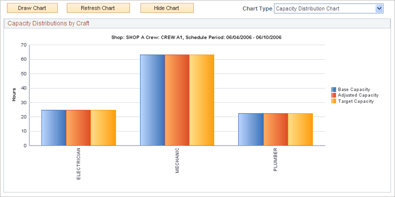

  • Base capacity
    Base capacity is the crew's calculated total available hours based on the crew resources' weekly shift hours and their capacity allocation percentages in that crew. A crew's total base capacity in hours is the sum of the base capacity calculation for each craft, which appears on the Crew Craft Capacity - Details tab of the Crew Capacity page.
    Base Capacity (hours) = Total hours in a crew member's assigned shift * Crew member's capacity %

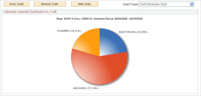

  • Adjusted capacity (hours, days, headcount)
    Adjusted capacity = Base capacity – All commitments (meetings and so on) on the resource's calendar.
    The system initially calculates the adjusted capacity for each craft in hours, days, and head count.
    The total adjusted capacity amounts that appear for the crew equal the sum of the craft values.
    Schedulers can adjust the values in adjusted capacity fields for each craft based on their knowledge of any external circumstances affecting each crew member. The system recalculates total adjustment values for the crew based on any changes to these values that the scheduler enters.
    The accuracy of these calculations depends on the timely management of a resources schedule, as well as the timeliness of the PeopleSoft Resource Management Availability Cache Record.
    The adjusted capacity takes holidays into account as long as the cache record is updated correctly based on the setup for scheduled holidays. For example, the adjusted capacity of the resource for the week of the July 4 holiday (07/02/06 through 07/08/06) will be 32 hours, assuming an 8-hour day, Monday through Friday shift. The adjusted capacity will consider 07/04/06 as a holiday, as long as the cache is updated.

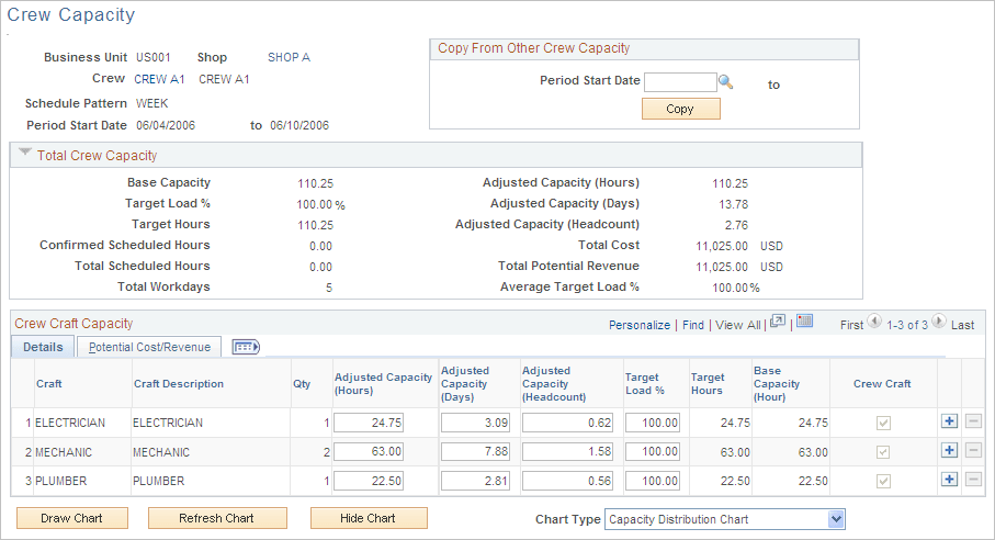

Crew Capacity Page
Use the Crew Capacity page (WM_CREW_CAPACITY) to define and update a crew capacity plan.
Navigation:
Maintenance Management, and then Crew Schedule, and then Crew Capacity Plan
This example illustrates the fields and controls on the Crew Capacity page. You can find definitions for the fields and controls later on this page.
Crew Capacity page
To create a crew capacity plan, select a work order business unit, shop, crew, and a period start date on the Add a New Value page.

Total Crew Capacity
Field or Control Description
Base Capacity
Displays the total resource base capacity for the crew, which is derived from the hours in each resource's shift times the total capacity percentage of each resource assigned to this crew on the Define Crew page.
Note: If the crew resources are associated with different shifts, the system calculates this value based on the different shifts.
Adjusted Capacity (Hours)
Displays the total adjusted capacity in hours for the entire crew.
Total Adjusted Capacity = (Base capacity – All commitments) * Capacity allocation percentage of the each resource in the crew.
This value cannot be negative. If a negative value is calculated, the system enters zero as the value.
Schedulers can modify this value manually for each craft based on their knowledge of the technician's working hours for the period. Modify this value on the Details tab.
Note: The accuracy of this calculation depends on the calendar entries of the resources for the specified schedule period and the currency of the resource management availability cache record.
Target Load % (target load percentage [total crew])
Displays total target load percentage value for the crew (calculated at the crew level) = Total target hours / Total adjusted capacity hours
Total load % = Total target hours / Total adjusted capacity hours.
Adjusted Capacity (Days)
Displays the total adjusted capacity in days for the crew.
Total adjusted capacity days = Total adjusted capacity hours / standard hours per workday defined on the Shop Definition page.
Target Hours
Displays the total target available hours for the crew for the schedule period.
Total target hours for the crew = Total target load percentage * Total adjusted capacity hours.
Note: This value is used to schedule a crew.
Adjusted Capacity (Headcount)
Displays the total adjusted capacity in headcount for the crew.
Total adjusted capacity headcount for the crew = Total adjusted capacity days / Total workdays in the schedule period.
Note: The total workdays for a schedule period is based on the operating hours of the crew shop.
Confirmed Scheduled Hours
Displays the total confirmed number of hours scheduled for the crew on the Crew Scheduling Workbench, which means that the Confirm Metrics action was performed against the crew schedules.
Total Cost
Displays the total cost for the crew.
Total cost for the crew = Sum of the hourly cost rate for each craft * Total adjusted capacity hours for each craft
Total Scheduled Hours
Displays the total number of scheduled hours of all of the crafts listed for the crew. This value is updated when you assign a work order task requirement to a crew for the schedule period on the Crew Scheduling Workbench, or when you change the period on the Crew Scheduling Workbench and save the page.
Total Potential Revenue
Displays a value, which is derived by multiplying the hourly bill rate for each craft times the adjusted capacity (hours) for each craft. This value equals the potential revenue for each craft. Add these figures together to obtain the total potential revenue for the crew.
Total Workdays
Displays total number of workdays, which is derived from the total number of workdays in the shift associated with the shop based on the schedule period.
For example:
If the schedule period is biweekly and the shift associated with the shop is 8 hours per day, 5 days per week, then the total workdays for this crew is 10.
Average Target Load % (average target load percentage)
Displays a weighted average of the target load percentage.
Average Target Load % = SUM (Number of resources in each craft) * Target Load % of the craft) / Total number of resources in the crew capacity plan

Crew Capacity Page
Navigation:
This example illustrates the fields and controls on the Crew Capacity page (1 of 2). You can find definitions for the fields and controls later on this page.
This example illustrates the fields and controls on the Crew Capacity page (2 of 2). You can find definitions for the fields and controls later on this page.

Chart Type
Select the type of chart that you want to appear. Chart types are:
  • Capacity Distribution Chart
    This bar chart compares the base capacity, adjusted capacity, and target capacity hours for each craft in the crew for the specified schedule period.
  • Craft Distribution Chart
    This pie chart displays the adjusted capacity distribution percentages for each craft in the crew capacity plan.
