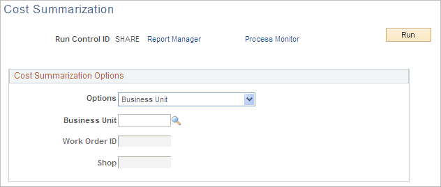

Cost Summarization Page
Use the Cost Summarization page (WM_SUMCOST_RUN) to run the Cost Summarization process (WM_SUMMCOST) to update total actual costs generated in PeopleSoft Project Costing in the Cost page of the work order.
Navigation:
Maintenance Management, Work Order Management, Work Order Processing, Cost Summarization
This example illustrates the fields and controls on the Cost Summarization page. You can find definitions for the fields and controls later on this page.

Field or Control Description
Options
Select one of these options:
  • All to summarize costs for all work orders and all shops associated with all business units.
  • Business Unit to enable the Business Unit field, where you can select the work order business unit associated with the work orders for which you want to summarize costs.
  • Shop to enable the Shop field, where you can select the shop associated with the work order for which you want to summarize the costs.
  • Work Orderto enable the Work Order ID field, where you can select the specific work order for which you want to summarize the costs.
Run
Click this button to run the WM_SUMMCOST process.

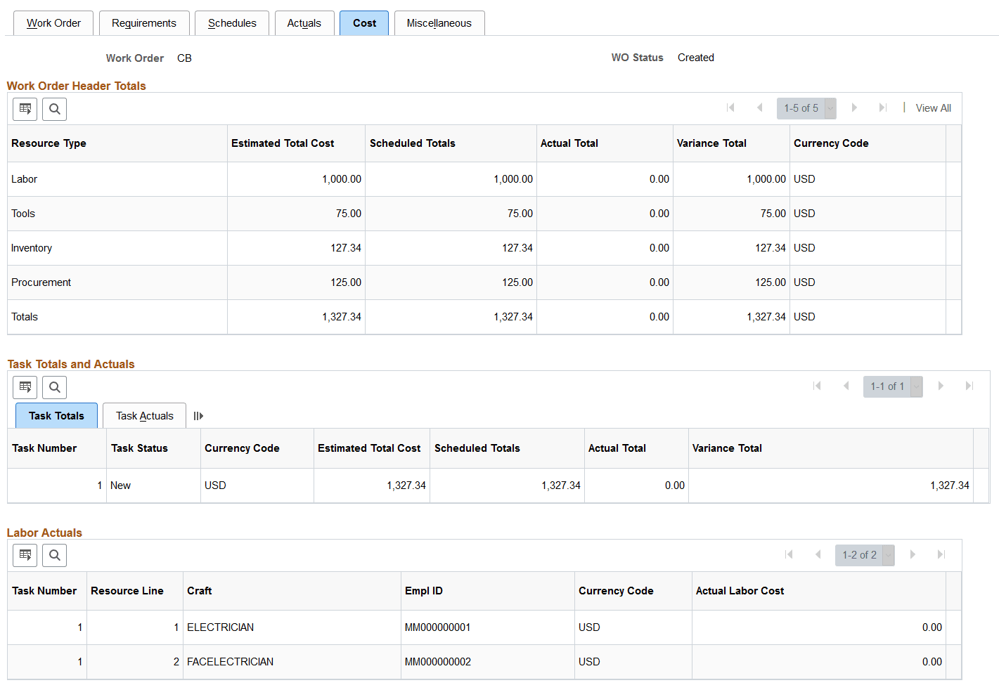

Work Order - Cost Page
Use the Work Order - Cost page (WM_WO_COST) to review the total estimated, scheduled, and actual costs in a work order.
Navigation:
Select Maintenance Management, Work Order Management, Work Order, and click the Cost tab.
This example illustrates the fields and controls on the Work Order - Cost page. You can find definitions for the fields and controls later on this page.
Work Order - Cost page (1 of 2)
Work Order - Cost page (2 of 2)
Work Order Header Totals
Estimated Total Costs
Displays a value if you calculated estimated costs for each resource row for each task in the Requirements page. This value is updated when you save the work order requirements.

Actual Total
Displays a value when you enter the time, material, and tool usage amounts in the Technician Workbench. When you run the Cost Summarization process, the total costs are collected in PeopleSoft Project Costing, and they appear in these fields.
Task Totals and Actuals
This grid displays the total estimated and scheduled costs for each work order task when you enter the resources lines and save the requirements for estimated costs and the schedules for scheduled costs. The total actual costs for each task are derived from PeopleSoft Project Costing when you run the Cost Summarization process and the variance is calculated. The system calculates a variance between the estimated costs and the actual costs.
Labor Actuals
This grid displays the total actual labor costs for each employee assigned to a work order task line. These costs appear based on running the Cost Summarization process. The Cost Summarization process is automatically run when a work order is closed.

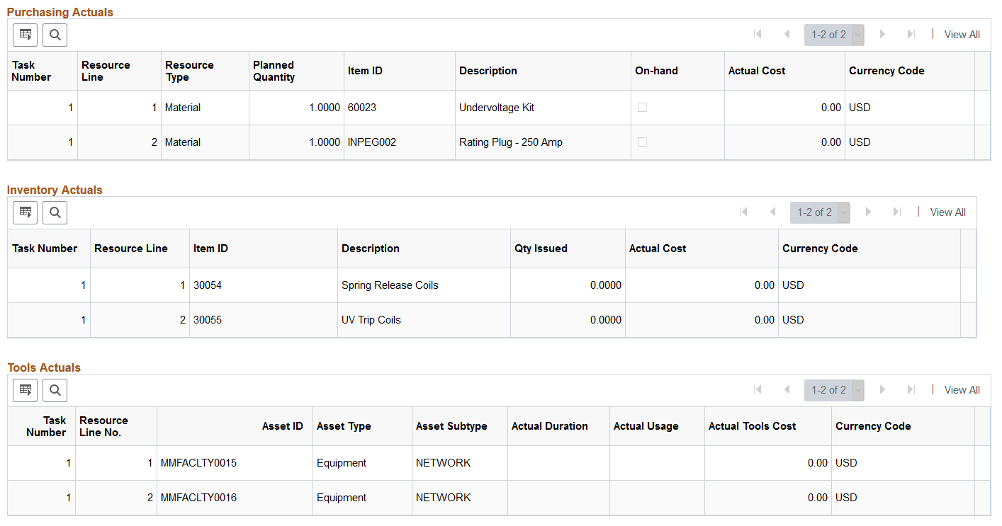

Material Actuals
This grid displays the total actual inventory costs for each work order task line. These costs appear based on running the Cost Summarization process. The Cost Summarization process is automatically run when a work order is closed.
Purchasing Actuals
This grid displays the total actual purchasing costs for each work order task line. These costs appear based on running the Cost Summarization process. The Cost Summarization process is automatically run when a work order is closed. In addition, the On-Hand column identifies the non-inventory items already available for completing work order tasks.
Tools Actuals
This grid displays the total actual tool costs for each work order task line. These costs appear based on running the Cost Summarization process. The Cost Summarization process is automatically run when a work order is closed.
