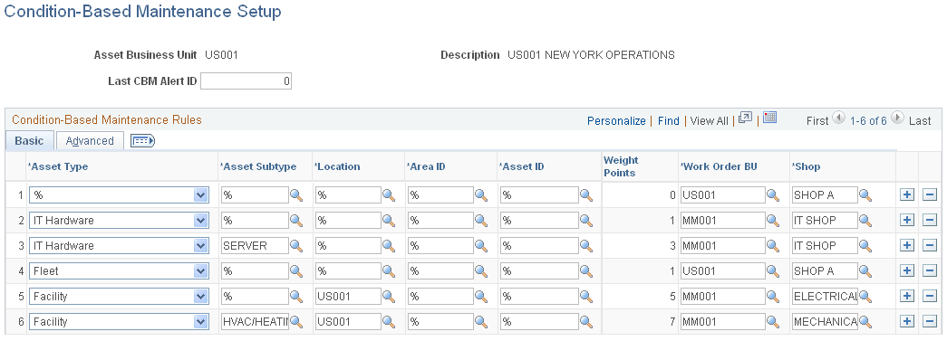

This example illustrates the fields and controls on the Condition-based Maintenance Rules - Basic. You can find definitions for the fields and controls later on this page.

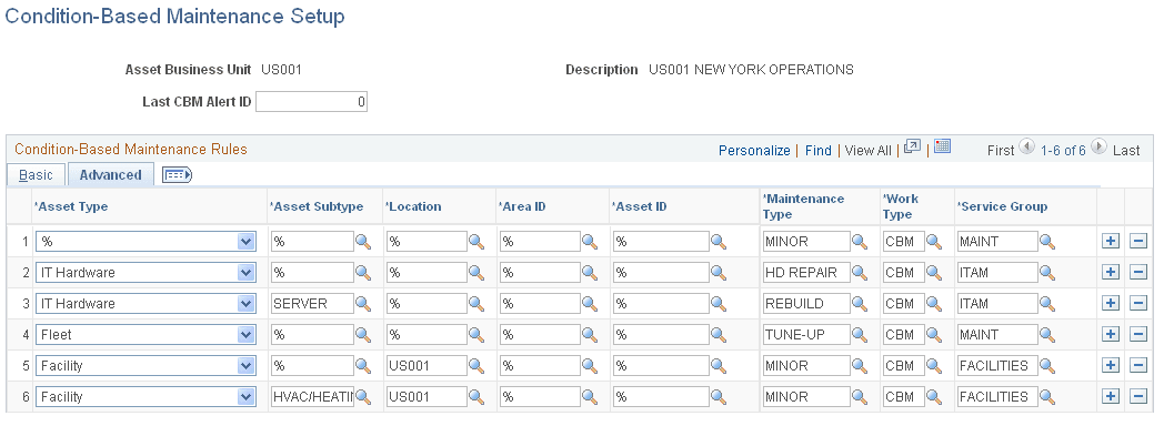

This example illustrates the fields and controls on the Condition-Based Maintenance Rules - Advanced. You can find definitions for the fields and controls later on this page.
Define the CBM rules and last alert ID for the Asset Management Business Unit.
Field or Control Description
Last CBM Alert ID
Enter a number. The system uses the number to generate sequential alert IDs starting with the number following your entry.
Asset Type
Select a wildcard (%) to represent all asset types or select a specific asset type from your list.
Asset Subtype
Select a wildcard (%) to represent all asset subtypes or select a specific asset subtype from your list.
Location
Select a wildcard (%) to represent all asset locations or select a specific asset location from your list.
Area ID
Select a wildcard (%) to represent all area IDs or select a specific area ID from your list.
Asset ID
Select a wildcard (%) to represent all asset IDs or select a specific asset ID from your list.
Weight Points
Displays the total weight for the selected values for each row. The values are Asset Type (1), Asset Subtype (2), Asset Location (4), Asset Area (8), and Asset ID (16). Wildcards = 0.
Business Unit
Select the work order business unit to serve as the default value in the work order for the selected row.
You must specify a default value and cannot use a wildcard in the fields for the Business Unit, Shop, Maintenance Type, Work Type, and Service Group.
Shop
Select the shop to serve as the default value in the work order for the selected row.
Maintenance Type
Select the maintenance type to serve as the default value in the PM schedule for the selected row.
Work Type
Select the work (order) type to serve as the default value in the work order for the selected row.
Service Group
Select the service group to serve as the default value in the work order for the selected row.
