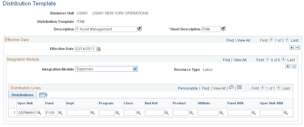

Distribution Template Page
Use the Distribution Template page (WM_DIST_TMPL) to define default ChartField values for Inventory, PeopleSoft Purchasing/PeopleSoft Payables, Expenses (labor only), and PeopleSoft Project Costing (tools) by work order business unit for actual transactions that are initiated via a work order.
Navigation:
Set Up Financials/Supply Chain, and then Product Related, and then Maintenance Management, and then Accounting Defaults, and then MM Distribution Template
This example illustrates the fields and controls on the Distribution Template page. You can find definitions for the fields and controls later on this page.
Integration Module
Set up a template for each product (PeopleSoft Inventory, Payables/PeopleSoft Purchasing, and PeopleSoft Expenses), as well as a template for tools using the PeopleSoft Project Costing Integration Module.
Field or Control Description
Integration Module
Select either:
  • Inventory.
  • Payables/ Purchasing.
  • Expenses.
  • Project Costing, which is used for tools.
Resource Type
Select either Labor, Material, or Tools for the resource type.
Note: You can only select a Resource Type field when the Integration Module selected is Payables/Purchasing. For all other integration modules, this field is read-only.
Distribute By
Select to distribute to the distribution rows by Amount or Quantity.
Note: This field only displays if the integration module is Purchasing/Payables.
  • Typically, you enter a purchase order or requisition for labor by Amount and for materials by Quantity.
  • You enter inventory materials that are being purchased by Quantity.
  • You enter non-inventory materials that are being purchased by Quantity or Amount.
Distribution Type
Select an Inventory distribution type to associate with this Inventory transaction group.
Note: This field only displays if the integration module is PeopleSoft Inventory and is optional.
Distribution Lines
Configure the distribution lines for each integration module based on these rules:
  • For PeopleSoft Inventory:
    • Users can configure only one distribution line.
    • The PeopleSoft Inventory transaction group associated with the ChartField distribution is not shown on the page because PeopleSoft Inventory uses transaction group 231 exclusively for Maintenance Management. This is the default value for all PeopleSoft Inventory transactions related to PeopleSoft Maintenance Management.
    • Users cannot blank out the default fields that were set up in the PeopleSoft Inventory Accounting Rules Template.
  • For Payables/Purchasing:
    Users can enter multiple distribution lines and specify the percentage of costs or quantity to allocate to each row. Your choice of Quantity or Amount determines the default values that appear in the PeopleSoft Purchasing schedule row of the work order task. You can modify these values prior to staging the purchase order or requisition schedule row.

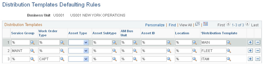

Distribution Templates Defaulting Rules Page
Use the Distribution Templates Defaulting Rules page (WM_DIST_TMPL_BY_BU) to enables users to associate distribution templates with a combination of criteria, such as service group, work order type, asset location, asset type, and more.
Navigation:
Set Up Financials/Supply Chain, and then Product Related, and then Maintenance Management, and then Accounting Defaults, and then MM Distribution Template Rules
This example illustrates the fields and controls on the Distribution Templates Defaulting Rules page. You can find definitions for the fields and controls later on this page.
You can add multiple rows containing different values.
Business Unit
Select a work order business unit for which you want to define these rules.
Note: The work order business unit that you select contains the accounting default order that applies to these rules.
Service Group
Select a service group value or enter a % (wildcard) to represent all service group values.
Work Order Types
Select a work order type value or enter a % (wildcard) to represent all work order type values.
Asset Type
Select an asset type value or leave it blank to represent all asset type values.
Asset Subtype
Select an asset subtype value or enter a % (wildcard) to represent all asset subtype values.
AM Bus Unit (Asset Management business unit)
Select an AM business unit value or enter a % (wildcard) to represent all AM business unit values.
Asset ID
Select an asset ID value or enter a % (wildcard) to represent all asset ID values.
Location
Select an asset location value or enter a % (wildcard) to represent all asset location values.
Select the distribution template that you want to associate with the previously selected values.
Note: When you enter multiple rows of values, the system weights each value. The row with the highest value determines the default ChartField distribution template that displays in the work order. For a given work order, only the values in the templates that match the values in the work order or have a wildcard in the field are selected as the default ChartFields for the templates in the work order. For example, if a work order is created with a work order type of CAPT, and there are three defaulting distribution rules that contain respectively: (1) WO Type = CAPT; (2) WO Type = CM; (3) WO Type = %, then the only default rules that will apply to the distribution templates in the work order are (1) and (3).
