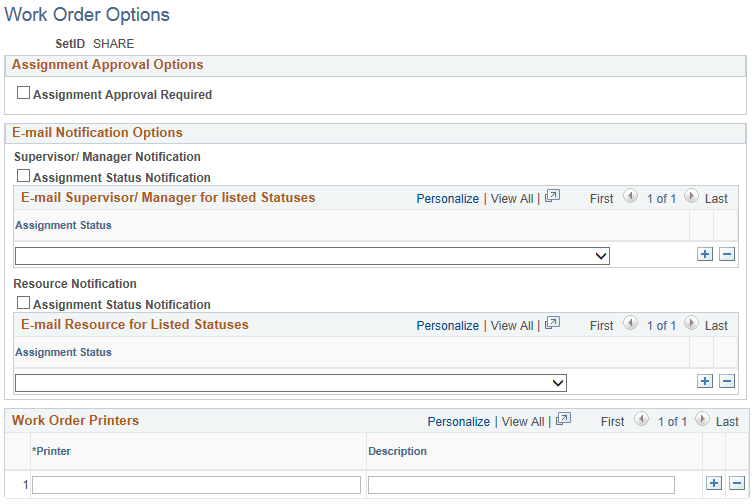

Work Order Options Page
Use the Work Order Options page (WM_BUS_UNIT_OPT) to define e-mail options for resource assignment approval.
Navigation:
Set Up Financials/Supply Chain, and then Business Unit Related, and then Maintenance Management, and then Work Order Options
This example illustrates the fields and controls on the Work Order Options page.
