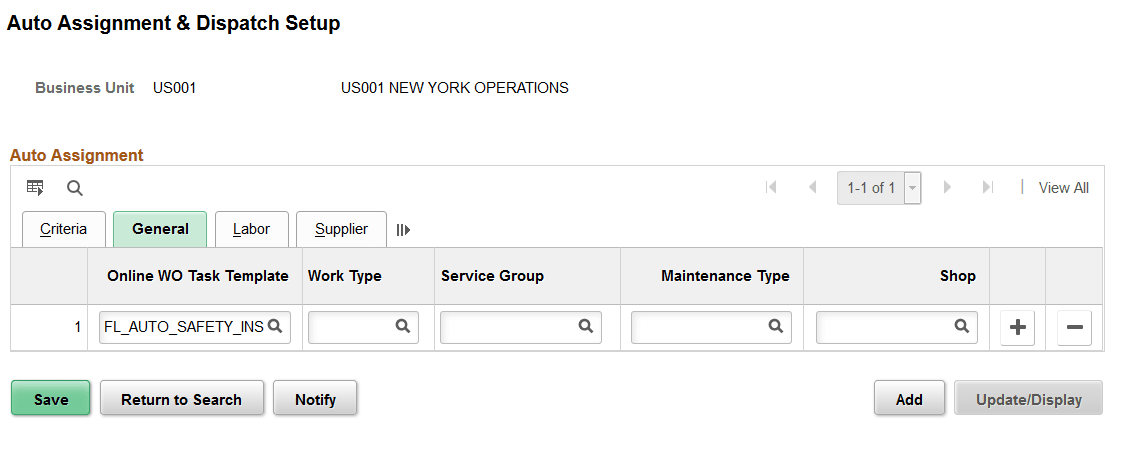

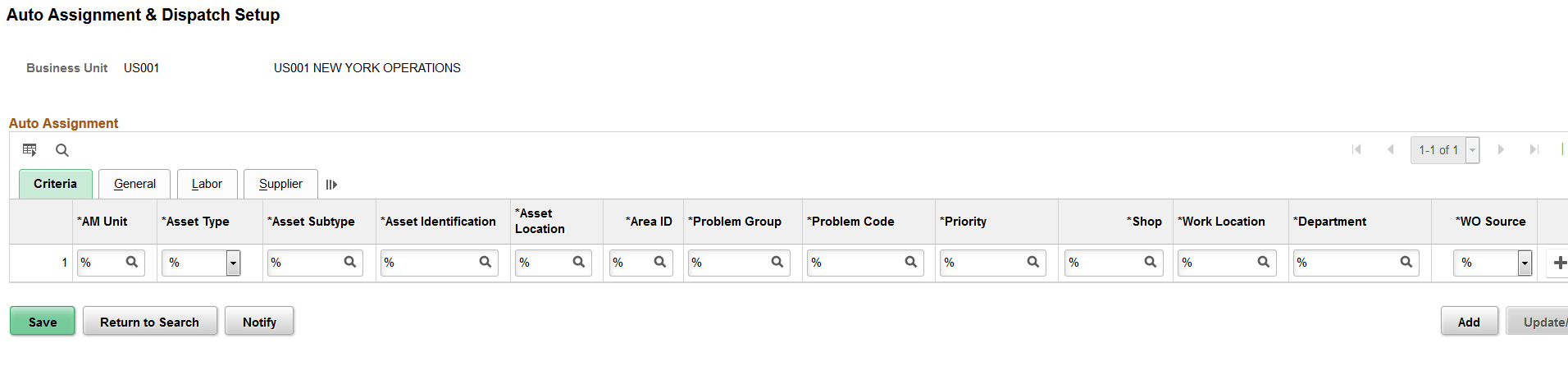

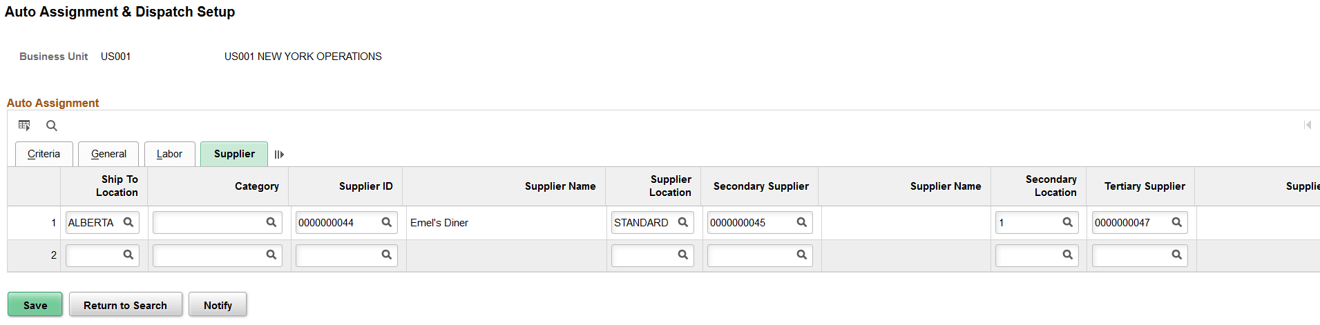

Auto Assignment & Dispatch Setup Page
WM_AUTOASSIG_SETUP
Define criteria and setup parameters to automatically assign labor and supplier for a Work Order.

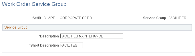

Work Order Service Group Page
Use the Work Order Service Group page (WM_SRVC_GRP) to identifies specific behaviors in a work order.
Navigation:
Set Up Financials/Supply Chain, and then Product Related, and then Maintenance Management, and then Setup, and then MM Service Group
This example illustrates the fields and controls on the Work Order Service Group page. You can find definitions for the fields and controls later on this page.
Field or Control Description
Service Group
Enter and describe each type of service group, such as IT and Facilities, to use for defining specific work order behaviors.
See Understanding Work Order Business Unit Setup.

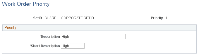

Work Order Priority Page
Use the Work Order Priority page (WM_PRIORITY) to indicates the urgency for completing a specific work order.
Navigation:
Set Up Financials/Supply Chain, and then Product Related, and then Maintenance Management, and then Setup, and then MM Work Order Priority
This example illustrates the fields and controls on the Work Order Priority page. You can find definitions for the fields and controls later on this page.
Priority Code
Enter a level of priority such as High, Medium or Low or whatever values are meaningful to your organization. When you create a work order, you select its level of priority in relation to other work orders.

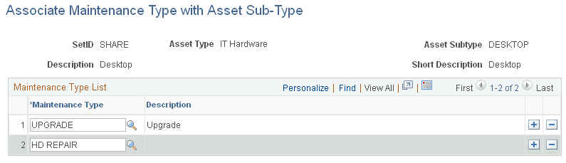

Associate Maintenance Type With Asset Subtype Page
Use the Associate Maintenance Type with Asset Subtype page (WM_MAINT_TYPE) to defines the category of maintenance needed for a selected asset type and subtype.
Navigation:
Set Up Financials/Supply Chain, and then Product Related, and then Maintenance Management, and then Setup, and then MM Maintenance Type, and then Associate Maintenance Type with Asset Subtype
This example illustrates the fields and controls on the Associated Maintenance Type with Asset Subtype page. You can find definitions for the fields and controls later on this page.
SetID and Asset Type and Asset Subtype and Description and Short Description
Access the Maintenance Type component, enter the SetID and select the Asset Type and Subtype.
Maintenance Type
Add one or more rows of maintenance types to associate with the selected Asset Type and Asset Subtype.

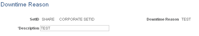

Downtime Reason Page
Use the Downtime Reason page (WM_DWNTIME_RSN) to describes the reason that an asset is not available for use.
Navigation:
Set Up Financials/Supply Chain, Product Related, Maintenance Management, Setup, Downtime Reason
This example illustrates the fields and controls on the Downtime Reason page. You can find definitions for the fields and controls later on this page.
Downtime Reason
Enter the abbreviated reason that an asset is unavailable for use.
Description
Provide a longer description of the reason for the asset downtime.

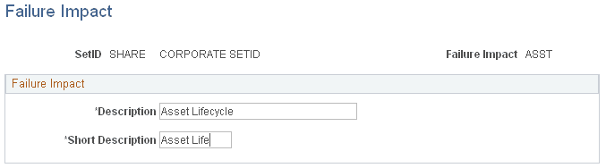

Failure Impact Page
Use the Failure Impact page (WM_FAILURE_IMPACT) to identifies how the failure of an asset will affect specific organization circumstances or requirements such as hazardous conditions or materials, health issues, safety issues, and more.
Navigation:
Set Up Finanicals/Supply Chain, Product Related, Maintenance Management, Setup, Failure Impact, Failure Impact
This example illustrates the fields and controls on the Failure Impact page. You can find definitions for the fields and controls later on this page.
Failure Impact page
SetID and Failure Impact
Select a SetID and enter an identifiable code to define a circumstance or requirement that can be impacted by a failure event on the Failure Impact Codes - Add a New Value page such as ASST to represent Asset Life Cycle.
Enter a long and a short meaningful description of the entered failure impact code such as Asset Life Cycle impact. If you choose to define a failure impact code, these are both required fields.

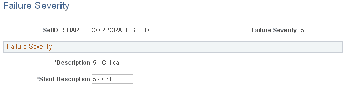

Failure Severity Page
Use the Failure Severity page (WM_FAILURE_SEVRTY) to describes the seriousness of the asset failure to an organization and is required in order to track failure events.
Navigation:
Set Up Finanicals/Supply Chain, Product Related, Maintenance Management, Setup, Failure Severity, Failure Severity
This example illustrates the fields and controls on the Failure Severity page. You can find definitions for the fields and controls later on this page.
SetID and Failure Severity
Select a SetID and enter a code up to five characters that best represents a level of the severity on an asset failure to your organization on the Add a New Value page. For example 1, 2, 3.
Enter a meaningful long and short description of this failure severity code such as Critical, High, Medium or a definition of a numerical failure severity code, if you used numbers to define these codes. These are both required fields.

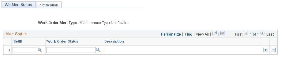

Work Order Alert Page
Use the Work Order Alert page (WM_WO_ALERT_STS) to configure work order alert setup, such as the list of statuses of the WO for the alert and the group of people that are interested in the alert notification.
Navigation:
Set Up Financials/Supply Chain, and then Product Related, and then Maintenance Management, and then Setup, and then MM Work Order Alert, and then Work Order Alert
This example illustrates the fields and controls on the Work Order Alert page: WO Alert Status tab. You can find definitions for the fields and controls later on this page.

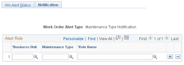

This example illustrates the fields and controls on the Work Order Alert page: Alert Notification tab. You can find definitions for the fields and controls later on this page.
WO Alert Type
Select the work order alert type from the following options:
  • Actual Cost Notification
    Total Actual Work Order Task Cost exceeds Total Scheduled Work Order Task Cost for a Work Order.
  • Labor Hours Notification
    Total Actual Labor Hours exceeds Total Scheduled Labor Hours for a Work Order.
  • Maintenance Type Notification
    A Work Order is created for a particular Maintenance Type Alert.
  • Priority Notification
    User configurable WO Priority/Asset Criticality Alert.
  • Problem Notification
    User configurable Problem Type Alert.
  • Warranty Notification
    Asset under Warranty is placed on a Work Order Task Alert.
  • Work Order Type Notification
    User configurable Work Order Type Alert.
SetID
Select the desired ID to set the work order alert status.
Work Order Status
Select the desired work order status. If WO Status is present, it means the WO Alert type = Maintenance Type. For the other alert types you see the WO task status.
Role Name
View list of users that are interested in receiving the e-mail notification.
Maintenance Type
Select the desired type of maintenance. This selection is only available when alert type is Maintenance type.
Business unit
Select the desired business unit for the required work order alert's notification. This is the business unit in the work order which the user is an interested party.

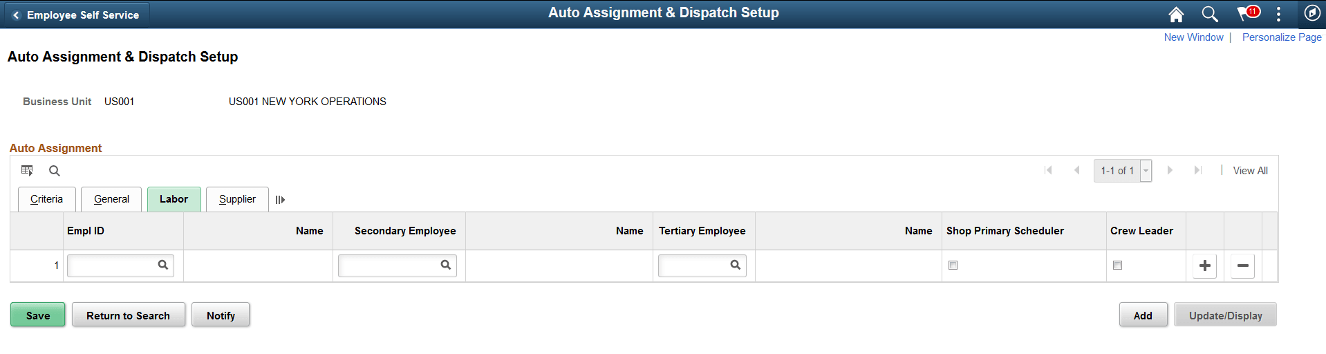

Use the Auto Assignment & Dispatch Setup page (WM_AUTOASSIG_SETUP) to define criteria and setup parameters to automatically assign labor and supplier for a new Work Order.

Auto Assignment & Dispatch Setup - Criteria page
Auto Assignment — Criteria
Define values for the given parameters such as AM Unit, Asset Type, Area ID, Priority, and Shop to find employee/supplier matching the criteria to auto assign employee/supplier for the Work Order created. You can use % instead of specific value for the given criteria.
The WO Source field lists the different source options such as Preventive Maintenance, Work Order component, and Service Request that you can use for creating a work order. If you want to create an auto assignment criteria for a particular work order, you need to select the specific work order source.
Based on the criteria setup information system will get the best matched resources for the Work Order created.
Auto Assignment — General
This example illustrates the fields and controls on the Auto Assignment & Dispatch Setup - General page. You can find definitions for the fields and controls later on this page.
Online WO Task Template
Select the default Work Order task template that will be used to automatically populate the task requirements based on the criteria defined. This field is applicable only for Work Order created online.
Work Type
Select appropriate Work Type. This field is applicable only for those Work Orders that are created through a component interface.
Service Group
Select appropriate Service Group. This field is applicable only for those Work Orders that are created through a component interface.
Maintenance Type
Select appropriate Maintenance Type. This field is applicable only for those Work Orders that are created through a component interface.
Shop
Select appropriate value for Shop. This field is applicable only for those Work Orders that are created through a component interface.
Auto Assignment — Labor
This example illustrates the fields and controls on the Auto Assignment & Dispatch Setup - Labor page. You can find definitions for the fields and controls later on this page.
Empl ID
Select employee ID for the system to automatically assign Work Order based on the criteria defined.
Secondary Employee
Select required employee to assign the Work Order. You can select secondary employee if the selected primary Employee ID is not valid.
Tertiary Employee
Select required employee to assign the Work Order. You can select tertiary employee if the selected primary Employee ID is not valid.
Shop Primary Scheduler
Select the Shop Primary Scheduler check box to automatically assign the work order to the primary shop scheduler defined on the Define Shop - Resources page. When you create a new work order, the Work Order- Schedules page automatically displays the shop scheduler’s details, who is the primary scheduler.
If you select this check box, all other fields become disabled.
Crew Leader
Select the Crew Leader check box to automatically assign the work order to the crew leader defined for the shop on the Define Crew page. When you create a new work order, the Work Order- Schedules page automatically displays the crew leader’s details.
Auto Assignment — Supplier
This example illustrates the fields and controls on the Auto Assignment & Dispatch Setup - Supplier page. You can find definitions for the fields and controls later on this page.
Supplier ID
Select Supplier ID for the system to automatically assign and dispatch Work Orders based on the criteria defined.
Secondary Supplier
Select required supplier to assign and dispatch the Work Order. You can select secondary supplier if the selected primary Supplier ID is not valid.
Tertiary Supplier
Select required supplier to assign and dispatch the Work Order. You can select tertiary supplier if the selected primary Supplier ID is not valid.
Ship To Location
Select the Ship To Location to automatically dispatch the Work Order.
Supplier Location
Select the Supplier Location to automatically dispatch the Work Order.
Category
Select required Category. This value will be considered only if item ID is not specified for the Work Order.
