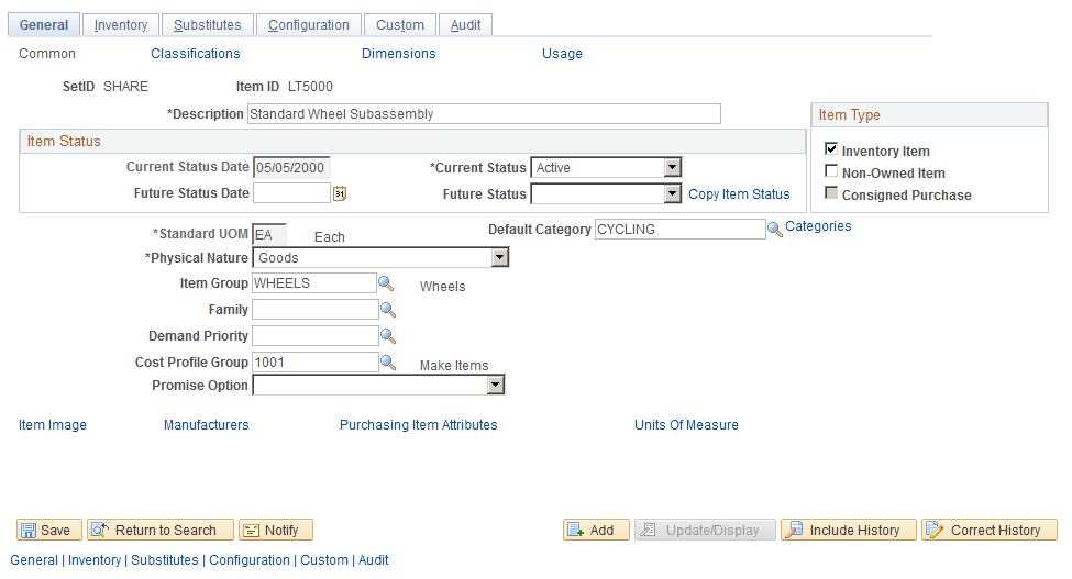

Define Item - General: Common Page
Use the Define Item - General: Common page (INV_ITEMS_DEFIN1) to define or change general item information at the SetID level, including the inventory item type.
Select the Inventory Item check box to change this item ID to an inventory item type. Deselect the Inventory Item check box to change this item ID to a non-inventory item type.
Navigation:
Items, and then Define Items and Attributes, and then Define Item, and then General
This example illustrates the fields and controls on the The Define Item - General: Common page. You can find definitions for the fields and controls later on this page.
Use this page to change the item type for one item ID at a time.
Field or Control Description
Inventory Item
Select this check box to change this item ID to an inventory item type (a value of Y in the INVENTORY_ITEM field in the MASTER_ITEM_TBL record). Deselect this check box to change this item ID to a non-inventory item type (a value of N).

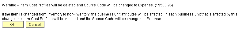

Once you have changed the item type from inventory to non-inventory and clicked the Save button:
  • A warning message is displayed if there are cost profiles that exist for any business unit that is using this particular SetID. If you click the OK button to continue past this warning, then the cost profiles are deleted, the cost element is set to blank on the BU_ITEMS_INV record, and the source code is changed to expense.
  • The Item Type Errors tab is displayed within this Define Items component. This tab only displays if there are outstanding transactions or stocked inventory quantities that prevent the system from changing the item type. The data on this tab can be downloaded to a Microsoft Excel spreadsheet for further analysis.
Warning message issued concerning cost profiles and source code This example illustrates the fields and controls on the Warning message issued concerning cost profiles and source code. You can find definitions for the fields and controls later on this page.
