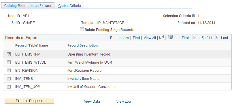

Catalog Maintenance Extract Page
Use the Catalog Maintenance Extract page (PO_EXPORT_CRITERIA) to select the item record to download and run the extract process to move data from the item master tables to the item staging tables.

This example illustrates the fields and controls on the Catalog Maintenance Extract page. You can find definitions for the fields and controls later on this page.

Delete Pending Stage Records
Select to delete rows in the item staging table from a previous extraction process. This option enables you to purge existing data for this template in the item staging tables.
Execute Request
Click the Execute Request button to run the PeopleCode that extracts the data. The records that you select on this page are retrieved from the item master tables and placed in the item staging tables.
View Data
Click to access the Select Fields page, where you can select the fields to view. Then click OK on the Select Fields page to access the View Data page, where you can review data. The text of this link changes depending on the record that is selected in the Record (Table) Name field.
View Log
Select to access the Item Ctlg Maint Export ViewLog (item catalog maintenance export view log) page, where you can view information about updates that are made by using this selection criteria ID. The information on this page can be useful for backtracking purposes. The text of this link changes depending on the name of the record that is selected in the Record (Table) Name field.

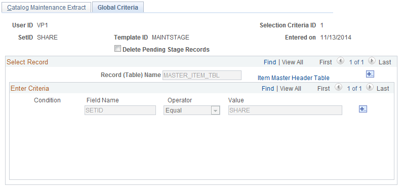

Catalog Maintenance Extract - Global Criteria Page
Use the Catalog Maintenance Extract - Global Criteria page (PO_EXP_GLB_CRTRIA) to enter criteria to further restrict the item data that is available to be changed.
Navigation:
SCM Integrations, and then Process Transactions, and then Items, and then Catalog Maintenance Extract, and then Global Criteria
This example illustrates the fields and controls on the Catalog Maintenance Extract - Global Criteria page. You can find definitions for the fields and controls later on this page.
To filter items before extracting them, use the fields on this page to filter items that you do not want to extract.

Enter Criteria
Define field criteria to use to narrow the scope of the item data update. For example, select Field Name ACCOUNT, Operator Equal, and Value 212020 to isolate the item data updates to items that are associated with account 212020.
