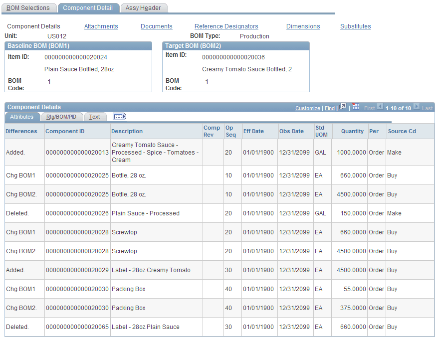

Common Elements Used in This Section
Field or Control Description
Differences
Displays the differences between the two BOMs. Values include:
  • Added: The component has been added to the Target BOM (BOM2).
  • Deleted: The component has been deleted from the Baseline BOM (BOM1).
    The system determines whether a component has been deleted, by comparing the component IDs, operation sequences, and effectivity dates.
  • Chg (change): Indicates that the component exists on both BOMs, but there are differences in the component attributes.
  • Chg BOM1: If you have made a component change to the baseline BOM, the components appear listed.
  • Chg BOM2: If you have made a component change to the target BOM, the components appear listed.
Note: The system lists a change when any information other than the component, operation sequence, or effective date has changed.

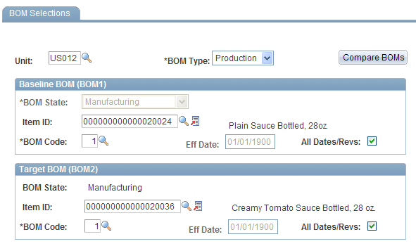

Compare BOMs - BOM Selections Page
Use the Compare BOMs - BOM Selections page (EG_BOM_COMPARE1E) to view the comparison of two manufacturing BOMs.
Navigation:
Manufacturing Definitions, and then BOMs and Revisions, and then Review BOM Information, and then Compare BOMs, and then BOM Selections
This example illustrates the fields and controls on the Compare BOMs - BOM Selections inquiry page. You can find definitions for the fields and controls later on this page.
Baseline BOM (BOM1)
Item ID
Select an item for the baseline BOM.
Item Search Button
Click the Item Search button to access the Item Search Criteria page and select a different item.
BOM Code
Select a BOM code for the baseline BOM. You can select any valid BOM code, but regardless of the depth that you select, the system calculates all lower levels based on the primary BOM code.
Eff Date
Enter the effective date for the baseline BOM if you do not want to use all dates and revisions.
All Dates/Revs
Select to compare all effective dates and revisions for the baseline BOM.
Target BOM (BOM2)
Item ID
BOM Code
Eff Date
All Dates/Revs
Compare BOMs - Component Detail: Component Details Page
Use the Compare BOMs - Component Detail: Component Details page (EG_BOM_COMPARE2) to view BOM component differences.
Navigation:
Manufacturing Definitions, and then BOMs and Revisions, and then Review BOM Information, and then Compare BOMs, and then Component Detail, and then Component Details
This example illustrates the fields and controls on the Compare BOMs - Component Detail - Component Details page: Attributes tab. You can find definitions for the fields and controls later on this page.
The header data appears by default from the Compare BOMs - BOM Selections inquiry page.
Rtg/BOM/PID Tab
This page displays routing, BOM, and production ID differences between the selected BOMs.
Subs Exist
If substitutes exist for a component, this field is selected.
Sub Supply
If the component is supplied by a subcontractor, this field is selected.
Compare BOMs - Component Detail: Substitutes Page
Use the Compare BOMs - Component Detail: Substitutes page (EG_BOM_COMPARE_SUB) to view component substitute differences for two selected BOMs.
Navigation:
Manufacturing Definitions, and then BOMs and Revisions, and then Review BOM Information, and then Compare BOMs, and then Component Detail, and then Substitutes
Substitute Items Tab
The system displays the substitutes' differences, including substitute item ID, description, and the original component ID.
Attributes Tab
The system displays the substitutes' differences, including substitute item ID, operation sequence, effective date, standard unit of measure, and conversion rate.
