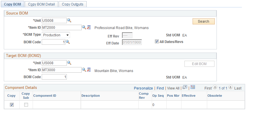

Copy BOM Page
Use the Copy BOM page (EN_BOM_COPY) to copy BOMs from one business unit and item ID combination to another.
Navigation:
Manufacturing Definitions, and then BOMs and Revisions, and then Maintain BOMs and Revisions, and then Copy Manufacturing BOMs, and then Copy BOM
This example illustrates the fields and controls on the Copy BOM page. You can find definitions for the fields and controls later on this page.
Copy BOM page
Source BOM
Field or Control Description
Unit, Item ID, BOM Code, , and Eff Date (effective date) or Eff Rev (effective revision)
Enter values for the BOM that you want to copy.
BOM Type
Note: The BOM type of the target BOM and the source BOM must be the same. Consequently, it is not entered in the Target BOM group box.
All Dates/Revs
Select to copy all dates and revisions for the BOM.
Search
Click to retrieve the source BOM.
Target BOM (BOM2)
Unit, Item ID, and BOM Code
Enter values for the target BOM. The item must be a valid Make or Buy item in the target business unit.
You cannot copy a BOM to a floor stock or expensed item.
You can also copy assembly and component text, documents, and attachments. Use the Copy Engineering BOM Detail page to copy attachments.
If you are copying a source assembly or end item that's revision-controlled to a target that is not a revision-controlled item, then the system uses the source component's revision effectivity dates to determine the effective and obsolete dates of the target item's components.
The target BOM is also updated with any component revisions specified on the source BOM.
Edit BOM
After you click Save, the system activates this button.
Click the Edit BOM button to access the BOM Summary page, where you can edit the attributes of the target BOM.
Note: You cannot copy a BOM to a target business unit and item ID if the assembly item or any of its components is not defined in the target business unit. If components do not exist in the target business unit, you can deselect the copy check boxes and add the balance of the BOM. You can then add the missing components in the target business unit and use the Manufacturing BOMs component to complete the BOM structure.
If the specific BOM already exists at the target business unit, you are prompted to overwrite the existing BOM with the information that you are currently copying. If you overwrite the existing BOM, the BOM in the target business unit is deleted and the source BOM is added.
Note: You cannot copy a BOM to itself.

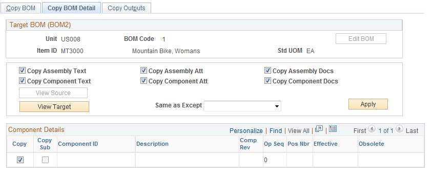

Copy BOM Detail Page
Use the Copy BOM Detail page (EN_BOM_COPY_DET) to view details of the BOM that you are copying.
Navigation:
Manufacturing Definitions, and then BOMs and Revisions, and then Maintain BOMs and Revisions, and then Copy Manufacturing BOMs, and then Copy BOM, and then Copy BOM Detail
This example illustrates the fields and controls on the Copy BOM Detail page. You can find definitions for the fields and controls later on this page.
Target BOM (BOM2)
You can select to copy assembly text attachments and documents, as well as copy component text, attachments, and documents.
Note: You can copy documents only if you've selected the identical item IDs for both the source BOM and target BOM.
View Source
Click to view the original that you are copying and the copying choices that you've made.
View Target
Click to preview how the BOM will appear after the copy.
Same as Except
Select to indicate how the BOM is copied. Values include:
  • Exclude All: The system copies no components to the target BOM.
  • Exclude Item Range: Fields appear so that you can enter a range of component IDs or position numbers that the system does not copy.
  • Exclude Pos Range (exclude position range): Fields appear so that you can enter a range of component IDs or position numbers that the system does not copy.
  • Include All: The system marks all components on the source BOM to be copied.
  • Include Date Range
  • Include Item Range: This feature is the same as the exclude feature except that you enter the range of items that you want to copy.
  • Include Pos Range (include position range): This feature is the same as the exclude feature except that you enter the range of position numbers that you want to copy.
  • Include Revision Range: You copy all components that are in effect between the specified dates or revisions.
  • Include Date Range and Include Revision Range
  • If you want to exclude a range of dates or revisions, select Exclude All and then include portions (by revision and date).
    You can use the Same as Except field values with any combination. For example, you can initially select Exclude All, click Apply, and then select Include Item Range to copy only those items that fall within the range.
  • You can also select Include Item Range or Exclude Item Range multiple times and click Apply after each selection to include or exclude chunks of items. The effect is cumulative, not exclusive.
    You can then deselect a component's Copy check box or click Exclude All to deselect all the check boxes.
Apply
Click once after you've selected the Same as Except value.
Copy
Select a component's check box to specify components or component revisions.
Copy Sub (copy substitutes)
Select to copy specified substitutes to the target BOM.
