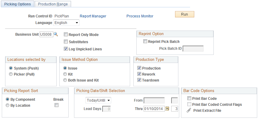

Picking Options Page
Use the Picking Options page (RUN_SFS6000) to generate picking plans for production.
You can generate pick plans for production with a status of Released or In Process.
Navigation:
Production Control, and then Process Production, and then Issue Materials, and then Create Picking Plan, and then Picking Options
This example illustrates the fields and controls on the Picking Options page. You can find definitions for the fields and controls later on this page.
Field or Control Description
Report Only Mode
Select to preview the pick plan before running it. The system does not create material reservations in Report Only mode because it is an information-only report.
Substitutes
Select to print substitutes on the pick plan.
However, if you do not want the picker to pick substitutes, run the pick plan without displaying any substitutes. In this case, you can also run the pick plan in Report Only mode first, list substitutes, and then make the substitution on the component list before running the final pick plan.
Note: Substitute items for rework and teardown end items do not appear.
Once a partial pick has been done using an item or its substitute, it must be completed with the same item. No partial picking is permitted. If there is a shortage of the original item and it has substitutes, the substitutes appear on the pick plan. They are distinguished by a border around the substitute items.
Note: The pick plan does not perform automatic substitutions.
Reprint Pick Batch
Select to reprint a previously printed pick batch.
Pick Batch ID
This edit box becomes available when you select Reprint Pick Batch. Select the pick batch ID number.
If this is the first time you're printing the picking plan, do not select the Reprint Pick Batch check box.
System (Push) or Picker (Pull)
Indicate whether the system uses one of the following methods to determine the locations from which is picks components:
  • If you select the PUSH method, the system recommends from which inventory locations to pick the material.
    When the system uses this method, it transfers the material from the suggested location upon material release. You can change the location prior to confirmation in the Review Plan page.
  • If you use the PULL method, you decide which inventory location from which to pull the material and enter that information in the Review Plan page.
    The picking plan displays all locations (up to a maximum of 10) where available inventory is located.
Issue Method Option
Select from the following options: Issue, Kit, and Both Issue and Kit. Subsequent selection options depend on the issue method selected here.
Issue
When this method is selected, components on production IDs or schedules whose issue method is set to Production Issue are picked. Because these components are sent to WIP locations for consumption during end-item completions, the Production Selection process prompts you for WIP location information.
The issue method uses netting to determine the amount of components to send to the WIP locations. The system includes all requirements through the selected date, even past due requirements when a date range is entered. It also checks requirements from production areas outside the selected range of production areas, if they share the same WIP locations.
For each required component, the system determines the available quantity on hand in the WIP location. If the quantity on hand is negative, the system treats it as 0. The system then determines the required quantity of the component for the selected production. The system also reviews the quantity of in-process picking plans for the component and the WIP location.
The system then checks the WIP minimum quantity, which is defined at the item and location level. It defines the additional quantity to be issued over and above the demand for Issue components. If all requirements occur as planned—and no additional material is issued to the WIP location—the component should have this quantity remaining in the WIP location.
Once all demand is calculated (quantity required + WIP minimum quantity), it's netted against all supply (quantity on hand in the WIP location + all pending pick plans destined for the location). If the demand is greater than the supply, that amount appears on the pick plan. If supply is greater than demand, the component is not printed on the pick plan.
Kit
When this method is selected, components on production IDs whose issue method is set to Production Kit are picked. Because these components are issued directly to a production ID and are not consumed from WIP locations during end item completions, you specify the production area, production ID, and operation to which you want to send material. You cannot send material to a WIP location. The pick plan nets the component's scheduled quantity against the issued quantity. If the scheduled quantity is greater than the issued quantity, it prints the quantity on the pick plan. If the issued quantity is equal to or greater than the scheduled quantity, the system considers that component requirement fulfilled and does not print it on the pick plan.
Both Issue and Kit
This method assumes that you're picking components for production regardless of the issue method. Using this option, some components are sent to WIP locations and some directly to a production ID. On the Production Selection page, you specify to which production ID kitted components are sent as well as which WIP locations are stocked.
Production Type
Select Production, Rework, or Teardown.
Note: A component with the item status of Hold for the production type Production cannot be picked. However, a component with item status of Hold for rework and teardown production can be picked.
Picking Report Sort
You can sort the picking plan by component, location, or production area. The production area option is available for only pull and push kits.
Break
Select to indicate that you want each component or location to print on its own separate page. The options available depend on the issue method selected. These are the valid combinations and sort options:
Push or Pull Issue Method By Component By Location By Production Area/ID
Push
Kit
Yes
Yes
Yes
Push
Issue, Both
Yes
Yes
No
Pull
Kit
Yes
No
Yes
Pull
Issue, Both
Yes
No
No

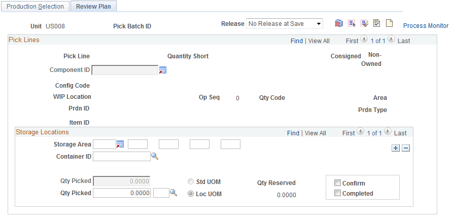

Reviewing and Confirming Picking Plans
Once you generate the picking plan, you must review the plan, make any modifications to PUSH picking plans before picking the material, and enter the picking locations for the material if you're using the PULL method to issue material. You can modify the picking plan before or after you pick the material.
Review Plan - Production Selection Page
Use the Review Plan - Production Selection page (SF_ISS_DIALOG) to select the specific pick batch that you want to review.
Navigation:
Production Control, and then Process Production, and then Issue Materials, and then Review Plan, and then Production Selection
Unit and Pick Batch ID
When reviewing the pick plan, these fields are required.
Line #, Component ID, Production ID, and WIP Location
You can use these fields to narrow the selection or as a way to view the pick plan.

Review Plan Page
Use the Review Plan page (SF_PICK_TRANS) to confirm that the material was pulled from the suggested stores location, or to indicate from which location the material was pulled.
Navigation:
Production Control, and then Process Production, and then Issue Materials, and then Review Inventory Pick Plan
Enter information on the Production Selection page and click the Search button to retrieve the plan.
This example illustrates the fields and controls on the Review Plan page. You can find definitions for the fields and controls later on this page.
Review Plan page
Release
Select how you want the material release to occur. Options are:
  • No Release at Save: Upon saving the page, material is reserved but not released to the production floor.
    You can release material to the production floor by using the Material Release page.
  • Release at Save: Upon saving the page, material is reserved and released to the production floor.
    The system automatically runs the Material Release process, which decrements the quantity on hand in the selected stores locations and issues the material to the WIP locations or to the production ID.
Kit Components
Where substitutes exist, the Comp ID (component ID) field is available, and you can display substitutes for the component.
The substitute component list is obtained from the BOM. No partial substitutions are allowed if components have previously been issued.
Note: When a kit component is substituted, the component list is updated to reflect the substitution when you click Save on the Review Plan page.
If a substitution is done on a PUSH pick plan, the original component is unpicked and the new component quantity picked. If the substitution is done on a PULL pick plan and a pick has already been recorded, the substitution is treated the same as for a PUSH plan.
Issue Components
For issue components that are consigned, the pick plan prints only non-owned material locations. If this component exists in an owned location, it must be manually transferred to an owned WIP location to be used in production. This cannot be done using the pick list.
The substitute component list is obtained from the business unit level because the component may be associated with multiple end items, resulting in multiple substitute item lists.
When an issue component is substituted, you must maintain the information at the component list on the Component List Maintenance page or the Edit/Issue Components page to record the substitution on the appropriate production IDs and production schedules. Until the data is updated or if another pick plan is run, the system attempts to pick the original component again.
Storage Location Search Button(storage location search button)
The system displays the number of storage levels defined for each storage location. Click the Storage Location Search button to search for a different storage area.
If you're using the PUSH material issue method, the recommended storage area appears. You can modify the storage area, if you pulled material from an alternate location, as well as the quantity picked. If you need to change the picking location for a component, set the quantity to 0 or delete the existing row, and insert a new row.
Storage Area
If you're selecting consigned kit issue components, including lot- and serial-controlled components, you can pick from both owned and non-owned WIP storage locations if material exists in both.
If you're using the PULL material issue method, specify the storage location such as Aisle, Level 1, Level 2, Level 3, and Level 4, depending on the storage level setup.
When using the PULL material issue method for rework or teardown production, you can override the typical method and select a nettable location.
Container ID
Enter the value if you're picking from containers.
Confirm
After reviewing each entry, you can confirm the selection by selecting this option. If you confirm an item with the item status of Hold, you'll receive a warning at save time. However, you are not prevented from confirming the pick. Only those components that have been confirmed are released to production.
Note: If you're modifying previously saved pick information, only the quantities can be modified. If you want to change picking location information, set the quantity to 0 or delete the row, and insert a new row.
Completed
Select to indicate that you are finished picking this pick line location. This option works with the Confirm option as follows
  • If you select both Complete and Confirm, you cannot pick additional quantity for this pick line location after the material release process has been run.
  • If you do not select Complete but you do select Confirm, you can pick additional quantity for this pick line location after the material release process has been run.
  • If you select Complete but you do not select Confirm, then the Material Release process does not process this pick line.
  • If you do not select Complete or Confirm, then the material release process does not process the pick line.
Lot ID and Serial ID
If you're using the PUSH material issue method, the serial ID is the serialized component that should have been picked from the storage area. If the component is lot-controlled, the system displays the lot ID from which the component should have been picked. If you need to change the serial ID or lot ID for a component, set the quantity to 0 and insert a new row.
If you're using the PULL material issue method, specify the serial ID or lot ID for each component that you picked.
If you are entering data for rework or teardown production IDs that are using serial genealogy, keep these points in mind:
  • If the assembly is serial-controlled and the Serial in Prdn option is selected and the component being issued is the assembly item, then you must enter a serial ID when prompted.
  • If the assembly is not serial-controlled, but the Serial in Prdn option is selected, then you must enter a serial ID when prompted.
  • The serial association occurs during the update.
Note: If the component to be issued is not serial-controlled but trace usage is serial, the Pick Plan process does not suggest the serial ID to pick. You must indicate which serial IDs are to be picked. The system verifies that the components have not been assigned to another production ID.
Note: This logic is also applied to other kit issues.
Confirm All Button
If you do not need to make any changes to locations or quantities (or once all changes and selections have been made), you can confirm all of the suggested locations and quantities at one time when you click the Confirm All button at the top of the page.
Unconfirm All Button
Click the Unconfirm All button to reverse all confirmed locations and quantities.
Delete All Button
If you do not pick any of the items on the pick plan, click the Delete All button to remove these rows from the pick plan. This relieves any hard material stock reservations that have been made.
Confirm
You can confirm selected pick lines by selecting this check box to indicate that these pick lines are correct and material is ready to be released.
Next Button
Click the Next button to access additional items in the scroll area.
All Complete Button
Click the All Complete button to indicate that all pick lines have been picked and there is no other quantity to be picked.
All Incomplete Button
Click the All Incomplete button to indicate that all pick lines are not complete. This indicates that you may want to pick additional quantities for specific pick lines.
Save
Click to process the review plan.
