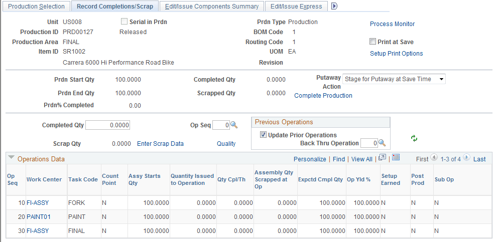

Record Completions/Scrap Page
Use the Record Completions/Scrap page (SF_COMPL_ID) to enter reversing entries for selected production.
Navigation:
This example illustrates the fields and controls on the Record Completions/Scrap page. You can find definitions for the fields and controls later on this page.
| Field or Control | Description |
Completed Qty (completed quantity) |
Enter a negative return quantity in this field. Note: If you enter a negative quantity in the Completed Qty (completed quantity) field, and you didn't select the negative completion on the Record Completions/Scrap - Production Selection page, you receive a message asking if you're doing a negative transaction. If Yes, then the transaction automatically selects the Negative Completions option for you, and you do not have to return to the Production Selection page and select the Negative Completions check box. |

Reversing entries are processed when you save the Record Completions/Scrap page.
