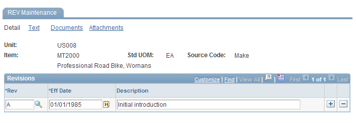

Use the REV Maintenance - Detail page (EN_REVISION) to define revision codes and determine the date that those revisions become effective.
Navigation:
Manufacturing Definitions, and then BOMs and Revisions, and then Maintain BOMs and Revisions, and then Maintain Item Revisions
This example illustrates the fields and controls on the REV Maintenance - Detail page. You can find definitions for the fields and controls later on this page.
Field or Control Description
Rev (revision) and Eff Date (effective date)
Enter values for each revision code that you're defining.
Although you can enter as many user-defined revisions as you want, there can be no overlapping dates and no gaps between revision dates for a specific item.
You cannot use the same revision multiple times for an item. Also, you cannot delete a revision if it's tied to an item or one of its BOM components or if it appears on a production order or an ECO. If a component is used on a BOM or an ECO and you attempt to change revision dates for the component, the system displays a warning.
