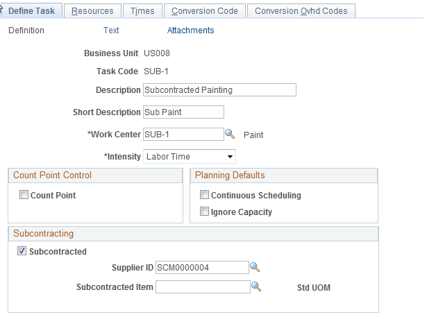

Define Task - Definition Page
Use the Define Task - Definition page (EN_TASKS) to define task information such as the time required to complete the task, the resources used for the task, and the task intensity.
Navigation:
Manufacturing Definitions, and then Resources and Routings, and then Tasks and Work Centers, and then Define Tasks, and then Define Task, and then Definition
This example illustrates the fields and controls on the Define Task - Definition page. You can find definitions for the fields and controls later on this page.
Before defining routings, you can define a master dictionary of tasks or jobs that can be performed at work centers.
After entering the business unit and task code, associate the task with a work center. You can associate multiple tasks with the same work center, but tasks can only take place in one work center.
Field or Control Description
Intensity
Select to determine the basis of your scheduling. You can base the start and end date of the operation on the operation's labor time (if it is labor intensive) or machine time (if it is machine intensive). Alternately, you can base the start and end date on the longer of the two times or on the sum of the labor time and the machine time (that is, the cumulative time).
Note: If you define a task as subcontracted, the system sets the intensity to Labor Time.
Count Point
Select to make the task a count point operation. A count point indicates the operations on a routing that record completions and scrap. You can define count points on the Define Routings - Summary page.
Note: Count points are optional and are used on only production IDs.
Planning Defaults
Select either or both of these options:
  • Continuous Scheduling: Select to complete the corresponding operation in a single run of continuous valid calendar time, with no down time.
  • Ignore Capacity: Select to prevent PeopleSoft Supply Planning solvers from checking the corresponding operation for capacity violations.
If you change a task by using one of these pages and the task is already associated with a routing operation, it does not change the routing information. Go to the Define Routings - Summary page to change the routing.
Subcontracting
Subcontracted
Select to specify a task this is performed by an outside subcontractor rather than in house. PeopleSoft Purchasing uses this information when creating subcontracted purchase orders.
If you select this check box, the Supplier and Subcontracted Item fields appear.
Supplier
(optional) Select the supplier who will provide subcontracted services for this task. PeopleSoft Purchasing uses this information when creating subcontracted purchase orders.
Subcontracted Item
(optional) Select the subcontracted item. If you select the subcontracted item and if you are using PeopleSoft Purchasing, then PeopleSoft Purchasing will generate a subcontracted purchase order for this specific subcontracted item.
Note: Subcontracted items are defined at a SetID level.
See PeopleSoft Managing Items: Defining Items at the SetID Level.
See Understanding Subcontracting Using PeopleSoft Manufacturing.

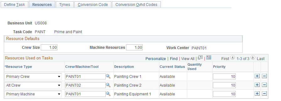

Define Task - Resources Page
Use the Define Task - Resources page (EN_TASK_RESOURCE) to (Optional) Define task resources.
Navigation:
Manufacturing Definitions, and then Resources and Routings, and then Tasks and Work Centers, and then Define Tasks, and then Define Task, and then Resources
This example illustrates the fields and controls on the Define Task - Resources page. You can find definitions for the fields and controls later on this page.
Resource Defaults and Resources Used on Tasks
The system copies the resource defaults, as well as the information from the Resources Used on Tasks field associated with the work center into the task information.
Resource Type and Crew/Machine/Tool
Edit resources (crews, machines, and tools) by selecting a resource type and the specific crew, machine, and tool, provided that you have already associated the resource with the task's work center. For example, on the Work Center pages, you can specify primary and alternate machines for the work center. On the Define Task - Resources page, you can change those selections for the particular task.
Qty Used (quantity used)
When you select a Primary or Alternate tool as a resource type, the quantity used field becomes available for entry. Enter the tool quantity required to perform the task. This field is for informational purposes only.
Priority
You can manually specify a priority for the task resource. The priority is an integer ranging from 1 to 999. The primary resource for a tool, crew, and machine automatically changes to a priority of 10. Other resources of like type automatically change to a priority of 20.
Using the priority factor, choose between a crew and a machine, irrespective of their resource type. The priority appears by default on the routing.
Only one primary crew and one primary machine can be associated with the task. You can, however, have unlimited primary tools and alternate crews, machines and tools.
You cannot associate crew and machine resources with subcontracted tasks.

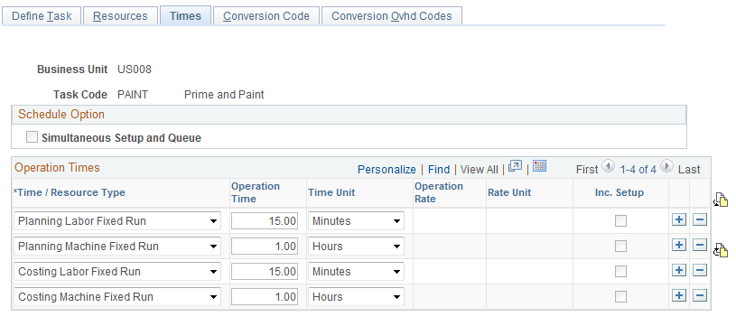

Define Task - Times Page
Use the Define Task - Times page (EN_TASK_TIME) to define task operation times and run rates.
Navigation:
Manufacturing Definitions, and then Resources and Routings, and then Tasks and Work Centers, and then Define Tasks, and then Define Task, and then Times
This example illustrates the fields and controls on the Define Task - Times page. You can find definitions for the fields and controls later on this page.
Task times are divided into labor and machine setup, run, fixed run, and post production. Additionally, you can have separate sets of times and run rates for planning and costing purposes. You can define in-transit and queue time for planning purposes only. When defining time and run rates, define only the types that apply to the task.
Setting Schedule Options
Simultaneous Setup and Queue
Select if setup for an operation can occur during the defined queue period. If this check box is selected, the system uses the longer of the two times when determining the lead time of an operation. When you associate a task with a routing operation, this option is not valid if the task is the first operation on the routing.
Planning to Costing Rate Copy Button Costing to Planning Rate Copy Button
The function of the Planning to Costing Rate Copy and the Costing to Planning Rate Copy buttons depends on existing planning or costing values on the page.
If you are using PeopleSoft Supply Planning, you cannot select the Simultaneous Setup and Queue option.
Setting Operation Times and Rates
In the Operation Times group box, define the manufacturing times or rates:
Setup
This is the amount of time required to prepare an item, machine, or work center for production. This might involve calibration of a machine or running samples before the start of production. Express setup time in minutes, hours, or days. When the time is expressed in days, the system determines the number of operational hours in a day by using the average daily hours for the work center assigned to the task. When determining an operation's lead time, the scheduling function uses the setup time and does not factor in the number of units that must be processed. You can also specify that setup can be done during a work center's queue time or that operation setup can take place anytime after the start of production, except at the first operation.
Run
This is the amount of time necessary to process one unit, with the rate expressed in minutes, hours, or days. Alternatively, the number of units that can be processed in one time period, with the rate expressed in units per minute, units per hour, or units per day. When determining the lead time of an operation, the scheduling function calculates the total run time by factoring in the number of units to be produced.
Fixed Run
This is the amount of time necessary to complete the task, regardless of the number of units processed. For example, if it takes 24 hours to burn in a board, and the process must run for 24 hours if it's burning in 1 board or 10 boards, you can express this time as fixed run. Fixed run time is added to the total lead time of the operation. You can express it in minutes, hours, or days.
Post Production
This is the amount of time required to clean up, flush, or break down a machine, a work center or an area, once production has been completed. The system does not include post-production time in the operation lead time calculation because it is assumed that this occurs when the units have moved on to the next operation. The system includes it in the item's cost. You can express post-production time in minutes, hours, or days.
Queue
Used in operation scheduling, this is the amount of time that units must wait at an operation before setup or processing can begin. You cannot define queue time for the first operation. For subsequent operations, however, you can define a queue time and whether or not setup can occur during the queue time. You can express queue time in minutes, hours, or days. The system does not include queue time in the operation's cost nor is it considered in PeopleSoft Supply Planning.
Intransit
Used in operation scheduling, this is the amount of time required to transport completed units from one operation to the next. Express in-transit time in minutes, hours, or days. In-transit time is not included in the operation's cost nor is it considered in PeopleSoft Supply Planning.
When setting up the task times and rates, you can designate a set of times and rates for planning purposes and a set of times and rates for costing purposes. You do not need to include all the planning times for scheduling the operation or task, nor do you need to include all the costing times in the item's cost. Simply select the time types that are appropriate for the task. The system displays this data on the Routing Operations - Times page when you select the task code that you want to associate with the operation sequence.
If you define a task as subcontracted, you can only maintain queue, in-transit, and labor times.
You can make changes to the task times on an item-by-item basis on the Routing Operations - Times page without affecting the task master data. Conversely, if you change task information on the Task Times page after the task has been assigned to a routing, the item's routing information is not automatically changed.
Op Time (operation time) and Op Rate (operation rate)
After selecting the operation type, enter an operation time or operation rate.
Time/Rate Unit
If you enter an operation time, then the values are:
  • Days
  • Hours
  • Minutes
For example, if you enter 5 in the Op Time field and Days in the Time/Rate Unit field, one unit would be completed every five days for the operation. You express setup, fixed run, post-production, queue, and in-transit times in terms of operation times. You can define a run in terms of operation time or a run rate.
If you enter an operation rate, then the values are:
  • Units/Day
  • Units/Hour
  • Units/Minute
For example, suppose that you enter 3 in the Op Rate field and Units/Day in the Time/Rate Unit field. Then, three units are completed every day for the operation. Use only operation rates to define run times.
If a task is already linked to a routing, and you change any times and rates for the task with this page, the system does not update the routing data. If you want the data to be identical, make the change using the Routing Time page.
Including Setup
You can only select the Inc. Setup (include setup) check box for the Planning Labor Setup and Planning Machine Setup operation types. In all other cases, the Inc. Setup check box is deselected and is unavailable for selection. If you do not select include setup, setup can begin before any production units arrive at the work center. Setup can occur at any time after the start of production, and the system does not include it as part of the item's lead time, except at the first operation. If you include setup, the setup time is factored into the task or operation's lead time. The system always includes setup in the lead time calculation of the first operation, if setup is specified, regardless of the check box setting.
PeopleSoft Supply Planning Considerations
If you are using PeopleSoft Supply Planning, be aware that:
  • If, in the item planning attributes, you've elected to maintain rates based on routings and resources as opposed to a lead time, then you must define labor or machine planning times (such as setup, run, or fixed run).
    Do this so that PeopleSoft Supply Planning can schedule operations and determine work center or resource capacity.
  • PeopleSoft Supply Planning does not consider labor or machine post-production time as a requirement on the work center or the work centers resources.
  • PeopleSoft Supply Planning does not consider queue and in-transit times, even if you have specified them for the task.
Costing Considerations
To calculate costs for a given item, operation, and time type, you must have a corresponding costing rate type defined for a given cost version. For example, if you have a costing fixed run time of five hours defined on the task here, you should define a fixed run conversion rate (for example, 100.00 USD per hour) on the Costing Conversion Rates page.
If you intend to cost the operation using a fixed amount per unit, as opposed to a rate per hour, you must include a corresponding costing operation time type. The costing operation time can represent the amount of time to complete the task, and the system uses it to calculate earned hours. However, the system uses the amount per unit in calculating the cost, regardless of the time specified. If you do not specify a costing time, the system does not include the per unit cost, even if there's a rate defined for the code assigned to the task.
