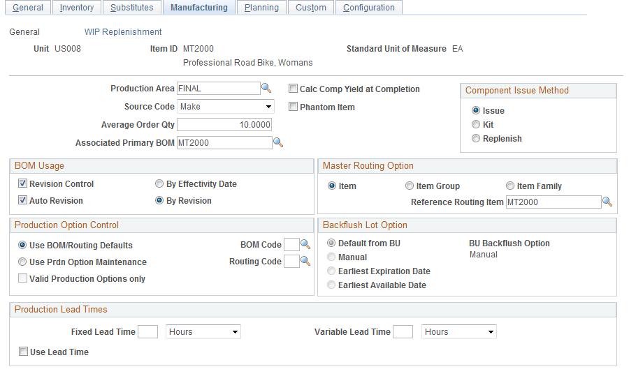

Manufacturing: General Page
Use the Manufacturing: General page (MFB_ATTRIB) to define a master routing for an item.
Navigation:
Items, and then Define Items and Attributes, and then Define Business Unit Item, and then Manufacturing, and then General
This example illustrates the fields and controls on the Manufacturing - General page. You can find definitions for the fields and controls later on this page.
Master Routing Option
Field or Control Description
Item
Select to link an item directly to the routing of the item that you select in the Reference Routing Item field. The default is the item itself.
Item Group
Select to link the routings of a reference routing Item to an item group. To use this option you must first define item group routings on the Group Rtg Assignment page.
Item Family
Select this option to link the routings of a reference routing item to an item family. To use this option, you must first define item group routings on the Family Rtg Assignment page.

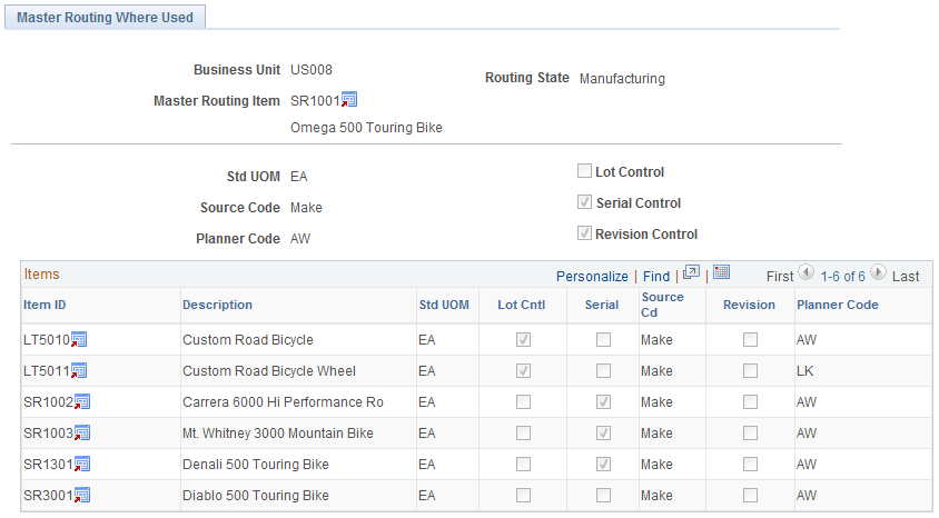

Master Routing Where Used Page
Use the Master Routing Where Used page (EN_RTG_MST_WH_USED) to display the items that reference an item as its reference routing.
You can display master routing where-used information for an item.
Navigation:
Manufacturing Definitions, and then Resources and Routings, and then Routings, and then Review Master Rtg Where Used, and then Master Routing Where Used
This example illustrates the fields and controls on the Master Routing Where Used page. You can find definitions for the fields and controls later on this page.
Item and Desc (description)
The page displays basic information about the item.
Production for an Item Button
Click the Production for an Item button next to the Master Routing Item field to view all production that is using the referenced (master) routing.
Click the Production for an Item button next to the item ID to access the Production Item List page to view item where-used production information for the specified item.
