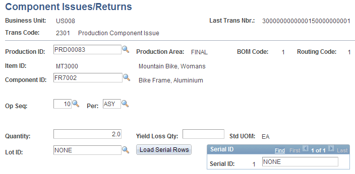

Component Issues/Returns Page
Use the Component Issues/Returns page (BCT_MG_CISS) to use this page to perform the electronic issue or return transactions for production IDs.
These EIP transactions are used to import edit or issue component information from third-party systems such as an MES. You can perform these transactions:
Navigation:
SCM Integrations, and then Create Transactions, and then Manufacturing, and then Component Issues/Returns
This example illustrates the fields and controls on the Component Issues/Returns page. You can find definitions for the fields and controls later on this page.
Field or Control Description
Component ID
Select the component that you're issuing, returning, or substituting.
Sub Item (substitute item)
If you're using transaction 2303, select a substitute to replace the original component.
Quantity
Enter a value.
Load Serial Rows
Click this button if the end item is serial-controlled or if the end item is being tracked using serial genealogy (serial in production). The system then creates as many rows as the quantity, and you can enter the serial IDs for each completed output. The quantity completed and the quantity scrapped must be whole numbers for serial-controlled items.
Quantity, Yield Loss Qty (yield loss quantity), and Per
Enter values for these fields. You must enter values for the quantity and yield loss quantity; both fields cannot be zero.
