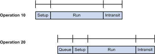

This diagram shows an example of operations overlap. The queue and setup are done sequentially. Assume that operations have overlap expressed as a percent (100% = total overlap, 0% = no overlap) or send ahead quantity. If overlap is expressed as a percentage, assume that all units are available for processing at the start of the run or soon after:
| Operation | Operation Start | Run Start | Operation Due |
10 |
Day 1, 8:00 a.m. |
Day 1, 9:00 a.m. |
Day 1, 2:00 p.m. |
20 |
Day 1, 1:00 p.m. |
Day 1, 4:00 p.m. |
Day 2, 2:00 a.m. |
