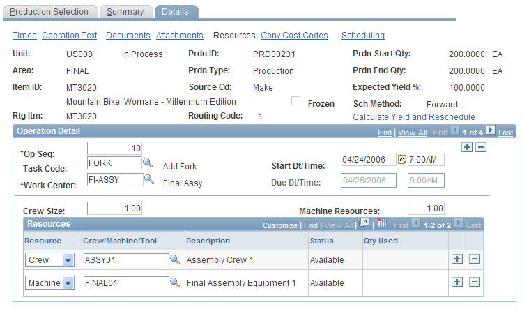

Details - Resources
SF_OP_RESOURCE
Production Control, and then Define Production, and then Production IDs/Schedules, and then Update Operation List, and then Details, and then Resources
Review or modify the resources assigned to each operation on the operation list.

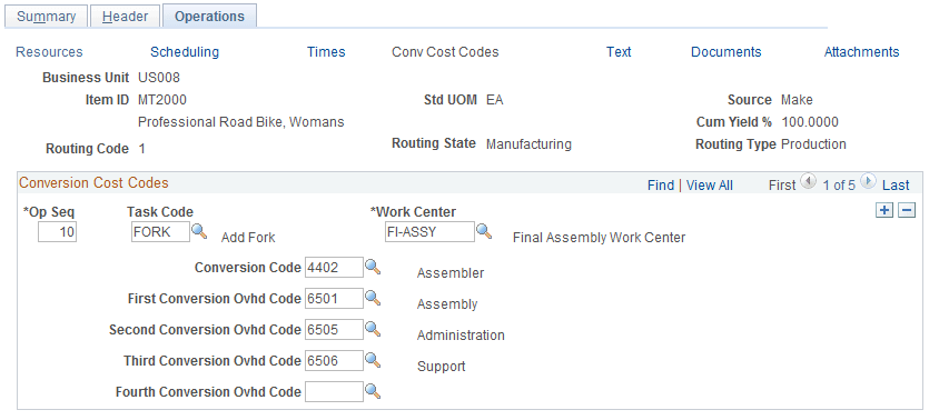

Details - Conv Cost Codes
SF_OP_CONCOST
Production Control, and then Define Production, and then Production IDs/Schedules, and then Update Operation List, and then Details, and then Conv Cost Codes
Add, change, or delete conversion cost codes for an operation.

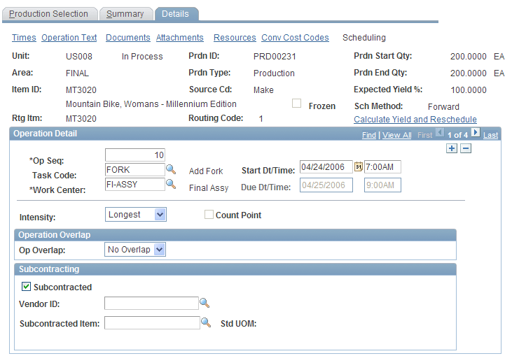

Details - Scheduling
SF_OP_SCHED
Production Control, and then Define Production, and then Production IDs/Schedules, and then Update Operation List, and then Details, and then Scheduling
Maintain operation scheduling options. Several scheduling options can be selected for operations, including simultaneous setup and queue, planning intensity, and operation overlap.

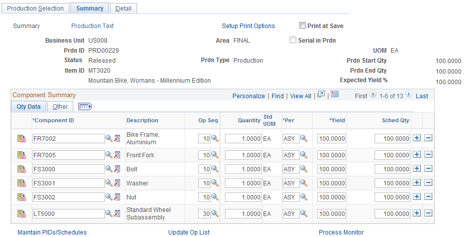

Summary - Summary Page
Use the Summary - Summary page (SF_OP_SUMMARY) to add, change, or delete operations on the operation list.
Navigation:
Production Control, and then Define Production, and then Production IDs/Schedules, and then Update Operation List, and then Summary, and then Summary
This example illustrates the fields and controls on the Update Operation List- Summary: Summary page. You can find definitions for the fields and controls later on this page.
Field or Control Description
Sort Operations by
Select End Date, Op Seq (operation sequence), or Start Date.
Print at Save
Select this check box if you want to print production documents at save time for a particular production ID.
Setup Print Options
Click this link to access the Process/Output Options page to select different print criteria for the production documents.
Calculate Yield and Reschedule
When inserting, changing, or deleting an operation, use this link to recalculate the operation quantities and start and due dates. You will be given the option of maintaining the existing start or end quantity and recalculating the other.

Sub (subcontracted)
Select this option if the operation is being sent to an outside supplier. A subcontracted operation can be defined when setting up a task or a work center, or you can specify it here. Keep these in mind when creating or maintaining subcontracted operations:
  • You can select or deselect the subcontracted check box as long as the purchase order for the subcontracted operation hasn't been created.
  • You cannot change the work center or task from a work center or task that is subcontracted to one that is not, once a purchase order for the subcontracted work has been created.
  • You cannot change the operation sequence if a purchase order for the subcontracted work has been created.
  • You can change the operation scheduling if a purchase order for the subcontracted work has been created.
    However, if the operation scheduling changes affect when the subcontracted work is received back from the supplier, the system sends a purchase order change request to PeopleSoft Purchasing, indicating a change in scheduling for the production ID.
  • If you're using count points, all subcontracted operations must be defined as a count point.
    In addition, the last operation step must be a count point.
  • You cannot have teardown outputs at subcontracted operations.
Count Point
Select this option if you want to define an operation step as a count point. Count points allow you to record completions at predefined operation steps. Material is consumed and labor and overhead will be earned back to the previous count point.

Details - Resources Page
Use the Details - Resources page (SF_OP_RESOURCE) to review or modify the resources assigned to each operation on the operation list.
Navigation:
This example illustrates the fields and controls on the Details - Resources page. You can find definitions for the fields and controls later on this page.
When maintaining the operation list, you can optionally define the crews, machines, and tools that will be used at work centers to perform specific tasks. In addition, keep these in mind when maintaining operation resources:
  • You cannot associate resources with a Pending status to an operation.
  • You can have no more than one primary crew, one primary machine, and one primary tool associated with each operation.
  • You cannot assign crews or machines to a subcontracted operation.
Op Seq (operation sequence), Task Code, Work Center, Start Dt/Time (start date and time), and Due Dt/Time (due date and time)
These values appear by default from the Operation Summary page, although you have the option to change them. If you change the task, the system deletes all task-related information defined for the operation including work center, resources, task times, and scheduling options. The system then adds the new task information to the current operation sequence. If conversion rates are defined at the task level, the system replaces the conversion and conversion overhead rates with the new rates.
If you change the work center, task, or operation sequence, click this link to update the schedule. To save the results of the recalculation, click the Save button before exiting the page.
Crew Size, Machine Resources, and Resource Types
You can change the costing resource attributes (crew size and machine resources). These attributes appear by default from the work center. Crew size is the number of people at the work center. The Machine Resources field displays the number of machines at the work center. The system uses both the crew size and machine resources to determine the standard cost of an item. Therefore, if you're changing the operation's crew size or machine resources, the change may result in process change variances for the production ID.
For each operation, the resource information appears by default from the resources associated with the work center that you assigned to the task, and therefore the operation. Only the primary crew, machine, and tools are copied to the operation list. You can enter additional resources (crews, machines, and tools) by selecting a resource type and the specific crew, machine, or tool. The resource's description, status, and, when the resource is a tool, quantity used appears. The resource must already be defined as a primary or alternate resource for the work center. You can also assign resources without assigning a task to the operation.
Details - Conv Cost Codes Page
Use the Details - Conv Cost Codes page (SF_OP_CONCOST) to add, change, or delete conversion cost codes for an operation.
Navigation:
This example illustrates the fields and controls on the Details - Conv Cost Codes page. You can find definitions for the fields and controls later on this page.
Conversion cost codes determine the labor, machine, outside processing, and overhead cost of the operation. When defining the costs, you associate a conversion rate or cost to each conversion code. The code is then entered on the task or work center, depending on the manufacturing installation options. The system then associates the corresponding rates with the operation when it copies the task or work center to the routing or operation list.
Conversion Code
Displays the associated values with the operation's work center if you're maintaining conversion rates at the work center level.
Conversion Ovhd Codes (conversion overhead codes)
To view the actual labor, machine, outside processing, and overhead rates or costs assigned to the code, see the Conversion Code and Conversion Overhead Code pages for the task or work center.
To change the labor, machine, or overhead cost for a specific operation, select a new conversion code to determine the new labor and machine costs. You can also select up to four codes that calculate the overhead costs associated with the operation.
Note: If you change the conversion code or the conversion overhead codes, and the rates associated with the new codes differ from the old ones, the change results in cost variances for the production ID or production schedule quantity.
Details - Scheduling Page
Use the Details - Scheduling page (SF_OP_SCHED) to maintain operation scheduling options.
Navigation:
This example illustrates the fields and controls on the Details - Scheduling page. You can find definitions for the fields and controls later on this page.
Op Seq (operation sequence), Task Code, and Work Center
These fields are unavailable if completions or scrap for this operation have been previously recorded.
Simultaneous Setup and Queue
Select this option if setup can occur during the queue time of an operation. If you select this option, the system considers the longer of the two times when determining actual production start or due dates.
Note: The Simultaneous Setup and Queue check box is not available if the page is displaying the first operation in a routing, if setup is not included for the operation, or if you're using PeopleSoft Supply Planning.
Count Point
This option is selected if the operation sequence is a count point. This field is display-only and appears by default from the Summary page. Count points enable you to record completions at predefined operation steps. Material will be consumed and labor and overhead will be earned back to the previous count point. Count points are optional, and are used only on production IDs.
Frozen Operation
Displays if the operation has been frozen by PeopleSoft Supply Planning. This check box indicates that a decision was made to hold or firm up the due date and that changes to the operation could result in a change to the operation's start and due dates and times. If the operation is frozen, and you change information that impacts the start/due dates and times, PeopleSoft Manufacturing displays a warning message indicating that the operation is frozen. You have the option to continue or cancel the changes. If you proceed with changing this information, the operation is no longer frozen.
Intensity
This value appears by default from the task and determines the basis of the scheduling. The start and due date of the operation can be based on either the operation's labor time (labor intensive) or machine time (machine intensive). Alternatively, the start and due date can be based on the longest (longest of the two times, evaluated for each time type within the operation). For example, if labor setup is 7 minutes, machine setup is 10 minutes, labor run is 20 minutes, machine run is 25 minutes, labor fixed run is 11 minutes, and machine fixed run is 7 minutes, the total operation time would be Machine Setup (10) + Machine Run (25) + Labor Fixed Run (11) = 36 minutes. Or, the start and due date can be based on the cumulative (the sum of the machine and labor time).
Make sure that you select an intensity that matches the resource used. For example, if you select Machine Time, you must be using machines to perform all or part of the operation and machine times or rates should have been specified for setup, run, fixed run, or all three.
Op Overlap (operation overlap)
Values include:
  • No Overlap: No operation overlap.
  • Percentage: If you select this option, the Overlap % (overlap percentage) field appears.
    This is the percentage of processing time remaining at one operation before the next operation can start. An overlap percentage of 100 percent means that the next operation can start at the same time as the current operation. An overlap percentage of 5 percent means that 95 percent of the operation must be completed before the next can start. Operation overlap cannot be less than 0 or more than 100 percent, and there can be no overlap on the last routing operation sequence or prior to a subcontracted operation. However, the supplier can send the end item back in multiple shipments. Therefore, you can define operation overlap for a subcontracted operation.
  • Send Ahead: An overlap by a specific quantity completed at the operation.
    If you select this option, the Send Ahead field appears. In this case, enter the number of units that need to be accumulated or finished before they can be sent to the next operation and the next operation can begin. The send ahead quantity must be a positive number. Whether you can enter a whole number or a decimal may depend on the item's unit of measure and quantity precision combination that was defined in PeopleSoft Inventory. For example, if Item ID A0007 has a unit of measure of EA and a Natural Round, Whole number combination, then you can enter only whole numbers. If you enter an incorrect number format, you'll receive an error message.
The default setting for Op Overlap is No Overlap. If you select No Overlap, the Send Ahead and Overlap % fields are not available.
Note: If an operation has a fixed run rate assigned to it, the preceding operation cannot have a send ahead quantity assigned to it because fixed run operations assume the entire quantity is available at the beginning of the run. For example, operation 1 cannot have a send ahead quantity assigned if operation 2 has a fixed runtime.
Subcontracted
This option is selected if the operation is being performed by a supplier. You cannot deselect this check box if purchase orders have been created for this outside supplier.
Supplier ID
If the subcontracted supplier was defined at the task level, then the name of the supplier appears in this field. Otherwise, you can select the appropriate supplier for this subcontracted operation.
Subcontracted Item
If this value was defined at the routing level, then the item appears in this field. You can change the value in this field.
Note: The subcontracted item will be used on any subcontracted purchase orders that are created for this operation.
Note: The UOM for the subcontracted item and the end item must be identical.
