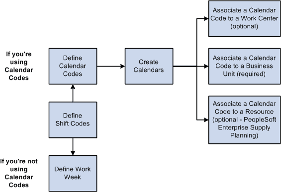

Process to Define Production Calendar Codes
This diagram illustrates how the system finds the production calendar code used by the scheduling and planning functions. The system first looks to the work center, if no calendar code is defined, then the system looks to the business unit and then the resource (if PeopleSoft Supply Planning is used). If no calendar code is defined then the system uses the defined work week.
Defining calendars for business units, work centers, and resources
