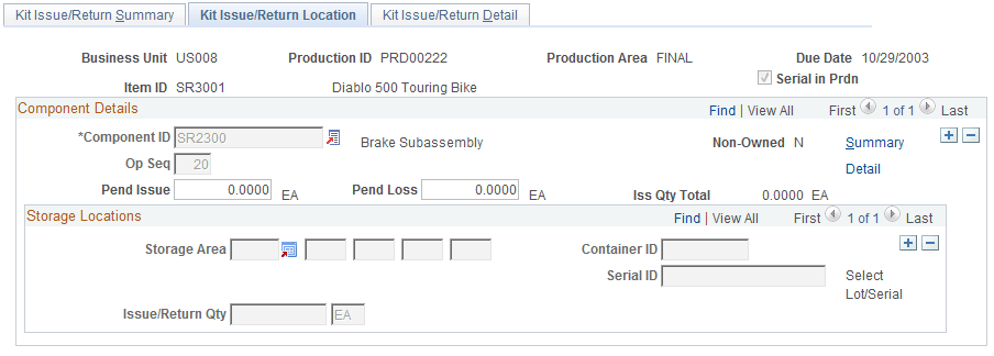

Kit Issue/Return Location Page
Use the Kit Issue/Return Location page (SF_KIT_ISSUE_EXPR) to indicate where you want to return kit components.
Navigation:
Production Control, and then Process Production, and then Issue Materials, and then Issue/Return Kit Components, and then Kit Issue/Return Location
This example illustrates the fields and controls on the Kit Issue/Return Location page. You can find definitions for the fields and controls later on this page.
Field or Control Description
Issue Qty Total (issue quantity total)
Displays the total quantity to be issued.
Non-Owned
Indicates if the component is either non-owned or consigned. You can issue additional configured, kit components from both owned and non-owned WIP storage locations.
Storage Area
Select a value to indicate the storage area.
Storage Location Search Button
Click the Storage Location Search button to select a different storage location.
If you're returning a component to inventory and you do not want to use the default putaway location, you can use directed putaway to determine the component's putaway location. The system suggests putaway locations that meet the predefined rules for directed putaway. For example, you might want to put away items in zones or based on available space or weight constraints. You can override the system-suggested storage location if necessary.
Note: Consigned kit components must be returned to owned storage locations.
Container ID
Specify the container if you want to move the quantity to or from a container. If a container is specified and the container exists in a storage area, the system displays the storage location for the container. If the container doesn't exist in a location or if a container is not specified, enter the storage area from which the components are issued or to which they will be returned.
Quantity
Enter the issue or return quantity. If you're returning components, enter the quantity to be returned as a negative number. To issue components, enter the quantity to be issued as a positive number.
