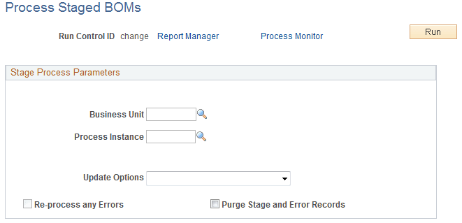

Use the Process Staged BOMs page (EN_RUN_BOMSTAGE) to reprocess corrected staged BOMs using the Process Staged BOMs process.
Navigation:
Manufacturing Definitions, and then BOMs and Revisions, and then BOM Mass Changes, and then Process Staged BOMs
This example illustrates the fields and controls on the The Process Staged BOMs process page . You can find definitions for the fields and controls later on this page.
Field or Control Description
Update Options
Select an update option. Values are:
  • Validate Only: Validates the data but doesn't load or change BOM tables.
  • Validate and Transfer: Validates the data and loads and changes BOM tables.
Re-process any Errors
If you are processing a large number of BOMs, you can correct the errors in the BOM pages but leave the status as Error. You then select this check box while running the BOM Loader process, and the system reprocesses transactions with the statuses of New, Reprocess, and Error. If this check box is deselected, only transactions with statuses of New and Reprocess are processed. This option is only applicable when you select Validate Only or Validate and Transfer.
Purge Stage and Error Records
Select this check box to delete the error transactions from the staging table once you have run this process.
  • If you select Validate and Transfer and Purge Stage and Error Records, the BOMs will first be validated and then transferred to the BOM tables.
    If any of the BOMs were invalid, the BOM tables won't be updated, but they will be deleted from the stage and error records.
  • If you select None and Purge Stage and Error Records, the BOMs won't be validated or changed.
    The stage and error records will be purged. This combination can be used to clean up after you have completed processing BOMs.
Run
Click to run this request. PeopleSoft Process Scheduler runs the Staged BOMs process at user-defined intervals.
