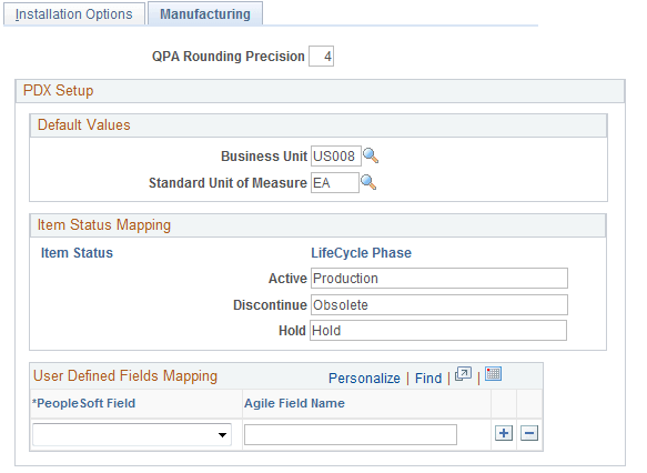

Installation Options - Manufacturing Page
INSTALLATION_MG
Setup required
Set up PDX defaults by defining the Business Unit, Unit of Measure, and the Item Status Mapping fields. Also map the PeopleSoft Field to the third-party application user-defined field name.

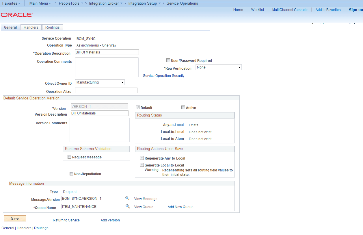

Service Operations - General Page
IB_SERVICE
Review and edit service operations for the PDX integration.
Service Operation References Page
IB_MESSAGE_SO_SEC
View associated service operations.

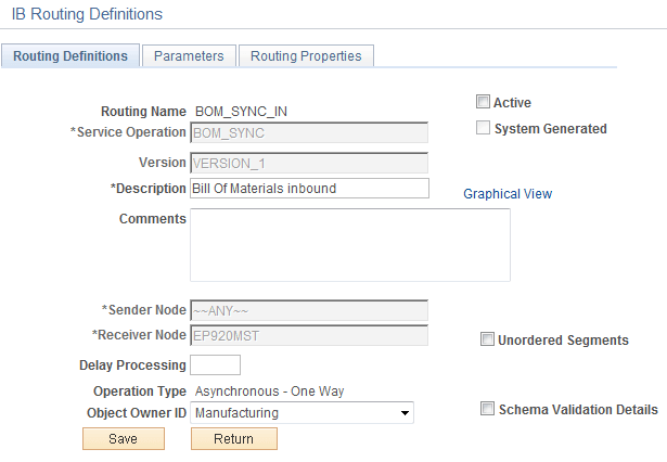

Routing Definitions Page
Service Operations - Routings Page
IB_ROUTINGDEFN
IB_SERVICERTNGS
Activate the routing.
You must activate the BOM_SYNC_PDX and ITEM_SYNC_PDX routings.

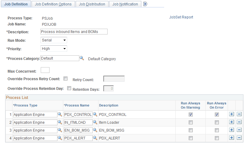

Job Definition Page
PRCSJOBDEFN
Default setup is delivered.
A job definition called PDXJOB is delivered and it contains the programs needed to process new service operations for items, revisions, and BOMs in the Data Maintenance component.
Use the Installation Options - Manufacturing page (INSTALLATION_MG) to set up PDX defaults by defining the Business Unit, Unit of Measure, and the Item Status Mapping fields.
Navigation:
Set Up Financials/Supply Chain, and then Install, and then Installation Options, and then Manufacturing
This example illustrates the fields and controls on the Installation Options - Manufacturing page. You can find definitions for the fields and controls later on this page.
PDX Setup
Field or Control Description
Business Unit
Select the value for the Manufacturing business unit that is to be assigned for changes received.
Standard Unit of Measure
Define a value for all inbound items being added. This is useful if all inbound items are to share the same UOM (such as EA).
Item Status Mapping
Define the item life cycle status mapping for items with a status of:
  • Active
  • Discontinue
  • Hold
This value is used when change orders are released to PeopleSoft. The PeopleSoft item status (setID and business unit) is based on the Affected Item Life Cycle value for each item on a change order. Therefore, any valid life cycle status that can be included on a change order sent to PeopleSoft must be mapped in this group box.
The LifeCycle Phase field on this page can contain commas to define a one-to-many mapping between PeopleSoft and the PLM. For example, the previous screenshot shows how the life cycle status of Production and Preliminary are to be considered an active item status for the PeopleSoft item status.
Note: When a new item with an active status is added from Agile™ with an effective date greater than today's date, the effective date of the affected item is ignored in PeopleSoft and the current date (today) is used at the item level (setID and business unit). This allows revisions and manufacturing BOMs to be created for the item in PeopleSoft. However, future effective dates are used for the start date of the item or revision, and also for future effective dates associated with a future item status. For example, if an item is currently active in PeopleSoft, you can send a change order to specify future obsolescence of the item by having an affected item with a future date and a future status intended to obsolete the item. In this case, the current PeopleSoft status remains active and a future status is to be specified as Discontinue.
User Defined Fields Mappings
PDX 1.0 supports user-defined fields within it. In version 1.0 of PDX, the Item Source Code and Unit of Measure are not standard fields. Some life cycle management systems (such as Agile™) will automatically populate custom attributes of the XML when you define these fields within the PLM system. If this is the case, you can use this group box to define additional mappings for the integration to reduce configuration. Item Source Code and Unit of Measure are required fields for PeopleSoft.
PeopleSoft Field and Agile™ Field Name
PeopleSoft standard values include:
  • Item Source Code (item)
  • Item Unit of Measure (item)
  • Operation Sequence (BOM component)
  • Cost Element (item)
  • Cost Group Profile (item)
For example if you are using Agile™ to enable these mappings, create a Page Two user-defined field using Agile Administrator™ for the appropriate Agile™ class. All classes are associated with the item in Agile™, except for the operation sequence, which is defined for the BOM component.
Note: The Page Two user-defined field names that you enter here must be defined on the Installation Options - Manufacturing page exactly (including the case) as you have defined them in Agile Administrator™. This is required because specific PeopleSoft Adapter translation code expects XML tags to be defined correctly or no mapping occurs for the value.
These several pages describe the node and service operations required to enable inbound messaging for PDX 1.0.
Use the Service Operations - General page (IB_SERVICE) to review and edit service operations for the PDX integration.
Navigation:
PeopleTools, and then Integration Broker, and then Integration Setup, and then Service Operations
This example illustrates the fields and controls on the Service Operations - General page. You can find definitions for the fields and controls later on this page.
Review or edit general information such as service and operation type, handlers, and routings associated with the BOM_SYNC and ITEM_SYNC service operations.
Use the Routing Definitions page (IB_ROUTINGDEFN) to activate the routing.
Navigation:
  • PeopleTools, and then Integration Broker, and then Integration Setup, and then Routings
    Select the BOM_SYNC_PDX value for the routing name.
  • PeopleTools, and then Integration Broker, and then Integration Setup, and then Service Operations
    Select the BOM_SYNC value for the service operation, and click the Routings tab.
    Click the Selected check box for the BOM_SYNC_PDX routing.
This example illustrates the fields and controls on the Routing Definitions page. You can find definitions for the fields and controls later on this page.
Active
Select this check box.
Save
Click this button to save your changes and activate the routing.
Important:
If you are activating the routings by using the Service Operations - Routings page:
  1. Select the check box for the BOM_SYNC_PDX routing definition.
  2. Click the Activate Selected Routings button.
    The routing Status changes to Active.
  3. Click the Save button.
Perform these same steps for the ITEM_SYNC service operation and ITEM_SYNC_PDX routing.
Setting Up and Running the Daemon Group and Related Job to Process Inbound PDX Files
This section discusses how to set up and run a Daemon group to process the transformed BOM_SYNC and ITEM_SYNC service operations into PeopleSoft master tables (after the change has been sent).
The Daemon application engine program checks the stage table to determine whether there is any inbound set of change orders, which would result in items or BOMs being processed. It processes the changes for items, revisions, and BOMs received from the PLM by initiating the PDXJOB when necessary. The PDXJOB then drives the processes to ensure that one inbound transaction (from a PDX service operation) is treated collectively and processed sequentially through the Item Loader (IN_ITMLOAD) and BOM Loader (EN_BOM_MSG) processes as part of the PDXJOB.
In addition, the PDXJOB includes an Alert process (PDXALERT) which notifies you of any processing errors.
Use the Job Definition page (PRCSJOBDEFN) to a job definition called PDXJOB is delivered and it contains the programs needed to process new service operations for items, revisions, and BOMs in the Data Maintenance component.
Navigation:
PeopleTools, and then Process Scheduler, and then Jobs, and then Job Definition
This job should already exist and should be defined exactly as indicated in this screenshot:
This example illustrates the fields and controls on the Job Definition page. You can find definitions for the fields and controls later on this page.
Job Definition page
See Step 2.
The processing sequence is very important when items, revisions, and BOM changes are sent to PeopleSoft. For example, item and revision information must be processed for a given change order prior to any BOM updates.

  2. Access the PeopleTools Job Definition page (PeopleTools, and then Process Scheduler, and then Jobs, and then Job Definition) and review the job named PDXJOB.
    This PDXJOB job controls the processing of individual change order packages sent to PeopleSoft by incoming transaction. The PDX_CONTROL controls the flow of these change orders by picking up item and BOM changes (IN_ITMLOAD and EN_BOM_MSG) from data maintenance in a FIFO (first in, first out) manner based on PDX transactions that are ready to be processed. This ensures that all items for the same transaction are ready to be processed with the BOMs being sent.
    The PDXJOB job includes the PDX_ALERT program designed to search for any processing errors and send an alert to the appropriate users. To facilitate exception processing, this email notification job is provided, which is included as the last process in the PDXJOB initiated by the PeopleSoft Daemon. Each time a package is processed, this job searches for any recent processing errors found in the PDX Change Order Exceptions page. If any errors are found, an email notification can be sent to users associated with the specified role. This email also includes a URL link back to the PDX Change Order Exceptions component where users can view the details of the errors. The email also includes a list of change orders that are in error, as well as the date and time that they were staged within PeopleSoft.
    Important:
    The run control ID for this process must be manually created with the name of PDX to run as part of the PDXJOB process.
    The PDX_CONTROL job automatically creates a run control and sets the appropriate values for processing for both the Item and BOM Loader processes with the run control ID of PDX. The PDX alert run control must be created manually and is used to establish parameters for the alert.
    Do not enter a value in the Recurrence Name field on the Job Definition Options page.
