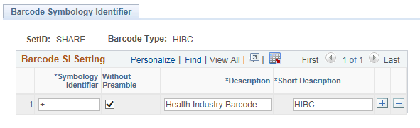

Barcode Symbology Identifier Page
Use the Barcode Symbology Identifier page (MIN_BARCD_SI) to enter the Barcode Symbology Identifier page details.
Navigation:
Set Up Financials/ Supply Chain, and then Product Related, and then Inventory Mobile, and then Barcode Symbology Identifier
This example illustrates the fields and controls on the HIBC Barcode Symbology Identifier page. You can find definitions for the fields and controls later on this page.
This page enables you to describe the Barcode Symbology Identifier details.
Field or Control Description
SetID
Displays the associated Set ID information.
Barcode Type
Displays the barcode information type.
Enter the barcode symbology identifier.
Without Preamble
Select to indicate if a character preamble is present on the scanner or not.
Note: This check box is not selected by default.
Description
Enter a description for the barcode symbology identifier.
Short Description
Enter a brief description for the barcode symbology identifier.

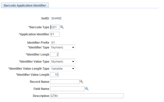

Barcode Application Identifier Page
Use the Barcode Application Identifier page (MIN_BARCD_AI) to enter the Barcode Application Identifier page details.
Navigation:
Set Up Financials/ Supply Chain, and then Product Related, and then Inventory Mobile, and then Barcode Application Identifier
This example illustrates the fields and controls on the Barcode Application Identifier page. You can find definitions for the fields and controls later on this page.
This page enables you to describe the Barcode Application Identifier details.
Set ID
Barcode Type
Enter the barcode information type.
Enter the alphanumeric value of the application identifier.
Identifier Prefix
Displays the application identifier prefix.
Identifier Type
Select an identifier type from the drop-down list.
Identifier Length
Enter numeric digits to indicate the length of the identifier in characters.
Identifier Value Type
Select an identifier value type from the drop-down list.
Identifier Value Type Length
Select an identifier value length type from the drop-down list.
Identifier Value Length
Enter the identifier value.
Record Name
Enter the record name.
Field Name
Enter the field name.
Description
Enter a description for the barcode application identifier.

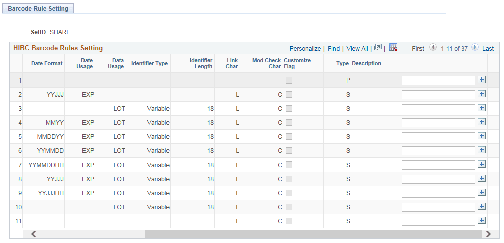

Barcode Rule Setting Page
Use the Barcode Rule Identifier page (MIN_BARCD_RULE) to enter HIBC Barcode Rule Setting page details.
Navigation:
Set Up Financials/ Supply Chain, and then Product Related , and then Inventory Mobile , and then Barcode Rule Setting
This example illustrates the fields and controls on the Barcode Rule Setting Page. You can find definitions for the fields and controls later on this page.
This page enables you to describe the Barcode Rule Setting details.
Displays the alphanumeric value of the application identifier.
Qty Format
Displays a character to indicate the quantity type.
Qty Length
Displays the length of the quantity value.
Date Flag
Displays a character to indicate the date type.
Date Format
Displays the appropriate date type.
Note: Formats like DD, YY, YYYY ,MM, JJJ and HH are supported but D, YYY, and HM are not.
Date Usage
Indicate the date type (expiry or manufacture) from the drop-down menu.
Data Usage
Indicate data type (Lot or Serial ID) from the drop-down menu.
Identifier Type
Indicate the data length (variable or fixed) from the drop-down menu.
Identifier Length
Displays the maximum data length .
Link Char
Displays the link character.
Note: This is the checksum control character as calculated for the product ID barcode.
Mod Check Char
Displays the mod check character
Note: This is the checksum control character for the secondary barcode using the modulus 43 algorithm.
Customize Flag
Select to indicate the barcode rule is customized by the customer and is not system assigned.
Type
Displays the current barcode rule type; the customized rule type is always S.
Description
Enter a description for the transaction rule.
Note: You may add a new rule, but it may not always be recommended to do so; the page design is for the HIBC rule to loads automatically
