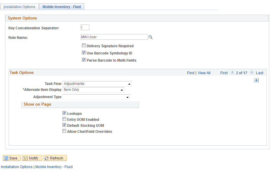

Use the Installation Options - Mobile Inventory - Fluid page (INSTALLATION_MIN_N) to define installation options for the adjustment task flow.
Navigation:
Set Up Financials/Supply Chain, and then Install, and then Installation Options, and then Mobile Inventory- Fluid
Select Adjustment in the Task Flow field.
This example illustrates the fields and controls on the Installation Options - Mobile Inventory - Fluid page for the Adjustments task flow. You can find definitions for the fields and controls later on this page.
Installation Options - Mobile Inventory page for the Adjustments task flow
Use this page to set up default options for adjustments at the installation level for mobile devices.
Field or Control Description
Alternate Item Display
Select an option that indicates how an item, alternate item, or both are displayed when an alternate item is specified for the transaction. Options include: Alternate Only, Alternate as Primary, Item Only, and Item as Primary.
For more information about alternate items:
See Setting Up Alternative Item Identifiers.
Lookups
Select this check box to indicate that Lookup icons for fields in this task flow are to be displayed on the Mobile Inventory - Adjustments page. The Lookup icon enables you to view a list of values and select one.
Entry UOM Enabled (entry unit of measure enabled)
Select this check box to indicate that the Entry UOM field is to be displayed on the Mobile Inventory - Adjustments page.
Default Stocking UOM
Select this check box to indicate that when item information is returned on the Mobile Inventory - Adjustments page, the default stocking UOM is to be used as the default UOM for the item, instead of the standard UOM.
Filter All Alternate Items
Select to indicate that you want the system to search through all possible alternate items when filtering a table. If an alternate item identifier is entered in the Filter field, the item ID (MASTER_ITEM_TBL) that matches the alternate is shown in the table.
Deselect to indicate that only the item ID is to be used for filtering, which also improves system performance.
