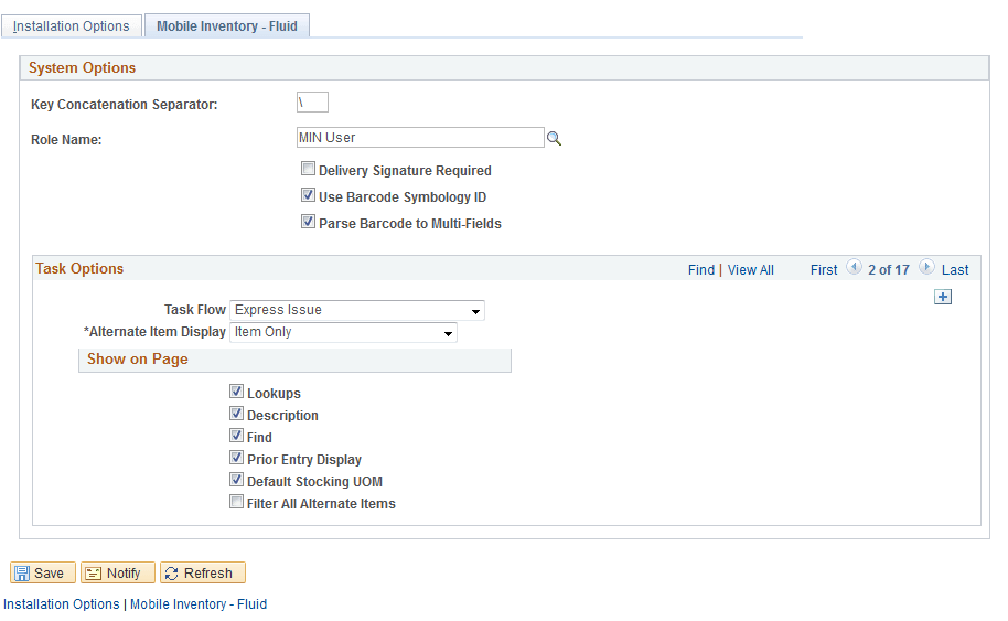

Installation Options - Mobile Inventory - Fluid Page
Use the Installation Options - Mobile Inventory - Fluid page (INSTALLATION_MIN_N) to define express issue installation options.
Navigation:
Set Up Financials/Supply Chain, and then Install, and then Installation Options, and then Mobile Inventory - Fluid
Select the Express Issue task flow
This example illustrates the fields and controls on the Installation Options - Mobile Inventory - Fluid: Express Issue task flow page . You can find definitions for the fields and controls later on this page.
Installation Options - Mobile Inventory: Express Issue task flow page
You use installation options to define default values for Mobile Express Issue pages in the PeopleSoft system and to control the behavior of the transaction.
