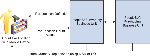

The following diagram illustrates the par location counting process when using mobile devices and PeopleSoft Mobile Inventory Management:
This example illustrates the process flow for counting the stock in a par location using a mobile device.
The process flow for counting the stock in a par location using a mobile device
The sequence of events in the par location count using PeopleSoft Mobile Inventory Management is:
