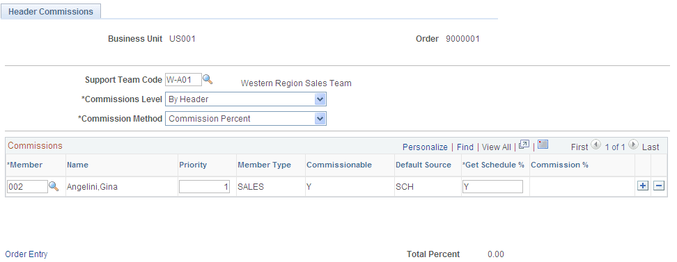

Header Commissions Page
Use the Header Commissions page (ORDENT_HDR_COMM) to view or modify commission information for a sales order at the header level.
Navigation:
Select Commissions from the Header Menu on the Order Entry Form page.
This example illustrates the fields and controls on the Header Commissions page. You can find definitions for the fields and controls later on this page.
Field or Control Description
Support Team Code
Displays the support team code, which appears by default from the General Miscellaneous Info (general miscellaneous information) page, associating the commission with the default team for orders by this customer.
Note: You can maintain support team information for an order regardless of whether any support team members are eligible to receive commissions.
Commissions Level
Select the commission level, which appears by default from your selection on the Order Management Setup page. Values are:
By Header: The Method field can only be Comm Pct (commission percentage).
By Sched (by schedule): The Method field can be either Comm Pct or Pro-Rata.
Member
The system populates the member lines with members of the selected support team, thereby making those team members eligible to share this commission. You can change the default support team code or opt for no support team at all. You can also add or delete team members from the commission.
Priority
Appears by default from the Support Team Members page. Confirm that the person selected as the 001 priority member is actually a member that has been identified as a salesperson on the Team Member Types page. If not, then you might have the wrong salesperson referenced on PeopleSoft Billing and Receivables documents.
Member Type
Appears by default from the Member Commission page for the team member along with the Commissionable option. The default source can be either SCH (schedule), if the commission is based on a schedule, or MBR (member), if the commission is based on a flat rate.
Get Schedule % (get schedule percentage)
Applies to commission schedule percentages only.
Commission % (commission percentage)
Displays the commission percentage. Values are based on the Default Source field. If the default source is:
MBR: Percentage changes by default from the selection on the Members Commission page for the team member.
SCH: Percentage is updated after the Update Order Commissions Data process is run. The process determines the correct percentages from the commission schedule set up on the Member's Commission Schedule page, and populates the Comm Pct field with that value.
SCH: when you are using the Pro-Rata method: Enter a portion of 100 percent for each team member who shares the commission for the product. The commission percentage for the product is established on the Product Definition - Options page. The total of the values entered for Comm Pct can be any amount from 0 to 100. The split between the commission points of the various team members must equal to 100 percent.
Commissions are not calculated or paid on orders. The information is optional and is not currently used for any calculations.
