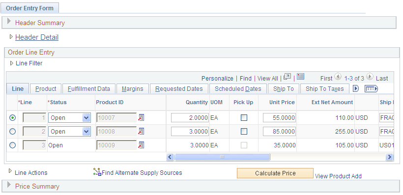

Order Entry Form Page
Use the Order Entry Form page (ORDENT_FORM_LINE) to adjust margins on the Order Entry form.
Update margins for individual lines, sections, and the entire order.
Navigation:
  • Order Management, and then Quotes and Orders, and then Create or Update Sales Order
  • Order Management, and then Quotes and Orders, and then Create and Update Quotes
You can access these areas only if you are using global price updates for the business unit and security has been set up using Feature Function Security.
This example illustrates the fields and controls on the Order Entry Form page. You can find definitions for the fields and controls later on this page.
Margins Tab
Access the Margins tab.
Use this section to make changes to individual lines and create sections.
