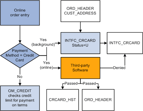

Step 1: Creating credit card charges during online order entry in PeopleSoft Order Management
Step 2: Submitting credit cards for background processing in PeopleSoft Order Management

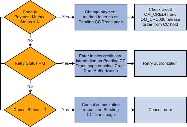

Processing failed credit card authorizations in PeopleSoft Order Management (1 of 2)
Processing failed credit card authorizations in PeopleSoft Order Management (2 of 2)

This section describes how credit card data can be entered for an order and have only an authorization processed to the card.
  1. Enter an order with a payment method of credit card on the Order Entry Form page and click the Credit Card Data button to enter or modify the credit card information.
  2. Authorize the credit card online while entering a sales order or place the order on hold and run these two processes:

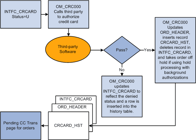

    1. Load CC Interface process (OM_CRCARD).
    2. CC Processing (OM_CRC000).
      For OM_CRCARD to load the pending credit card data to the interface table and OM_CRC000 to transmit for authorization or approval, a working third-party integration to the credit card application must be installed in the system.
  3. Review failed credit card transactions in the Identify Pending Transactions component.
    Use the Pending Credit Card Transactions page (OM_INTFC_CRCARD1 ) to review the status of pending or failed credit card transactions or navigate to additional pages to correct or reset credit card transactions.
    You can also reauthorize credit card transactions that were denied during sales order entry if using online authorizations. (Navigation: Order Management, Quotes and Orders, Create Credit Card Trans, Identify Pending Transactions)
  4. Review the credit card transaction history for the order on the Credit Card History page (OM_CRCARD_HST). (Navigation: Order Management, Quotes and Orders, Review Order Information, Review Credit Card History)

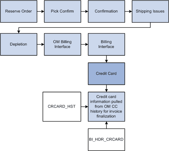

  5. Run the OM Billing Interface process (OM_BILL).
    After the authorization is successful or you changed the payment terms for the order, the order can be processed through the fulfillment cycle. Then run OM_BILL to pass the information to PeopleSoft Billing for the shipped orders. It populates the Billing Interface tables in PeopleSoft Billing, which the Billing Interface process (BIIF0001) uses to create invoices. If the amount increases, for example if shipping charges are added in PeopleSoft Inventory, Billing will reauthorize the amount when the invoice is finalized. If the authorization reversal feature is enabled, and the amount increases, Billing will issue an authorization reversal transaction to cancel the authorization performed in Order Management and release the money held on the customer's credit card.

It is also possible that after the invoice is created in PeopleSoft Billing, additional charges are added to the invoice, either manually or by the Billing Interface. For example, an invoice for 150 USD is created in Billing, but freight charges are added to the invoice for 20 USD. In Billing, if Authorization reversals are enabled, when the card is processed, the Auth for 150 USD will be reversed and a new Auth/Bill transaction for 170 USD will be processed. In this scenario, the history table would be as shown below:
Order Number Product Transaction Amount
ORD-ABC
OM
Auth 100 USD
ORD-ABC
OM
Auth Reversal 100 USD
ORD-ABC
OM
Auth 150 USD
ORD-ABC
BI
Auth Reversal 150 USD
ORD-ABC
BI
Auth/Bill 170 USD

  1. Use the Load Credit Card Interface page (RUN_OM_CRCARD ) to initiate the Load CC Interface process.(Navigation: Order Management, Quotes and Orders, Create Credit Card Trans, Load Credit Card Interface)
    This process loads the credit card information from the ORD_HEADER table and address information from the CUST_ADDRESS table into the INTFC_CRCARD, the main staging table for the credit card authorization interface program to the third-party credit card authorization and payment application.
  2. Use the Credit Card Processing page (RUN_OM_CRCARD) to initiate the Credit Card Processing process. (Navigation: Order Management, Quotes and Orders, Create Credit Card Trans, Request Credit Card Process )
    The Credit Card Processing process takes the credit card information from the INTFC_CRCARD staging table and calls the Process Credit Card process. It also removes the hold that was applied when the order was created, assuming you have set up the PeopleSoft Order Management Business Unit to do that.
    If reauthorization of stale transactions is enabled on the OM installation record, then a corresponding check box appears on the Credit Card Processing page. You should schedule this process to run at least once per day with this check box selected on the run control.
    The Enable Authorization Reversals for Decrements option needs to be selected in the Installation Options for authorization reversals for decrements. The batch process will handle the reversals if necessary.
    If purging of security codes is enabled on the installation record (indicated by a value greater than zero), then a Purge Security Codes check box appears on the Credit Card Processing page. The user should schedule this process to run at least once per day with All Business Units selected.

Credit Card Status Page
Use the Credit Status page (OM_INTFC_CRCARD2 ) to review or change credit card address information, review the results of any processing calls made to the third-party credit card authorization and payment application for a transaction, change the authorization status to resubmit the transaction, change the payment terms from the credit card to the default terms for this customer, or cancel the order.
Navigation:
Click the Credit Status link on the Pending CC Trans page for the transaction you want to review.
Select an option in the Actions group box to intercede in credit card processing:
Field or Control Description
Unprocessed/Retry
Sets the authorization status to Unproc/Ret. You can reauthorize the same credit card or enter a different credit card number. The CC Processing process picks up the transaction the next time you run the process and resubmits the credit card amount for batch authorization. If using online authorization, you can click the Authorize Credit Card link to reauthorize the failed transaction.
Change to Terms
Removes the transaction from credit card processing. You can change the payment method from credit card to payment terms. Once you change the order to payment terms, the system checks the credit limit and Receivables balance before the order is released.
Cancel Order
The credit card amount for the order will not be reauthorized. The order must be canceled on the Order Entry Form page.
