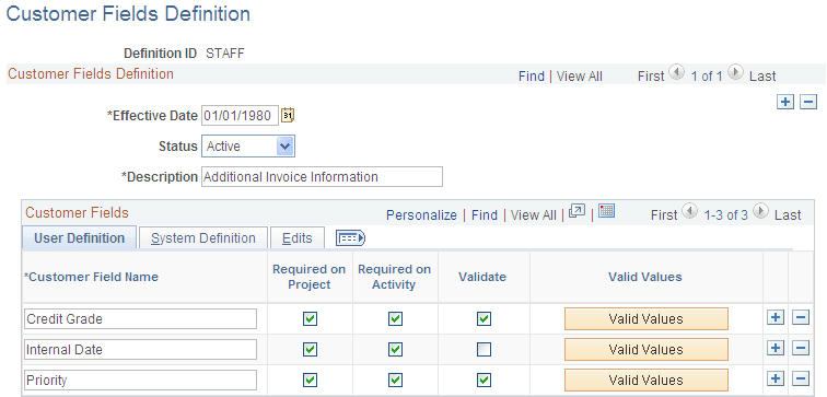

This example illustrates the fields and controls on the Customer Fields Definition page. You can find definitions for the fields and controls later on this page.
Field or Control Description
Definition ID
Displays the customer field definition ID that you entered when creating the definition.
Effective Date
Select the date on which the definition is effective.
Status
Select the current status of this definition: Active or Inactive.
User Definition
Customer Field Name
Enter a description of the field in the customer's terms, such as Customer Cost Center Number or Customer Supervisor Name.
Required on Project
Select this check box if a value is required at the project or order level.
Required on Activity
Select this check box if a value is required at the activity or assignment level.
Validate
Select to ensure that the system verifies that the value entered in the Description field (for the customer field name) in the Order and Assignment components is from the list of valid values that you create in the Valid Values list.
Valid Values
Click to enter valid values for a prompt list that can be validated against if the Validate check box is selected. Examples include items that are specific to the customer, such as supervisor names or cost center codes.
System Definition
System Field Name
Select the field in the PeopleSoft Billing application that is populated with this value in the billing interface tables.
Length
Displays the length of the value as defined by the database.
Minimum Length and Maximum Length
Enter the minimum and maximum lengths. These fields are informational only, but you can leverage them to create custom validations for your customer field definitions.
Edits
Edit Mask and Long Description
