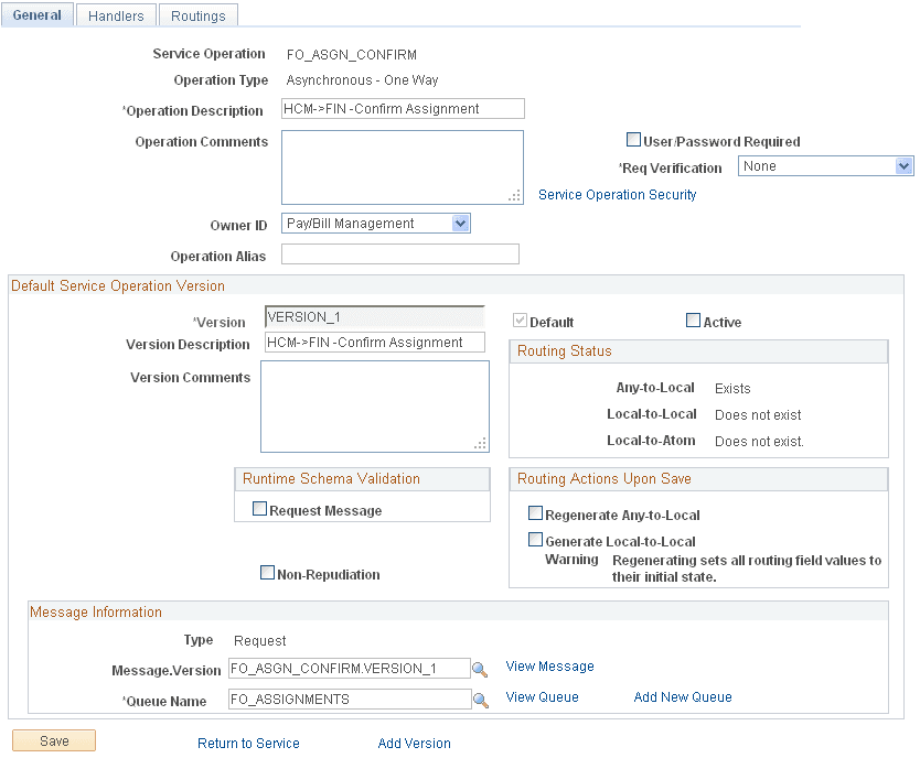

Select , Integration Broker, Integration Setup, Service Operations.
Select the General tab.
This example illustrates the fields and controls on the Service Operations page — General tab. You can find definitions for the fields and controls later on this page.
Select the Activecheck box to Activate the Service Operation flag.
Select Save.

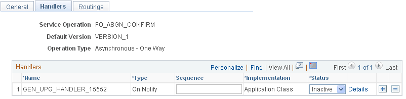

Select the Handlers tab.
This example illustrates the fields and controls on the Service Operations page — Handlers tab. You can find definitions for the fields and controls later on this page.
Set the Status of the desired Handler to Active.
Select Save.

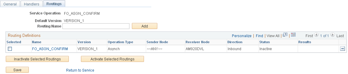

Select the Routings tab.
This example illustrates the fields and controls on the Service Operations page — Routings tab. You can find definitions for the fields and controls later on this page.
Set the Status of the desired Routing to Active.
Click Save.

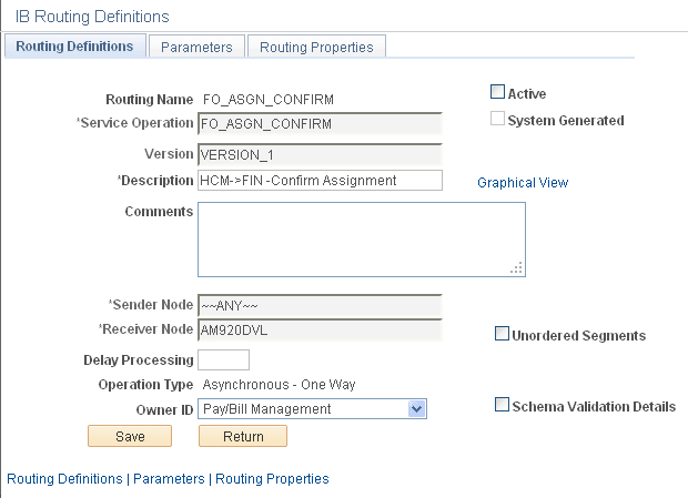

To setup the Service Operation Routing click on the link of the desired routing and enter the routing data.
Setting up routings is only required if the routing requires transformation or it is a new routing.
To setup a new Service Operation Routing enter a new Routing Name and click Add. Then enter the routing data.

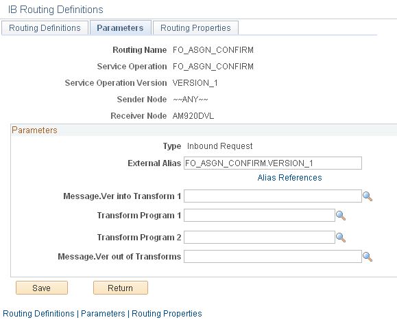

To enter Service Operation Routing Parameters, such as transformation information, select the Parameters tab.
This example illustrates the fields and controls on the Service Operations - IB Routing Definitions - Page. You can find definitions for the fields and controls later on this page.
Click Save.
