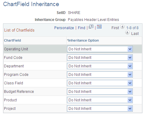

Use the ChartField Inheritance page(CF_INHERIT) to specify inheritance options for all non bank-related accounting entries, such as supplier liabilities, customer receivables, VAT, expenses, and so on.
Navigation:
Setup Financials/Supply Chain, and then Common Definitions, and then Design ChartFields , and then ChartField Inheritance
This example illustrates the fields and controls on the ChartField Inheritance page. You can find definitions for the fields and controls later on this page.
