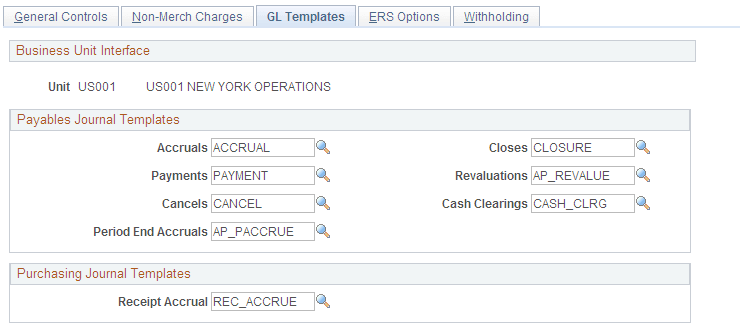

Procurement Control - GL Templates Page
BUS_UNIT_INTFC6
Specify the payables journal templates.

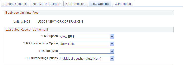

Procurement Control - ERS Options Page
BUS_UNIT_INTFC5
Enable ERS processing for the general ledger business unit and select the self-billed invoice (SBI) document option.

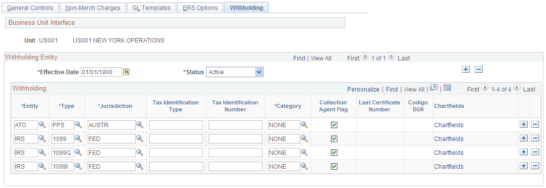

Procurement Control - Withholding Page
BU_WTHD_JUR
Specify general ledger business unit withholding setup options. The withholding process uses this information to determine the withholding entities to which you report or for which you act as a collection agent.

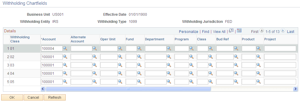

Withholding ChartFields Page
WTHD_BU_CF
Set up accounting ChartField parameters. Specify general ledger information for each withholding class; indicate where the withholding amounts are going with respect to general ledger.

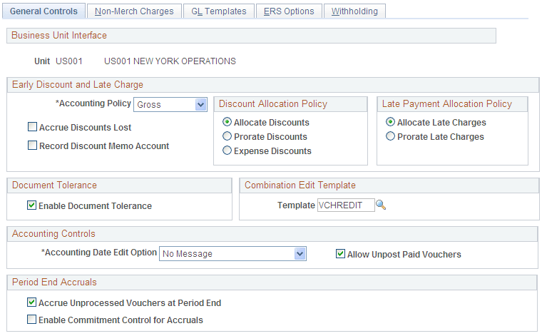

Procurement Control - General Controls Page
Use the Procurement Control - General Controls page (BUS_UNIT_INTFC1) to specify how accounting entries are processed.
Navigation:
Set Up Financials/Supply Chain, and then Business Unit Related, and then Procurement, and then Procurement Control, and then General Controls
This example illustrates the fields and controls on the Procurement Control – General Controls page. You can find definitions for the fields and controls later on this page.
Early Payment Discount and Late Payment Charges
All of the fields in this group box are used during posting and none can be overridden, except the accounting policy, which you can override when you create a voucher.
Field or Control Description
Accounting Policy
Select an option to use as a default for vouchers. You can override the accounting policy when you create a voucher. Options are:
Gross: The system uses the gross amount of vouchers as the basis for accounting; any discounts taken are recognized as discounts earned.
Net: The system uses the net amount of vouchers as the basis for accounting. Any discounts that you lose are recognized as discounts lost.
Accrue Discounts Lost
Select to account at net per German and Austrian requirements. If you select this option, the system accounts for lost discounts during voucher posting. If you don't select this option, the system accounts for lost discounts during payment posting.
Record Discount Memo Account
Select this option to record both discount earned and discount lost at payment creation regardless of whether you account at net or gross.
See Understanding Discount Accounting Controls.
Discount Allocation Policy
Use the fields in this group box to determine how discounts are charged.
Allocate Discounts
Select to have the system use the account from the accounting entry template and create all other ChartFields based on the inheritance rule for the SetID associated with the general ledger business unit of the distribution line. (The system uses the PeopleSoft Payables distribution-level entries inheritance group).
The discount lines inherit the general ledger business unit of the distribution lines.
Prorate Discounts
Select to have the system create discount entries on separate lines using the account and all other ChartFields on the distribution lines for the voucher.
Expense Discounts
Select to have the system use the account from the accounting entry template and create all other ChartFields based on the inheritance rule for the SetID associated with the general ledger business unit of the vouchering business unit. (The system uses the PeopleSoft Payables header-level entries inheritance group).
The discount line uses the general ledger business unit of the vouchering business unit.
Note: This option is available only if you use the summary control posting method.
Late Payment Allocation Policy
Use the fields in this group box to determine how late charges are applied.
Allocate Late Charges
Select to allocate late interest charges.
Allocate Late Charges allows for further classification beyond the standard Accounting Entry Template (that is, changing of chartfields like the GL Account to record interest penalty) including Fund and Business Event Type Code (BETC). Processing US Federal payments requires that Late Interest Charge Chartfield Override setup is established when selecting the Allocate Late Charges option. Payment Posting and Cash Clearing will utilize Late Interest Charge Chartfield Override setup when processing late interest charges for payments. Paycycle will encounter an error if Allocate Late Charges is selected but Late Charge Override is not defined.
Prorate Late Charges
Select to prorate late interest charges.
If you select this option, the system creates late interest charge entries on separate lines using the account and all other ChartFields on the distribution lines for the voucher.
The late interest lines inherit the general ledger business unit of the distribution lines.
See PeopleSoft Source to Settle Common Information: Defining Late Interest Charges.
Document Tolerance
Enable Document Tolerance
Select to enable document tolerance checking for the selected general ledger business unit.
See Understanding Document Tolerances.
Combination Edit Template
Template
Select the combination edit template that the Voucher Build Application Engine process (AP_VCHRBLD) uses. This is used only for batch voucher editing and is not necessary for online voucher entry because the system handles combination editing for online entry differently.
See Application Fundamentals: Setting Up Combination Editing.
Accounting Controls
Accounting Date Edit Option
Specify whether future-dated accounting entries are allowed. Options are:
Error Message: Select to control which users have the authority to enter accounting dates beyond the current date for vouchers.
No Message: Select to enable all users to enter accounting dates beyond the current date for vouchers without receiving a warning or error message.
Warning Message: Select to display a warning message when users enter accounting dates beyond the current date for voucher.
Allow Unpost Paid Vouchers
Select to enable users to unpost vouchers that have been partially or fully paid.
See UnPost Voucher Page.
Period End Accruals
Accrued Unprocessed Vouchers at Period End
Select this check box to enable the system to accrue documents that have not been posted during the normal accounting flow.
If the user enables this option, they must also select a journal generator template for period end accruals.
Enable Commitment Control for Accruals
Select this check box to enable accrual documents created during the Period End Accrual process and that impact encumbrance to be budget checked by PeopleSoft Commitment Control.

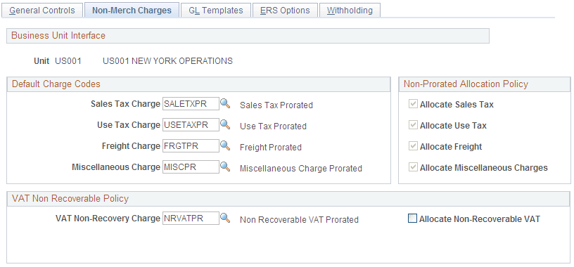

Procurement Control - Non-Merch Charges Page
Use the Procurement Control - Non-Merch Charges (procurement control - nonmerchandise charges) page (BUS_UNIT_INTFC3) to define proration, allocation, and expensing options for nonmerchandise charges.
Navigation:
Set Up Financials/Supply Chain, and then Business Unit Related, and then Procurement, and then Procurement Control, and then Non-Merch Charges
This example illustrates the fields and controls on the Procurement Control - Non-Merch Charges page.
Proration and Allocation of Nonmerchandise Charges
To understand the options on this page, you need to understand how proration and allocation of nonmerchandise amounts work.
During voucher entry, nonmerchandise amounts are prorated to each distribution line based on some ratio of total expense to the merchandise or other value on the distribution lines of the voucher, or they are not prorated. This depends on the charge code, which you set up in the Misc Charge/Landed Cost Defn (miscellaneous charge/landed cost definition) component (CM_LC_COMPONENT). If non merchandise amounts are not prorated, you can specify on the Procurement Control - Non-Merch Charges page whether to allocate them to separate accounting lines or to record them to summary expense accounts. This table describes what happens when you prorate, allocate, or expense (neither prorate or allocate) nonmerchandise charges:
Action Result
Prorate
Records the prorated amount along with the merchandise amounts on the distribution line.
If you prorate nonmerchandise amounts, the amounts charged to the distribution lines are added to merchandise amounts on the distribution lines, and the total is posted to the distribution ChartFields.
Allocate
Creates separate accounting entries for the nonmerchandise amount for the distribution line.
If you allocate nonmerchandise amounts, the amounts charged to the distribution lines are posted to the appropriate nonmerchandise accounts from the accounting template, and the other ChartField values are based on the inheritance rules. ChartField inheritance is defined at the ledger group level and on the ChartField Inheritance page.
Expense (non-prorate/non-allocate)
Records the amounts to summary expense accounts.
If you use summary control posting, you have two options for nonprorated charges. You can either expense the charges at the header, or allocate them to the distribution lines. You allocate them by selecting the Allocate check box on the Non-Merch Charges page in the Procurement Accounting Controls component.
If you use detail offset posting, you have only one option for nonprorated charges. You must allocate them. For this reason, the Allocate check box is selected and unavailable for entry on the Non-Merch Charges page in the Procurement Accounting Controls component.
Default Nonmerchandise Charge Codes
Use the fields in this group box to set the defaults for the nonmerchandise charges on the voucher. The charge codes that you select here are automatically populated in the vouchers that you create for the business unit. They determine where the nonmerchandise amounts are charged.
Each of the fields in this group box has a drop-down list box that displays the available charge codes for that nonmerchandise charge. You define the codes for these nonmerchandise charges on the Misc Charge/Landed Cost Definition page. When you select a charge code, you define the proration. The available charge codes are prorated (PR) or not prorated (NP), unless you have defined more charge codes on the Misc Charge/Landed Cost Definition page.
The charge codes that you select here are only defaults. You can override these charge codes on the voucher itself.
Non-Prorated Allocation Policy
The fields in this group box determine whether a nonprorated nonmerchandise charge is allocated or charged as a nonprorated expense for a particular general ledger business unit.
If you use detail offset posting, this check box is automatically selected and display-only because you cannot expense nonmerchandise amounts with detail offset posting.
If you use summary control posting, you can select this check box to allocate the nonmerchandise charges to the distribution line, or you can deselect the check box to expense the charges to the header.
Unlike the charge codes, the allocation options cannot be overridden at voucher creation time. If you select a nonprorate option as the default here or on the voucher, the system uses the allocation option that you select here to either allocate or expense the nonmerchandise amount.
Allocate Sales Tax
Select to have the system create separate accounting entries for nonprorated sales tax amounts for the distribution line; the appropriate ChartFields are inherited.
Allocate Use Tax
Select to have the system create separate accounting entries for nonprorated use tax amounts for the distribution line; the appropriate ChartFields are inherited.
Allocate Freight
Select to have the system create separate accounting entries for nonprorated freight amounts for the distribution line; the appropriate ChartFields are inherited.
Allocate Miscellaneous Charges
Select to have the system create separate accounting entries for nonprorated miscellaneous charge amounts for the distribution line; the appropriate ChartFields are inherited.
VAT Non Recoverable Policy
Use the fields in this group box to set the defaults for the nonrecoverable VAT charges on the voucher. The charge code that you select here automatically appears on the vouchers that you create for the business unit. You can override it on the voucher.
VAT Non-Recovery Charge
Select from the delivered options or additional charge codes that you define on the Misc Charge/Landed Cost Definition page. Options are:
NRVATNP (do not prorate nonrecoverable VAT): Nonrecoverable (taxable) VAT is not prorated to the distribution line ChartFields.
NRVATPR (prorate nonrecoverable VAT): Nonrecoverable VAT is prorated to the ChartFields on the distribution line.
Allocate Non-Recoverable VAT
Select to have the system create separate accounting entries for the nonrecoverable VAT amount for the distribution line. This check box applies only to nonprorated nonrecoverable VAT charge codes.
The VAT nonrecoverable amount is posted to the account defined on the VAT accounting template (VAT Code - Accounting Information page), and the other ChartField values appear automatically based on the ChartField inheritance rules.
If you are using summary control posting and you want to expense nonprorated nonrecoverable VAT charges at the voucher header, then do not select this check box.
You can override this option when creating vouchers.
Use the Procurement Control - GL Templates (procurement control - general ledger templates) page (BUS_UNIT_INTFC6) to specify the payables journal templates.
Navigation:
Set Up Financials/Supply Chain, and then Business Unit Related, and then Procurement, and then Procurement Control, and then GL Templates
This example illustrates the fields and controls on the Procurement Control - GL Templates page. You can find definitions for the fields and controls later on this page.
Payables Journal Templates
Specify the PeopleSoft Payables journal templates to use for the general ledger business unit. These templates define the summarization rules for creating journals that are passed to the general ledger. The PeopleSoft Payables system creates one journal each for accruals, payments, payment cancellations, manual closures, revaluations, and cash clearings; you must specify a different journal template for each.
Purchasing Journal Templates
Receipt Accrual
Select the journal template to use for receipt accrual in PeopleSoft Purchasing. The standard template that is provided for receipt accrual is REC_ACCRUE.
Use the Procurement Control - ERS Options (procurement control - evaluated receipt settlement options) page (BUS_UNIT_INTFC5) to enable ERS processing for the general ledger business unit and select the self-billed invoice (SBI) document option.
Navigation:
Set Up Financials/Supply Chain, and then Business Unit Related, and then Procurement, and then Procurement Control, and then ERS Options
This example illustrates the fields and controls on the Procurement Control - ERS Options page. You can find definitions for the fields and controls later on this page.
ERS Option
ERS is a process by which the Voucher Build process builds vouchers from procurement receipt records. If you plan to use the Voucher Build process to create ERS vouchers for business units associated with this general ledger business unit, then you need to set the ERS option to Allow ERS.
ERS Invoice Date Option
Select the method that the system uses to create the ERS voucher invoice date. Options are:
Frt Terms (freight terms): The freight terms determine whether to use the receipt or the shipment date as the invoice date.
Recv Date (receiver date): The system uses the receiver data.
SBI Numbering Options
Select to define how the system groups SBIs. Options are:
Group Vouchers (Auto-Num) (group [auto-number]): The system groups ERS vouchers in a single SBI voucher.
Individual Vchr - Invoice Number (individual voucher - invoice number): The SBI contains information from only a single voucher. The system generates the SBI number by combining the invoice number with the ERS sequence number.
Individual Voucher (Auto-Num) (individual voucher [auto-number]): The SBI contains information from only a single voucher. The system assigns the next available SBI number based on the invoicing location.
ERS Tax Type
Select to indicate the type of tax to which the vouchers are subject. Options are No Taxes, Sales Tax, Use Tax, and VAT.
Use the Procurement Control - Withholding page (BU_WTHD_JUR) to specify general ledger business unit withholding setup options.
Navigation:
Set Up Financials/Supply Chain, and then Business Unit Related, and then Procurement, and then Procurement Control, and then Withholding
This example illustrates the fields and controls on the Procurement Control - Withholding page. You can find definitions for the fields and controls later on this page.
Specify the general ledger business unit's relationship to the various withholding entities for whom you withhold. These tax authorities use this information to determine your relationship with them. Enter the applicable information for each combination of withholding entity, type, jurisdiction, and business unit category.
The withholding entity and class information is related to the information defined on the Withholding Entity page. Therefore, the effective date used on this page must be greater than or equal to the effective date on the Withholding Entity page.
Collection Agent Flag
Select if you are a collection agent for the entity.
Last Certificate Number
Enter the last certificate number for the entity.
(ARG) Codigo DGR
Used exclusively in Argentina. This field is for information purposes only and does not trigger any action.
ChartFields
Click to access the Withholding ChartFields page to set up accounting parameters.
Use the Withholding ChartFields page (WTHD_BU_CF) to set up accounting ChartField parameters.
Navigation:
Click the ChartFields link on the Procurement Control - Withholding page.
This example illustrates the fields and controls on the Withholding ChartFields page. You can find definitions for the fields and controls later on this page.
Because withholding ChartFields are defined at the business unit level, you can specify ChartFields for every withholding entity, type, and jurisdiction.
For each withholding class, you must specify the account ChartField. The system displays an error message upon saving if you have not populated the Account field.
Withholding Class
Displays the withholding classes defined for the withholding entity, type, and jurisdiction. The system automatically populates this field based on what you define on the Withholding Entity page. You can delete a withholding class if you have deleted the class on the Withholding Entity page. Otherwise, the delete button is not available.
Note: When you add a new withholding class for an entity on the Withholding Entity page, the system populates this page with the new withholding class. The system populates the Account field with the account for the minimum withholding class of the entity. If the system is unable to determine a valid account, you must manually insert the account on this page. For example, you define account 230000 for withholding class 01 and account 235000 for withholding class 02. When you add a new withholding class 03 on the Withholding Entity page, the system populates the account with 230000 for the withholding class 03 on the Withholding ChartFields page (the account defined for the minimum withholding class, in this example, 01). When you delete a withholding class for an entity on the Withholding Entity page, the system displays a warning message stating that you must delete the withholding class from the Procurement Control - Withholding page as well.
Account
Select the account to be used as the withholding liability account in general ledger. This field is required. You can also select the ChartFields associated with the account you selected, as appropriate.
Note: The account is based on the TableSet control of the business unit rather than the SetID of the withholding entity.
