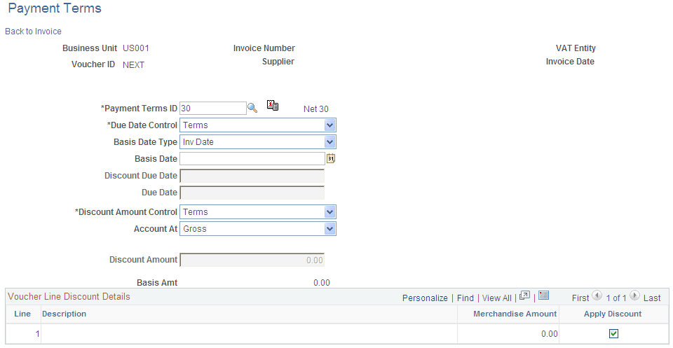

Payment Terms Page
VCHR_TERMS_EXP
View or change the default payment and discount terms for the voucher.

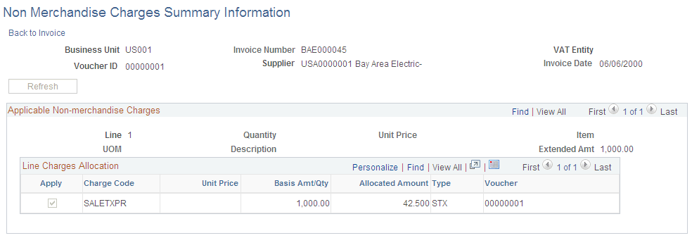

Non Merchandise Charges Summary Information Page
VCHR_LINE_MISC_CHG
View the miscellaneous amounts that are allocated to each voucher line. On this page, you can also change the allocation for a particular voucher.

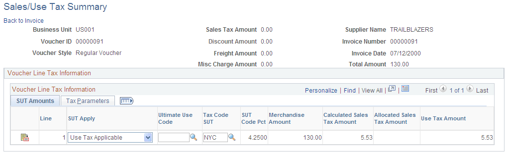

Sales/Use Tax Summary Page
AP_SUT_SUMM_PG
Review the sales and use tax information for all the voucher lines, and if applicable, modify tax information.

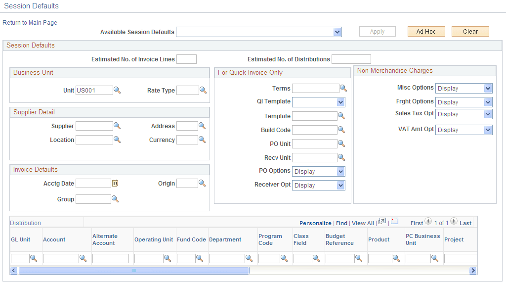

Session Defaults Page
AP_SESSN_DFLT_SEC
Enter voucher defaults for an ad hoc session, or use an existing available session default. These defaults override the values that the system applies using the PeopleSoft Payables control hierarchy.

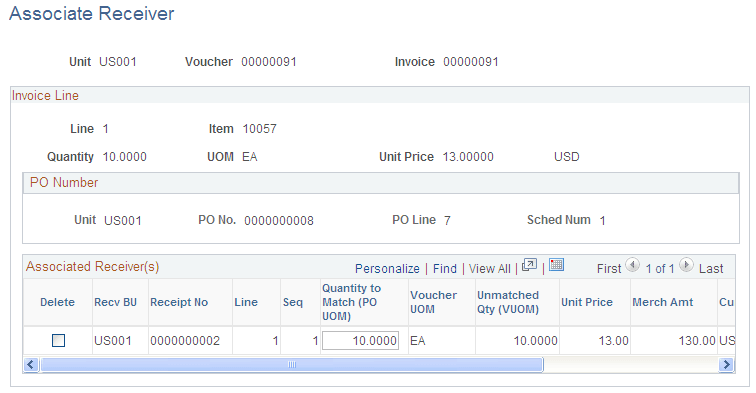

Associate Receiver Page
VCHR_RECV_MTCH
Edit any of the receiver lines that are associated with the voucher line and delete a receiver line.

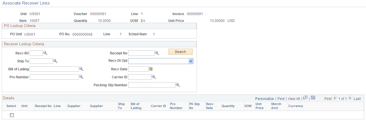

Associate Receiver Lines Page
RECEIVER_LOOKUP
Manually associate receiver lines with the voucher line for matching.

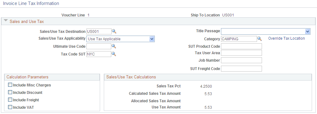

Invoice Line Tax Information Page
VCHR_LINE_TAX
Review and, if applicable, override tax settings for the voucher line.

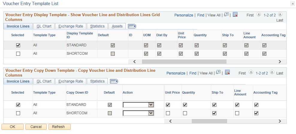

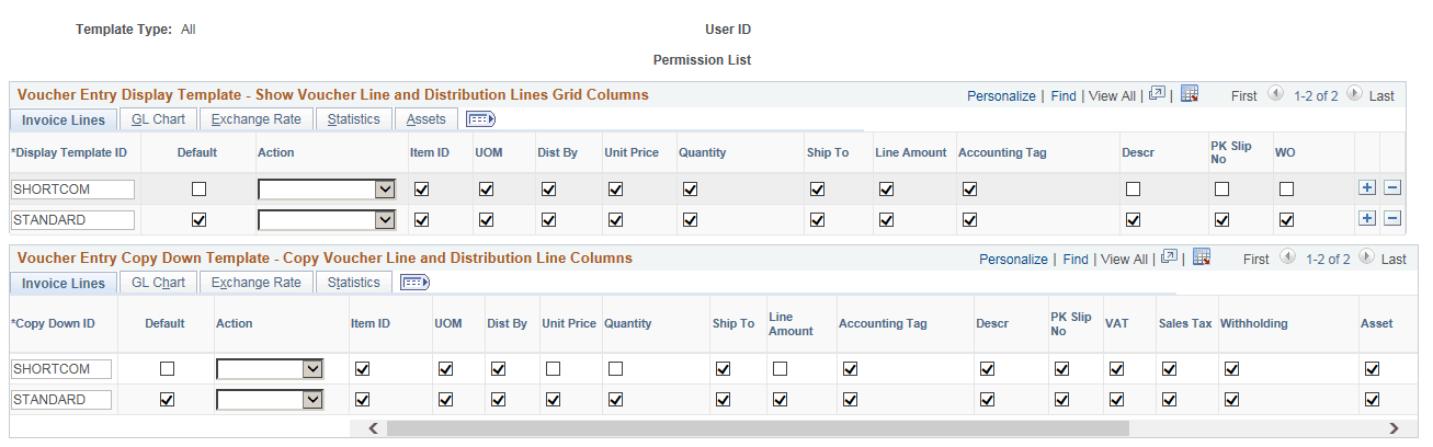

Voucher Entry Template List Page
AP_VCHR_ENTRY_TMPL
Displays a list of Display and Copy Down Templates that are available for the user based on the user permissions.

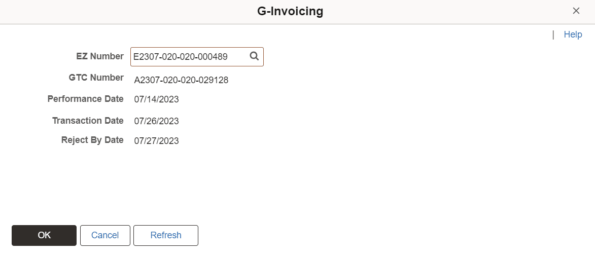

G-Invoicing Page
AP_VCHR_EZ_PNL_SEC
Add the EZ Number and the other fields GTC Number, Performance Date, Transaction Date, and Reject by Date will be defaulted for Federal EZ invoices.

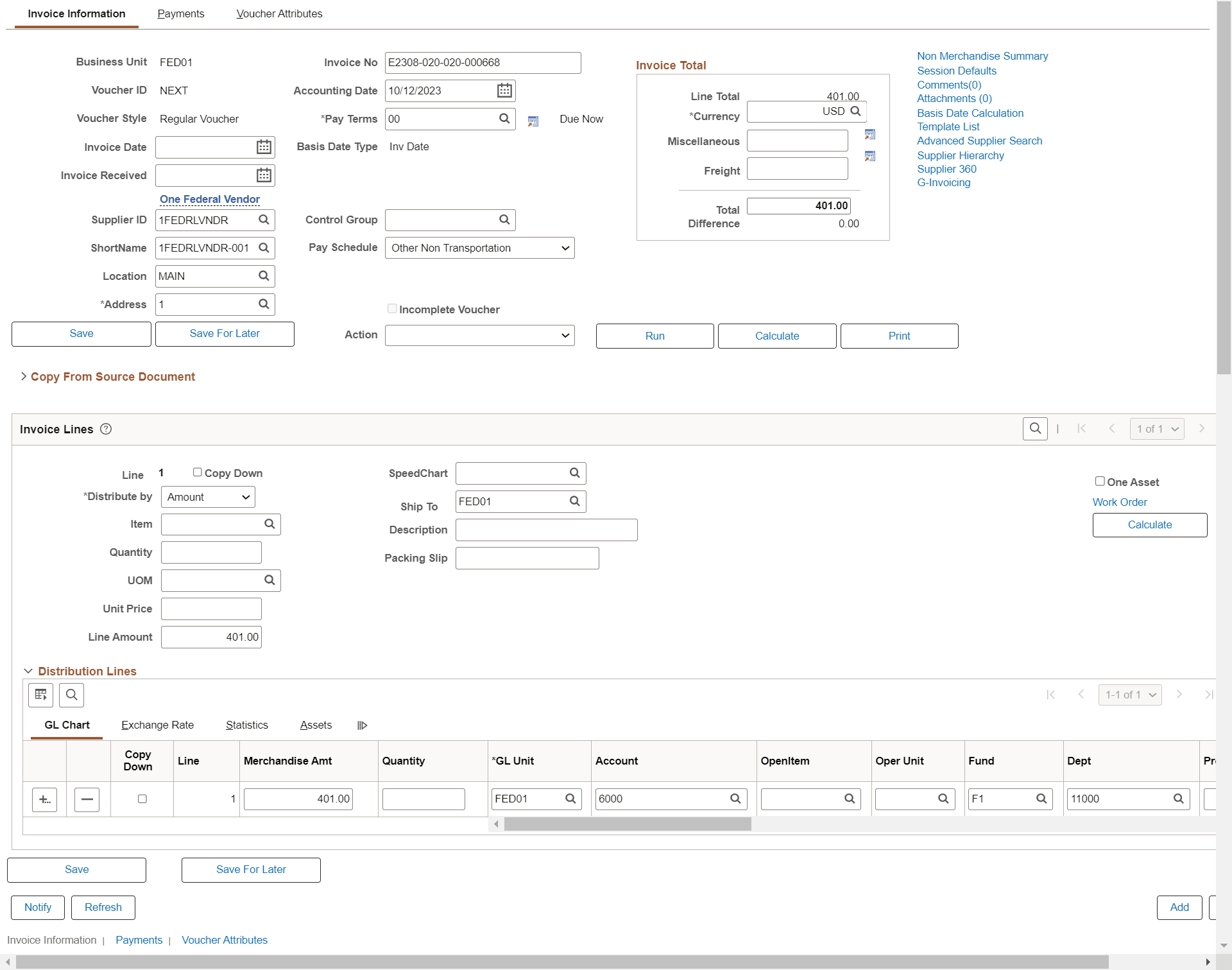

Invoice Information Page
Use the Invoice Information page (VCHR_EXPRESS1) to enter or view invoice information, including invoice header information, nonmerchandise charges, and voucher line and distribution information.
Navigation:
Accounts Payable, and then Vouchers, and then Add/Update, and then Regular Entry, and then Invoice Information
This example illustrates the fields and controls on the Invoice Information page for regular voucher style, add mode (1 of 2). You can find definitions for the fields and controls later on this page.
Regular Vouchers Invoice Information

Use Tax
Displays the calculated use tax. The system calculates the use tax either from:
  • A use tax code that is entered on the Invoice Line Tax Information page.
  • The difference between the sales tax that is entered on the voucher header and the sales tax that is entered or calculated for the voucher lines if the voucher lines are tax applicable but the header sales tax amount is less than the total for the lines.
Click the Transfer to Use Tax Detail icon to access the Use Tax Charges page, where you can specify how to allocate the use tax charges.
See Miscellaneous Charges Page.
See Invoice Line Tax Information Page.

Pay Terms
Select the payment terms. These terms are supplied from the PeopleSoft Payables default hierarchy. Click the Transfer to Pay Terms Detail button to access the Payment Terms page, where you can override the defaults or change associated information.
Basis Date Type
Displays the basis date type which controls the basis date on which the payment terms are based. You can override the basis date type on the Payment Terms page.

Non Merchandise Summary
Click to access the Non Merchandise Charges Summary Information page, where you can view the miscellaneous amount that is allocated to each voucher line for each charge code. This page is useful only after you enter or copy voucher line information.
Session Defaults
Click to access the Session Defaults page, where you can select existing available session defaults or set ad hoc default values for all of the invoices that you enter in the current session. These defaults override the defaults that the system applies using the PeopleSoft Payables control hierarchy.
Click to access the Sales/Use Tax Summary page, where you can review and modify, if applicable, the SUT information for all the voucher lines.

The Action Field
When you have finished entering your voucher and saved it, you have three options for processing your voucher:
  1. Perform budget-checking, matching, document tolerance checking, asset loading, posting, and journal generation on this and other vouchers in batch from the batch request pages for those processes.
  2. Process the voucher on demand, directly from the Invoice Information page, using the Action field.
  3. Process this and other vouchers in batch from the Voucher On-Demand Processes batch request page using on-demand process groups.
The first option is generally the most efficient, but the second option is useful when you must process a voucher immediately, on demand. The third option is convenient when you want to perform multiple sequential processes, such as matching, asset loading, voucher posting, and journal generation, on a batch of vouchers.
If you want to process a voucher on demand from the Invoice Information page:
  1. Save the voucher.
  2. Select an on-demand process group in the Action field.
  3. Click Run to initiate processing.

You cannot add more than one line while creating a voucher for Federal G-Invoicing EZ invoice.

Field or Control Description
Copy Down
Select this check box to allow the fields in the voucher line to be copied. The user can copy information from selected voucher line and distribution line to other voucher lines.
The Copy Down check box on the Invoice Line is disabled if:
  • The voucher has been posted.
  • The voucher has been applied to prepayments.
  • The voucher is closed.
  • The voucher has posted payments.
  • The voucher is in verified control group.
  • The voucher is matched.
Distribute by
Select a distribution method:
Amount: You must enter the merchandise extended amount for the voucher line. You can also enter the quantity, unit price, and unit of measure (UOM) on the voucher line and a quantity on the distribution line for informational purposes only.
If you change the value in the merchandise Extended Amount field, the Unit Price field is recalculated.
Note: Any changes in the extended amount will be reflected in the distribution. The system adjusts the distribution line that has the maximum distribution line number. If you reduce the amount below the original PO amount, then the only adjustment is to set the amount to zero on the distribution line that has the maximum distribution line number. In this case, you must still adjust the distribution amounts so that they tie back to the voucher line amount. In addition, any change to the merchandise amount will be accompanied by a corresponding change to unit price. If the original distribution method on the purchase order was quantity and you change the method to amount, then the distribution as well as the voucher line information remains unchanged. Even under the amount distribution method, the voucher line quantity should equal the sum of the distribution line quantity. If they are not equal, then an error message is issued.
Quantity: The system calculates the merchandise amount on the invoice lines and distribution lines based on the quantity and unit price. You must enter the quantity, unit price, and UOM. The Extended Amount field is not available for entry.
Select the Force Price option if you want to force the unit price based on the entered merchandise amount. This option is described subsequently.
Note: If you change voucher line quantity, the system does not adjust the distribution lines in response. Therefore, if you change the voucher line quantity, you must adjust the corresponding distribution level quantity. A validation exists to check whether the voucher line quantity is equal to the sum of distribution quantities. In addition, if you change the quantity on the copy worksheet (either PO or receiver), then the changed quantity is copied onto the voucher line, whereas the distribution still retains the original PO quantity. You should manually adjust the distribution quantity such that the sum of the distribution quantity equals the voucher line quantity. If the original distribution method on the purchase order was amount and if you change the method to quantity, then the system recalculates the distribution amounts using the quantity on the distribution line and the unit price on the voucher line. An option also exists of forcing the price that is available under this method. Selecting this option will force the system to calculate the price based on the extended amount. When you select this option, the unit price field is not available.

Sales/Use Tax
Click to access the Invoice Line Tax Information page, where you can override the default tax settings for the voucher line.

Associate Receiver(s)
Click to access the Associate Receiver page and Associate Receiver Lines page, where you can manually associate individual receivers with the voucher line for three-way matching. This link is active only if you have copied purchase order or receiver information onto the voucher using the Copy Worksheet Option field and the purchase order requires matching, or if the supplier is set up for receipt-only matching.
See Understanding the Matching Process.

Distribution Lines
For each voucher line that you enter, you must also enter the distribution information in the Distribution Lines grid. Each voucher line must have one or more distribution lines. You can select the Copy Down check box on a distribution line to copy that line's general ledger business unit and ChartField values to new distribution lines.
You cannot enter or adjust distribution lines after a voucher has been payment posted.

GL Chart Tab
Fields on this tab that are not documented here are optional ChartFields that are delivered with PeopleSoft Payables. They share the same validation error processing when you save the voucher as do the fields described here.
Important:
ChartFields that appear here depend on how you configure options on the Standard Chartfield Configuration page.
See Application Fundamentals: Standard ChartField Configuration Page.
Copy Down
Select the check box on a distribution line and click the Insert Row button to copy that line's general ledger business unit and ChartField values to new distribution lines. If multiple distribution lines are selected, the system will issue a warning and arbitrarily select the ChartField values from one of the selected lines to populate the new lines. If no line is selected, only the default general ledger business unit will be populated.
Note: Selecting the Copy Down check box at distribution line is ignored during copy down from the voucher line.

Payment Terms Page
Use the Payment Terms page (VCHR_TERMS_EXP) to view or change the default payment and discount terms for the voucher.
Navigation:
Click the Transfer to Pay Terms Detail button on the Invoice Information page.
This example illustrates the fields and controls on the Payment Terms page. You can find definitions for the fields and controls later on this page.
Payment Terms page
Payment Terms ID
Controls how the voucher is paid, including the discount date and discount amount. PeopleSoft Payables supports both single and multipayment (installment) terms. You define payment terms on the Payment Terms - Multi Payment page or the Payment Terms - Single Payment page. The default setting on the voucher is based on the payment terms that are established for the supplier location for this voucher.
Multipayment terms generate multiple scheduled payment records when you save the voucher by allocating the total payment amount for the voucher over these scheduled payments, according to the percentages that are established in the terms definition.
With multipayment terms, you can also generate installment payment records (and review them and edit them, if necessary) in advance of committing them by saving the voucher. You can always edit the voucher immediately after saving, but this alternate method may offer more peace of mind.
Schedule Payments
Click the Schedule Payments icon to generate payment records in advance of saving the voucher. For multipayment terms, this prepopulates multiple schedule payment records (installments). For single payment terms, this calculates and supplies the net due date, the discount amount, and the discount due date if the terms are discount-applicable. You can also do this by clicking the Schedule Payment button on the Payments page.
Due Date Control
Either accept the default due dates, or enter user-specified amounts. Select from:
Terms: This is the default setting. When you select this value, the Basis Dt Type (basis date type) field is available for entry, but the Discount Due Date and Due Date fields are not. If the Due Date Control field is specified as Terms, then the scheduled due dates and net due dates are determined by the payment term specified.
User: When you select this value, the Discount Due Date and Due Date fields are available for entry and you can modify them. The Basis Dt Type field is unavailable for entry. If the Due Date Control field is set to User, then the date is derived from the Due Date field.
Enter the date for the system to use to calculate the discount due date and payment due date for the voucher. This field controls the basis date on which the payment terms are based.
Values are:
Acct Date (account date): The accounting date determines the payment basis date.
Doc Date (document date): The date that the voucher is entered, which determines the payment basis date. If you select this value, the document date appears in the Basis Date field.
Inv Date (invoice date): The invoice date determines the payment basis date.
Recpt Date (receipt date): The receipt date determines the payment basis date.
Ship Date: The ship date determines the payment basis date.
User Date: The user-defined date that is entered in the Basis Date field determines the payment basis date.
Note: Just because you can select an alternate basis date source does not necessarily guarantee that the particular date is currently available for the voucher. For example, the receipt date and ship date values would typically be available only if the invoice had first been matched to the purchase order, the receiver, or both. If you select a basis date value for which no corresponding date value is populated, a warning appears asking whether you want to use the invoice date as the override basis date. If you select Yes, you can save the voucher and generate scheduled payment data. Until a voucher is posted or paid, you can always update the voucher for the intended basis date if it becomes available.
Basis Date
Displays the date used to calculate the discount due date and payment due date for the voucher. The system populates the date based on the basis date type. If the basis date type is User Date, this field is available and the system requires that you enter a date.
This basis date is not the same as the federal payment basis date on the Date Calculation page.
Discount Due Date
If you select User in the Due Date Control field, enter a discount due date.
Due Date
If you select User in the Due Date Control field, enter a due date.
Discount Amount Control
Accept the default discount amounts or enter user-specified amounts. Values are:
Terms: This is the default setting. When you select this value, the Account At field is available for entry but the Discount Amount field is not.
User: When you select this value, the Discount Amount field is available for entry and you can enter the amount for the discount in the Discount Amount field.
Account At
Determines whether the discount is accounted at gross or net. Values are:
Net: Any discounts not taken are accounted for as discounts lost.
Gross: Any discounts taken are accounted for as discounts earned.
Basis Amt (basis amount)
Displays the amount upon which the discount is calculated. This amount is the total of the merchandise amount for each line with the Apply Discount check box selected.
Discount Amount
If you select User in the Discount Amount Control field, enter a discount amount.
Apply Discount
Select to make individual voucher lines discount-applicable.
Payment terms for a third-party voucher cannot include a discount. For third-party vouchers, the payment terms are supplied by default from the Prepay/Third/Claim Pay Terms option that is selected for the SetID on the Payables Options - Payment Options page.
Use the Non Merchandise Charges Summary Information page (VCHR_LINE_MISC_CHG) to view the miscellaneous amounts that are allocated to each voucher line.
Navigation:
Click the Non Merchandise Summary link on the Invoice Information page.
This example illustrates the fields and controls on the Non Merchandise Charges Summary Information page. You can find definitions for the fields and controls later on this page.
Refresh
Click to reallocate the unapplied amount to the other voucher lines.
Apply
Deselect this option to remove a particular charge for a given voucher line.
Use the Associate Receiver page (VCHR_RECV_MTCH) to edit any of the receiver lines that are associated with the voucher line and delete a receiver line.
Navigation:
Click the Associate Receiver(s) link in the Invoice Lines group box on the Invoice Information page.
This example illustrates the fields and controls on the Associate Receiver page. You can find definitions for the fields and controls later on this page.
Amt Only (amount only)
Appears as checked if the purchase order is an amount-only PO. For amount-only POs, you can modify the Merch Amt (merchandise amount) field, but you cannot modify the Quantity to Match (PO UOM) field.
Delete
Manually delete receiver lines that are associated with the voucher line by deleting a row. This field does not appear when you are creating adjustment or reversal vouchers.
Quantity to Match (PO UOM) (quantity to match, purchase order unit of measure)
Edit the quantity in the purchase order unit of measure to be matched for any of the receiver lines that are currently associated with the voucher line. You cannot modify this field if the receiver is associated with an amount-only PO.
Note: A warning message appears if the sum of the quantity to be matched does not equal the voucher line quantity.
Enter the merchandise amount for amount-only POs to be matched for any of the receiver lines that are currently associated with the voucher line.
Merchandise Amount Received
Displays the amount received for the receiver line.
Click to access the Associate Receiver Lines page, where you can manually associate receivers with the voucher line for matching. This link does not appear when you are creating adjustment or reversal vouchers.
Use the Associate Receiver Lines page (RECEIVER_LOOKUP) to manually associate receiver lines with the voucher line for matching.
Navigation:
Click the Associate Receiver Lines link on the Associate Receiver page.
This example illustrates the fields and controls on the Associate Receiver Lines page. You can find definitions for the fields and controls later on this page.
Using the search function that is provided, you can display all receivers that are related to the purchase order schedule line that is specified on the voucher line.
Recv Dt Opt (receiver date option) and Recv Date (receiver date)
You can further narrow your search by selecting from the following values and then specifying a receiver date:
<=: The system searches for receivers that are dated before or on the date that is specified in the Recv Date field.
=: The system searches for receivers with a date that is equal to the date that is specified in the Recv Date field.
>=: The system searches for receivers that are dated after or on the date that is specified in the Recv Date field.
No Date: The date of the receiver is not included in the search. This is the default setting.
Search
When you have entered the search criteria, click this button and the system returns all receivers that are related to the specified search criteria and the purchase order on the voucher line.
Select
Select the receiver or receivers that you want to associate with the voucher line, and click OK. The system associates the selected receiver or receivers' details with the voucher to be used when matching the voucher.
Use the Sales/Use Tax Summary page (AP_SUT_SUMM_PG) to review the sales and use tax information for all the voucher lines, and if applicable, modify tax information.
Navigation:
Click the Sales/Use Tax Summary link on the Invoice Information page.
This example illustrates the fields and controls on the Sales/Use Tax Summary page. You can find definitions for the fields and controls later on this page.
The Sales/Use Tax Summary page provides tax details by line for the voucher. The fields on this page display values that are either passed to the voucher line through the PeopleSoft Payables default hierarchy or inherited from the purchase order. You can enter override tax values for each voucher line or you can access the Invoice Line Tax Information page to view additional details and override tax values.
This page includes different fields from those described here if you have installed and enabled a third-party tax application, such as Taxware or Vertex.
See Sales/Use Tax Summary Page.
SUT Amounts
Displays the merchandise amount and calculated tax amounts for each line.
Click to access the Invoice Line Tax Information page to review detailed tax information for this voucher line.
SUT Apply (apply sales and use tax)
Indicates the tax that applies to the tax destination. Values are:
Direct Pay: Select if you do not want sales tax calculated. The system treats a direct pay line as a use tax line, except that it uses a different value for tax applicability.
Item is Exempt: Select if the line is exempt from sales and use tax.
Purchaser is Exonerated: Select if the purchaser does not have to pay sales or use tax.
Sales Tax Appl (sales tax applicable): Select to calculate and apply sales tax to the line. Enter the gross sales tax amount on the voucher header.
Use Tax Appl (use tax applicable): Select to calculate and apply use tax to the line. Do not enter the tax amount on the voucher header.
Ultimate Use Code
Enter an ultimate use code to override the default tax rate for a line.
Tax Code SUT (sales and use tax code)
Enter the tax code for the line. A tax code consists of a group of tax authorities. For example, if a certain locality has a city tax, county tax, and state tax, you can create three tax authorities and group them into a single tax code.
Tax Parameters
Fields displayed when you select the Tax Parameters tab are discussed in detail in the following section.
Use the Invoice Line Tax Information page (VCHR_LINE_TAX) to review and, if applicable, override tax settings for the voucher line.
Navigation:
Click the Sales/Use Tax link in the Invoice Lines group box on the Invoice Information page.
This example illustrates the fields and controls on the Invoice Line Tax Information page. You can find definitions for the fields and controls later on this page.
Similar to the Sales/Use Tax Summary page, the fields on this page display values that are passed to the voucher line through the PeopleSoft Payables default hierarchy. If the voucher was created by copying a purchase order, purchase order values override the PeopleSoft Payables default hierarchy, so the voucher inherits sales and use tax data from the purchase order. When you create a new voucher, all of the fields on this page can be overridden for the voucher line.
See Managing Voucher Line Tax Information with Taxware and Vertex.
Sales/Use Tax Destination
Indicates the location for which a sales or use tax is applicable. This value is defined as a ship to location, but it does not have to be the same as the ship to location that is defined in the PeopleSoft Payables control hierarchy.
Sales/Use Tax Applicability
Direct Pay: The system handles a direct pay line as a use tax line, except that it uses a different value for tax applicability.
Exempt: The line is exempt from sales tax.
Exonerated: The purchaser is exonerated from sales tax.
Sales Tax: Apply sales tax. Enter the gross sales tax amount on the voucher header.
Note: If you copy a single purchase order line that has use tax applicability, and you enter sales tax on the voucher header, the system automatically changes the tax applicability for that voucher line to sales tax.
Use Tax: Apply use tax. Do not enter the tax amount on the voucher header.
Note: If you copy purchase order lines with sales tax applicability, and you do not enter sales tax on the voucher header, the system automatically changes the tax applicability for those voucher lines to use tax.
Ultimate Use Code
Enter a code to override the default tax rate that is based on the ship to location. This field is available for entry only if an ultimate use code is defined for the ship to location on the Ship To Sales/Use Tax Default page.
See Application Fundamentals: Ultimate Use Codes Page.
Enter the tax code that applies to this voucher line. A tax code consists of a group of tax authorities. The tax code that is supplied by default here depends on a number of factors.
See Understanding PeopleSoft-Only Sales and Use Tax Processing.
Calculation Parameters
Include Misc Charges (include miscellaneous charges)
Select to indicate that any additional charges must be taxed and added to the net-extended amount before the system calculates SUT.
Include Discount
Select to have the system calculate any applicable discount and subtract it from the net-extended amount before calculating SUT.
Note: If the discount is lost, the system does not automatically recalculate and adjust any tax amounts.
Include Freight
Select to indicate that any freight amount must be taxed and added to the net-extended amount before the system calculates SUT.
Include VAT
Select to indicate that any VAT amount must be taxed and added to the net-extended amount before the system calculates SUT.
The values in these fields are supplied by default from the tax code in a PeopleSoft-only tax calculation environment and from the ship to location if you are using a third-party tax application.
To access the GeoCodes and Addresses Page, click the Override Tax Location link on the Invoice Line Tax Information page.
Use the Session Defaults page (AP_SESSN_DFLT_SEC) to enter voucher defaults for an ad hoc session, or use an existing available session default.
Navigation:
Click the Session Defaults link on the Invoice Information page.
This example illustrates the fields and controls on the Session Defaults page. You can find definitions for the fields and controls later on this page.
Session defaults are available for the Journal Voucher, Regular Voucher, Single Payment Voucher, and Template Voucher styles.
This page is similar to the page that you use to predefine session defaults. You can select existing available session defaults or set ad hoc default values for all of the invoices that you enter in the current session. These defaults override the defaults that the system applies using the PeopleSoft Payables control hierarchy. Only fields that are particular to this page or act in ways that are particular to this page are documented here.
See PeopleSoft Source to Settle Common Information: Defining Voucher Session Defaults.
Available Session Defaults
Select an existing session default to use in the current session. When you select an option, the system supplies the predefined default attributes and the Apply button is activated.
Note: You can use the predefined attributes or modify them. However, if you modify the attributes, they are available only for the current session. To retain these attributes, you must use the Session Defaults page. Select Set Up Financials/Supply Chain, and then Product Related, and then Procurement Options, and then Vouchers, and then Session Defaults.
Apply
Click to apply the predefined session default attributes in your current session. This button is active if you select an available session default.
Ad Hoc
Enter default attributes, and then click the Ad Hoc button to apply these default attributes in your current session. Also, click this button if you select an existing session default and modify the attributes.
Clear
Click to deselect the current session defaults. This applies only to the ad hoc default attributes. You cannot clear the predefined session defaults from this page.
You must click either the Apply button or theAd Hoc button to use session defaults in your current session. Your session remains current until you sign out.
Use the Voucher Entry Template List page to view the list of Display and Copy Down Templates that are available for the user based on the user permissions.
Navigation:
Click the Template List link on the Invoice Information page. The Template List link on the Voucher Header and the Copy Down check box on the Invoice Line is displayed only for the following Voucher Styles; Regular Voucher (REG), Single Payment Voucher (SGLP), Template Voucher (TMPL), Journal Voucher (JRNL) and Amortization Voucher (AMR).
This example illustrates the fields and controls on the Voucher Entry Template List page.
Vocuher Entry Template List page
The Accounting Tag field on this page is available in place of SpeedChart if Use Accounting Tag check box is selected in the Accounting Tag Registration component for Payables product. The Template Voucher distribution lines can be populated as per the Accounting Tag defined. If you create a regular voucher copying from the Template voucher, the distribution lines will have the same ChartField values as the Template voucher.
See Application Fundamentals: Setting Up Accounting Tags
Selected
Indicates the template that is currently in use. A Template is selected as default. You can change the Display Template and the Copy Down Template that is selected.
For the Copy Down Template, you can temporarily change the Copy Down selections on the Voucher Entry Template List page for the current voucher. To save the copy down selection, you should change the selections on the Display and Copy Down Template page.
When you add a new voucher line, the fields that you selected on the Voucher Entry Copy Down Template will be copied to the new line from the selected voucher line. To select the voucher line, you have to select the Copy Down check box on the Invoice Information page. The purchasing information, receiver information and the Work Order related information are not copied down from the voucher line.
If a voucher is selected to be copied down, all the distribution line(s) under this voucher line will also be copied. Changes made to the original line will not change the value of a voucher line and/or distribution line that was copied down.
Sales/Use Tax, VAT invoice line, VAT distribution Line, and Withholding Information links are part of the copy down selection.
Use the Display and Copy Down Template page (AP_VCHR_TMPLT) to copy information from selected voucher line and distribution line to other voucher lines.
Navigation:
Set Up Financials/Supply Chain, and then Product Related, and then Procurement Options, and then Vouchers, and then Display and Copy Down Template
This example illustrates the fields and controls on the Display and Copy Down Template page. You can find definitions for the fields and controls later on this page.
The Accounting Tag field on this page is available in place of SpeedChart if “Use Accounting Tag” check box is selected in the Accounting Tag Registration component for Payables product.
Voucher Entry Display Template
The Display Template is used to specify which voucher line fields and distribution line columns are displayed on the Voucher Entry page.
Display Template ID
Enter the name of the Display Template.
Default
Select the check box if you want to use the Display Template as the default when you use a Voucher Entry page. Only one Display Template can be selected as the default value.
Note: If the user changes the selected Display Template, it will affect all the existing voucher lines.
Action
Use Action list to check or uncheck all the check boxes except the Default check box.
The Copy Down Template is used to specify which voucher line fields and distribution line columns are copied down from the selected voucher line.
Copy Down Template ID
Enter the name of the Copy Down Template.
Default
Select the check box if you want to use the Copy Down Template as the default when you use a Voucher Entry page. Only one Display Template can be selected as the default value.
Action
G-Invoicing Page
Use G-Invoicing page (AP_VCHR_EZ_PNL_SEC) to add the EZ Number and the other fields. GTC Number, Performance Date, Transaction Date, and Reject by Date will be defaulted for Federal EZ invoices.
Navigation:
Click the G-Invoicing link on the Invoice Information page.
This example illustrates the fields and controls on the G-Invoicing page. You can find definitions for the fields and controls later on this page.
Voucher G-Invoicing page
Enter or select the EZ number for which you want to create the voucher. All the other fields will be auto-populated from the selected EZ invoice.
