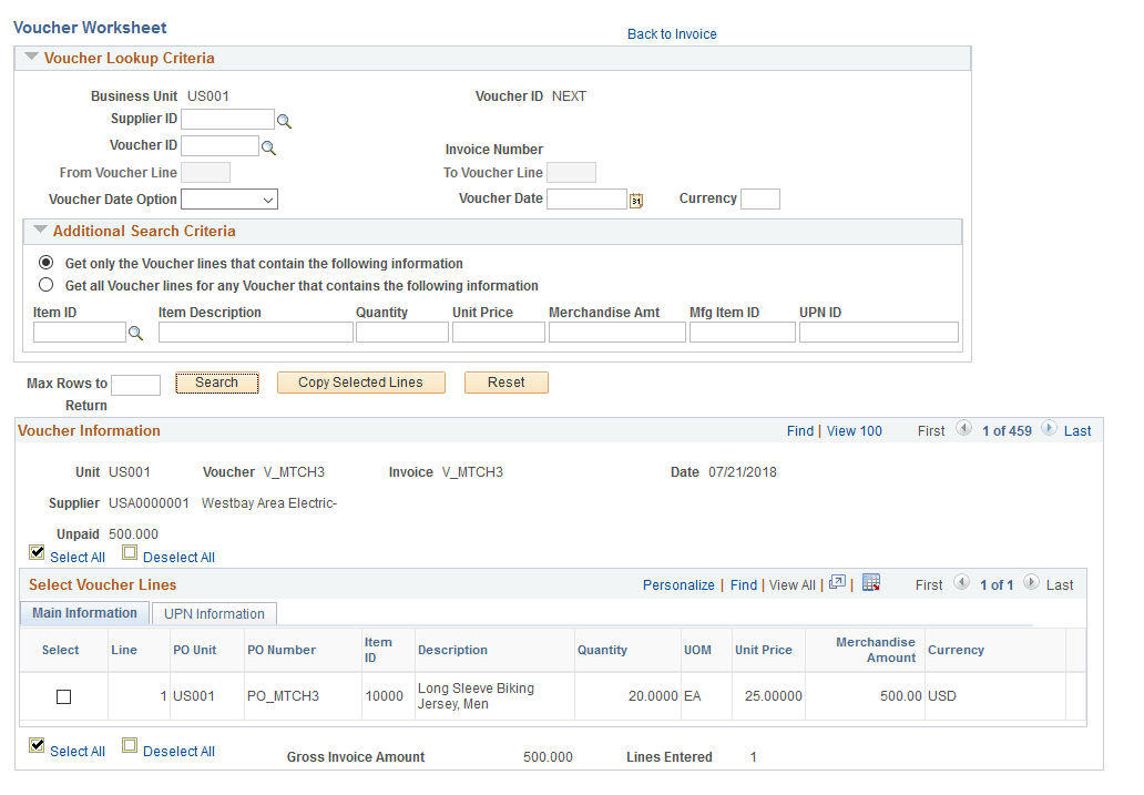

Voucher Worksheet Page
VCHR_TP_VCHR_WRK
Select the lines from one or more merchandise vouchers for the third-party voucher that you are entering. You can select this option only if you are creating template, third-party, adjustment, or reversal vouchers.

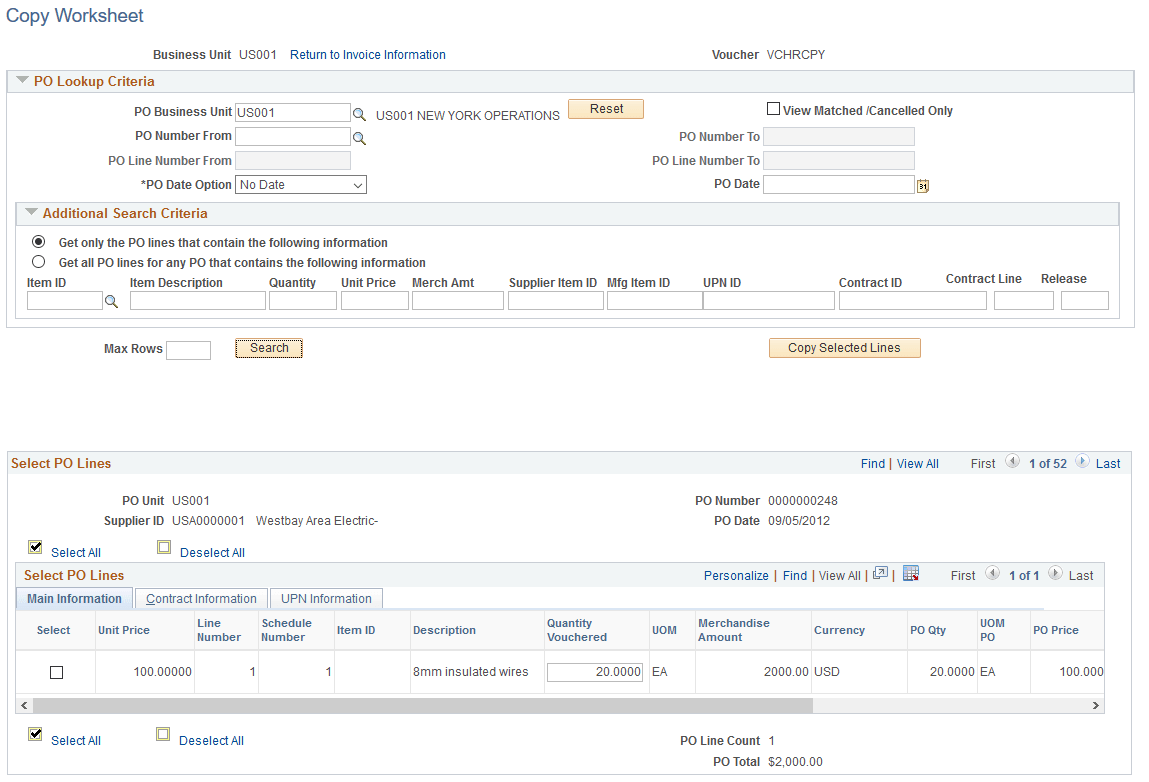

Copy Worksheet (purchase order) Page
Use the Copy Worksheet (purchase order) page (VCHR_LINE_PO_WRK) to select the lines from one or more purchase orders for copying to the Invoice Information page.
Navigation:
Select Purchase Order Only in the Copy From field on the Invoice Information page.
This example illustrates the fields and controls on the Copy Worksheet (purchase order) page. You can find definitions for the fields and controls later on this page.
To copy a purchase order, you can enter the PO unit and purchase order on the Invoice Information page and click Copy PO, or you can select Purchase Order Only in the Worksheet Copy Option field to access the Copy Worksheet page for purchase orders.
You cannot copy from a purchase order that is associated with a PCard transaction.
When you use the PO worksheet copy functionality, the system always uses the first listed PO to derive payment term information, regardless of whether you define only one PO or multiple POs. It does not derive payment term information from the PeopleSoft Payables default hierarchy.
PO Lookup Criteria
Field or Control Description
PO Business Unit (PeopleSoft Purchasing business unit)
Search for purchase orders by PeopleSoft Purchasing business unit. You must enter a PeopleSoft Purchasing business unit.
View Matched/Cancelled Only
Select to limit the search to include matched and canceled purchase orders only.
You must have authority to copy matched and canceled purchase orders. You set this up in Defining User Preferences.
Note: When you copy the PO to the voucher using this option and Commitment Control is enabled for Purchasing, only PO lines with a not finalized status (KK_CLOSE_FLAG <> "Y" on the purchase order distributions) are available to be copied to the voucher.
PO Number From (purchase order number from) and PO Number To (purchase order number to)
Enter a PO number in the PO Number From field to search for individual purchase orders. Search for a range of purchase orders by entering PO numbers in the PO Number From and the PO Number To fields. You must also enter a PeopleSoft Purchasing business unit.
PO Line Number From (purchase order line number from) and PO Line Number To (purchase order line number to)
Enter a PO line number in the PO Line Number From field to search for individual purchase order lines. Search for a range of purchase order lines by entering PO line numbers in the PO Line Number From and the PO Line Number To fields. You must also enter a PO number. These fields are not available if you select a range of PO numbers.
PO Date Option (purchase order date option) and PO Date (purchase order date)
Complete the PO Date Option field in conjunction with the PO Date field to limit your search to purchase orders that fall within a selected date range.
Additional Search Criteria
This section initially appears as collapsed; you must expand it to access these optional fields. You can specify additional criteria with PO lookup criteria or with only the PO business unit defined. However, any information that you define in this group box overrides the values that are specified in the PO Lookup Criteria group box.
Get only the PO lines that contain the following information
Select to include only the PO lines that contain the data that is specified in the additional search criteria. This field is set as the default.
Get all PO lines for any PO that contains the following information
Select to include all purchase order lines for purchase orders that contain the data that is specified in the additional search criteria.
Item ID, Item Description, Quantity, Unit Price, Merch Amt (merchandise amount), Supplier Item ID, Mfg Item ID (manufacturing item identification), UPN ID, Contract ID, Contract Line, orRelease Number
Enter data to refine your search. You can enter data in more than one field. When you search for quantity, unit price, or merchandise amount, you should also enter at least one of the following fields: Item ID or Item Description.
You can further refine your search using UPN ID.
Search and Copy
Search
Click Search to populate the Select PO Lines scroll area with the purchase orders that match your search criteria. This button is not available until you enter a PeopleSoft Purchasing business unit.
Copy Selected Lines
Click Copy Selected Lines to copy selected purchase-order lines onto the voucher. This field is not available until you select Search to display PO lines.
Note: If the Copy Matched and Closed PO option is selected for your user preferences and you create a voucher that references a PO that has a matched line (because an earlier voucher also referenced the PO) and an unmatched line, then when you copy the PO to the voucher, the matched PO line will be copied with both the amount and the quantity at zero.
Reset
Click to remove the Select PO Lines scroll area and clear selection criteria.
Select All
Click to select all of the lines for all purchase orders that are displayed.
Clear All
Click to clear all of the lines for all purchase orders that are displayed.
Select PO Lines
Select
Select individual purchase order lines by selecting this check box in the appropriate row.
Quantity Vouchered
Displays the quantity on the PO line. This field can be modified if the PO line is not an amount-only PO line. If you change the quantity that is vouchered, this value and the extended amount (quantity × unit price) are carried forward to the voucher line. However, you must change the distribution line manually on the Invoice Information page to match both the quantity and the extended amount.
Merchandise Amt (merchandise amount)
Displays the merchandise amount on the PO line. This field can be modified if the PO line is an amount-only PO line.
Select All
Click to select all of the lines for a single purchase order. Each purchase order that the system returns has a Select All button. You must click the button for each purchase order to select its lines.
Deselect All
Click to deselect all of the lines for a single purchase order. Each purchase order that the system returns has a Clear All button. You must click the button for each purchase order to deselect its lines.
UPN Information
Select the UPN tab to view the UPN details of an item.

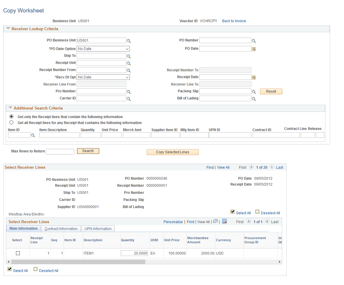

Copy Worksheet (receiver) Page
Use the Copy Worksheet (receiver) page (VCHR_LINE_RECV_WRK) to select the lines from one or more receivers for copying onto the Invoice Information page.
Navigation:
Select PO Receipt or Non PO Receipt in the Copy From field on the Invoice Information page.
This example illustrates the fields and controls on the Copy Worksheet (receiver) page. You can find definitions for the fields and controls later on this page.
You cannot copy from a receipt on a purchase order that is associated with a PCard transaction.
Receiver Lookup Criteria
Search for purchase orders by PeopleSoft Purchasing business unit. You must enter a PeopleSoft Purchasing business unit, a receiving business unit, or both.
Note: This field appears only if you selected PO Receipt in the Worksheet Copy Option field on the Invoice Information page.
PO Number
Enter a PO number to search for individual purchase orders. You must also enter a PeopleSoft Purchasing business unit.
PO Dt Opt (purchase order date option) and PO Date
Enter the PO date option in conjunction with the PO Date field to limit your search to purchase orders that fall within a selected date range.
Receipt Unit
Search for the receipts by receiving business unit. You must enter a PeopleSoft Purchasing business unit, a receiving business unit, or both.
Receipt Number From and Receipt Number To
Enter a receipt number in the Receipt Number From field to search for individual receipts. Search for a range of receipts by entering receipt numbers in the Receipt Number From and Receipt Number To fields. You must also enter a receiving business unit.
Receiver Line From and Line
Enter a receiver line number in the Receiver Line From field to search for individual receiver lines. Search for a range of receiver lines by entering receiver line numbers in the Receiver Line From and Line fields. You must also enter a receipt number. These fields are not available if you select a range of receipt numbers.
Receipt Date Option and Receipt Date
Enter the Receipt Date Option field in conjunction with the PO Date field to limit your search to receipts that fall within a selected date range.
Ship To, Packing Slip, Pro Number, Bill of Lading, and Carrier ID
Enter data in these fields to further refine your search. You can enter data in more than one field. You must enter a receipt unit if you use these fields to limit your search results.

Get only the Receipt lines that contain the following information
Select to include only the receiver lines that contain the data that is specified in the additional search criteria. This field is set as the default.
Get all Receipt lines for any Receipt that contains the following information
Select to include all receiver lines for receipt orders that contain the data that is specified in the additional search criteria.
Search and Copy
Search
Click to populate the Select Receiver Lines scroll area with the purchase orders that match your search criteria. This button is not available until you enter a purchasing or receiving business unit.
Copy Selected Lines
Click to copy selected receiver lines onto the voucher. This field is not available until you select Search to display receiver lines.
Reset
Click to remove the Select Receiver Lines scroll area and clear selection criteria.
Select All
Click to select all of the lines for all receipts displayed.
Clear All
Click to deselect all of the lines for all receipts displayed.
If you are searching for purchase order receipts, you can view both purchase order and receiver information for each receiver that is returned by your search. If you are searching for non-purchase order receipts, only the receiver information appears.
If copying a PO receipt with a serialized asset, the system will display the tag number, serial number, receipt sequence number and Previously Invoiced flag on the Asset tab of the distribution line. The Previously Invoice field indicates if the line has been previously applied to a voucher.
Select
Select individual receiver lines by selecting this check box in the appropriate row.
Quantity
Displays the unmatched quantity (in the voucher unit of measure) on the receiver line. This field can be modified if the receiver line is not an amount-only line. If you change the quantity, this value and the extended amount (quantity × unit price) are carried forward to the voucher line. However, you must change the distribution line manually on the Invoice Information page to match both the quantity and the extended amount.
Merchandise Amount
Displays the merchandise amount on the receiver line. This field can be modified if the receiver line is an amount-only line.
Select All
Click to select all of the lines for a single receipt. Each receipt that the system returns has a Select All button. You must click the button for each receipt to select its lines.
Clear All
Click to deselect all of the lines for a single receipt. Each receipt that the system returns has a Clear All button. You must click the button for each receipt to deselect its lines.
Use the Voucher Worksheet page (VCHR_TP_VCHR_WRK) to select the lines from one or more merchandise vouchers for the third-party voucher that you are entering.
Navigation:
Select Voucher in the Copy From field on the Invoice Information page.
This example illustrates the fields and controls on the Voucher Worksheet page. You can find definitions for the fields and controls later on this page.
Supplier ID
Search for vouchers by supplier. The supplier's short name appears when you select the supplier.
Note: For third-party vouchers, an edit check ensures that you do not enter the same supplier that you entered on the Invoice Information page.
Voucher ID
Search for individual vouchers. The voucher's invoice number appears when you select the voucher ID.
From Voucher Line and To Voucher Line
Enter a voucher line number in the From Voucher Line field to search for individual voucher lines. Search for a range of voucher lines by entering voucher line numbers in the From Voucher Line and To Voucher Line fields. You must also enter a voucher ID.
Voucher Date Option and Voucher Date
Complete the Voucher Date Option field in conjunction with the Voucher Date field to limit your search to vouchers that fall within a selected date range.
Currency
Search for vouchers by voucher currency.
This section initially appears as collapsed; you must expand it to access these optional fields. You can specify additional criteria with receiver lookup criteria or with only the receipt unit defined. However, any information that you define in this group box overrides the values that are specified in the Voucher Lookup Criteria group box.
Get only the Voucher lines that contain the following information
Select to include only the voucher lines that contain the data that is specified in the additional search criteria. This field is set as the default.
Get all Voucher lines for any Voucher that contains the following information
Select to include all voucher lines for vouchers that contain the data that is specified in the additional search criteria.
Item ID, Item Description, Quantity, Unit Price, Merchandise Amount, Mfg Item ID, UPN ID
Search and Copy
Search
Click to populate the Voucher Information scroll area with the voucher lines that match your search criteria.
Copy Selected Lines or Copy Entire Document
Click to copy voucher information onto the voucher. This button is not available until you select Search to display returned voucher information results. When the system retrieves multiple vouchers, you can copy selected voucher lines. When the system retrieves only one document, you can copy the entire document.
Reset
Click Reset to remove the Voucher Information scroll area and clear selection criteria.
Select All
Click to select all of the lines for all vouchers displayed.
Deselect All
Click to deselect all of the lines for all vouchers displayed.
UPN Information
Voucher Information
Unpaid
Displays the unpaid balance of the voucher that is being adjusted. This field is displayed only if you are creating an adjustment voucher.
The system issues a warning if the adjustment amount is greater than the unpaid balance of the voucher that is being adjusted.
Reverse Qty/Amt (reverse quantity/amount)
If the voucher that you are adjusting references a purchase order, select this check box to reverse matched quantities or amounts for the purchase order. This field is available only if you are creating an adjustment voucher.
See Entering Adjustment Vouchers.
Select
Select individual voucher lines by selecting this check box in the appropriate row.
Adjust Matched Values, Restore Encumbrance, or Adjust Mtch Value/Encumbrance (adjust matched value and encumbrance)
This field is available only if you are creating an adjustment voucher and the original voucher has an unreconciled related purchase order. The field label and action of this field change depending on the following factors:
  • Adjust Matched Values: Control is not enabled for the business unit, and the purchase order that is copied to the voucher requires matching. Select to adjust the matched value on the purchase order.
  • Restore Encumbrance: Commitment Control is enabled for the business unit, and the purchase order that is copied to the voucher does not require matching. Select to have the Budget Processor process restore or liquidate the encumbrance budget.
  • Adjust Mtch Value/Encumbrance: Commitment Control is enabled for the business unit, and the purchase order that is copied to the voucher requires matching. Select to restore or liquidate the encumbrance budget and to adjust the matched value on the purchase order.
Select All
Click to select all of the lines for a voucher. Each voucher that the system returns has a Select All button. You must click the button for each voucher to select its lines.
Clear All
Click to deselect all of the lines for a voucher. Each voucher that the system returns has a Clear All button. You must click the button for each voucher to select its lines.
