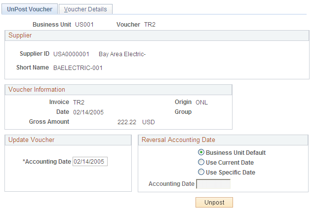

UnPost Voucher Page
Use the UnPost Voucher page (VCHR_UNPST1) to unpost vouchers.
Navigation:
Accounts Payable, and then Vouchers, and then Add/Update, and then UnPost Voucher, and then Unpost Voucher
This example illustrates the fields and controls on the UnPost Voucher page. You can find definitions for the fields and controls later on this page.
UnPost Voucher page
After a voucher is posted using the Voucher Posting Application Engine process (AP_PSTVCHR), PeopleSoft Payables prevents you from changing distribution line fields by disabling those fields on the online Voucher component (VCHR_EXPRESS). If you must update distribution line information after posting, you must first unpost the voucher.
Unposting a voucher instructs the PeopleSoft Payables system to create reversing entries that undo the effects of the posting. Unposting happens immediately when you save the UnPost Voucher page.
Any unpaid voucher can be unposted. Fully or partially paid vouchers can be unposted only if you select Allow Unpost Paid Vouchers on the Procurement Controls - General Controls page for the related general ledger business unit.
Update Voucher
Field or Control Description
Accounting Date
Override the accounting date, which defaults from the original voucher. This field is required.
Reversal Accounting Date
Business Unit Default
Select this option to accept the business unit default as the date of the accounting reversal. The system checks the accounting date indicator on the Payables Options page and uses the specified accounting date.
Use Current Date
Select this option to make the current date the date of the accounting reversal.
Use Specific Date
Select this option if you want to enter the accounting date to which the reversals will post.

Unposting Action
Unpost
Click to start the unposting process. The system issues a message prompting you to confirm the unpost. If you want to continue with the unpost, click OK.
Before you unpost the voucher, view voucher details on the Voucher Details page.
Once you have unposted the voucher, you can update it using the Voucher component or the Voucher Maintenance component and repost it. If the voucher is unpaid, then all voucher fields are available for updating (unless it is a register voucher, in which case only voucher line and distribution lines fields can be updated). However, if the voucher has been paid or partially paid, all fields are completely unavailable for edit.
