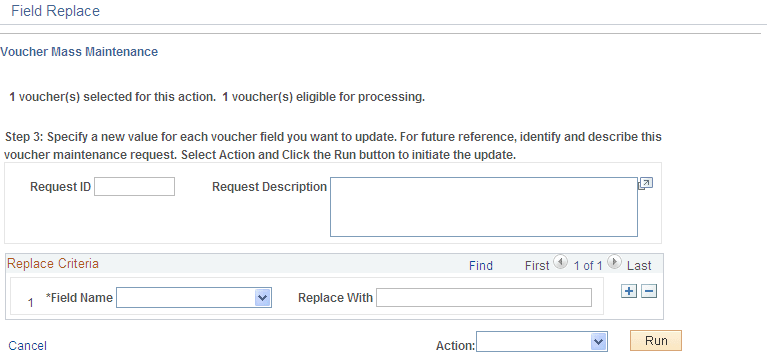

Voucher Mass Maintenance Processing of Field Replacement
The Voucher Mass Maintenance process performs the following processing for field replacement:
  • Selects and updates voucher tables with the new field values.
  • Sets the voucher entry status to M or modified.
  • Resets budget checking status to Not Budget Checked (only when Commitment Control is enabled).
  • Resets the document tolerance status to Not Checked (only when document tolerance checking is enabled).
  • Deletes scheduled payments records (only for a Payment Terms field replacement).
You must run the Voucher Build process to edit the replaced field values and complete the vouchers.

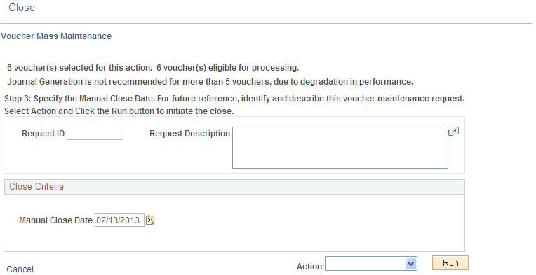

Voucher Mass Maintenance Processing of Voucher Closure
The Voucher Mass Maintenance process calls the Voucher Close Application Engine process (APVCHRCLOSE) to perform the following processing:
  • Updates the voucher close status to closed and updates manual close date entered on the Voucher Mass Maintenance - Close page for the selected vouchers.
  • Updates document sequencing numbers (only if document sequencing is enabled).
You must run the Voucher Posting process to create the closure accounting entries.
For performance reasons, it is not recommended to run the Journal Generator process when you are closing more than five vouchers.

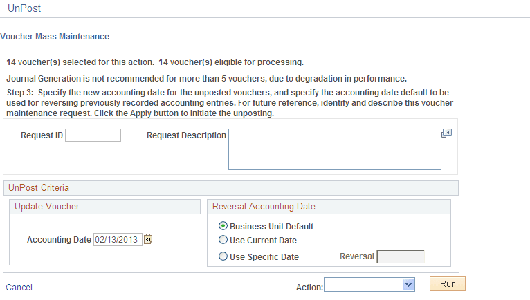

Voucher Mass Maintenance Processing of Voucher Unposting
The Voucher Mass Maintenance process calls the Voucher UnPost Application Engine process (APVCHRUNPOST) to perform the following processing:
  • Updates voucher status to unposted and updates the accounting date.
  • Posts reversal entries (with the reversal accounting date selected on the Voucher Mass Maintenance - UnPost page) to the voucher accounting tables.
  • Updates the ENTRY_STATUS from D or Defaulted to M or Modified.
  • Updates Entry Event codes (only if Entry Event processing is enabled).
For performance reasons, it is not recommended to run the Journal Generator process when you are unposting more than five vouchers.

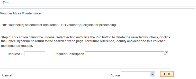

Voucher Mass Maintenance Processing of Voucher Deletion
The Voucher Mass Maintenance process calls the Voucher Delete Application Engine process (APVCHRDELETE) to perform the following processing:
  • Deletes vouchers from the voucher tables.
    The voucher row remains in the voucher tables, but the voucher ID is marked as unavailable. This is irreversible.
  • Deletes corresponding match exceptions and match details records.
  • Deletes corresponding duplicate invoice records.
  • Deletes corresponding doc sequencing records (only if document sequencing is enabled).
  • Resets the budget checking status of the voucher to Not Checked (only if Commitment Control is enabled).
    The voucher is backed out of the budget ledger upon the next run of the Budget Processor.
See Unposting Individual Vouchers.

Field replacement
The following vouchers are excluded:
  • Vouchers that have been posted, selected for payment, or paid, fully or in part.
  • Third Party Vouchers.
  • Uncompleted registered vouchers.
  • Vouchers in a control group in Verified status.
Closure
Vouchers must meet the following requirements:
  • Vouchers must be posted, not matched, and not yet selected for payment or fully paid.
  • Vouchers cannot have a manual closed date assigned (cannot be marked for closure manually, but not yet posted).
  • Vouchers cannot have document sequencing enabled, if the default Close document type (at the voucher header's general ledger business unit) has not been set up for auto-number assignment.
  • Vouchers enabled for Commitment Control cannot reference a receiver. With Commitment Control enabled, you can close PO vouchers with the Mass Maintenance functionality, but you cannot restore encumbrances.
  • Vouchers cannot be associated with a debit memo adjustment voucher if the debit memo adjustment voucher has not been closed.
Deletion
  • Vouchers that are posted, selected for payment, or paid in part or full.
  • Vouchers in Matched status.
  • Vouchers having any scheduled payments selected by the Pay Cycle process or on hold for netting processing.
  • Vouchers that are associated with a debit memo adjustment voucher if the debit memo adjustment voucher has not been deleted.
Unposting
  • Vouchers must be posted; approval and payment status are not a factor.
  • Vouchers cannot have document sequencing enabled, if the default Accrual or Voucher Unpost document type (at the voucher header's general ledger business unit) has not been set up for auto-number assignment, or if the Interunit document type (at a distribution line's general ledger business unit, if different from the voucher header general ledger business unit) has not been set up for auto-number assignment.
User voucher style restrictions are also enforced for field replacement, but not for closure, deletion, or unposting.

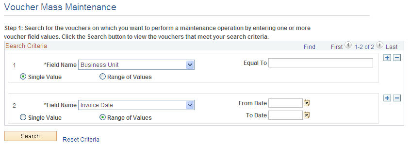

Voucher Mass Maintenance Page
Use the Voucher Mass Maintenance page (VCHR_MASS_MAINT) to search for multiple vouchers for mass maintenance and select the maintenance operation you want to perform: field replacement, unposting, closing, or deleting.
Navigation:
Accounts Payable, and then Vouchers, and then Maintain, and then Voucher Mass Maintenance
This example illustrates the fields and controls on the Voucher Mass Maintenance page (1 of 2).
This example illustrates the fields and controls on the Voucher Mass Maintenance page: search results (2 of 2).

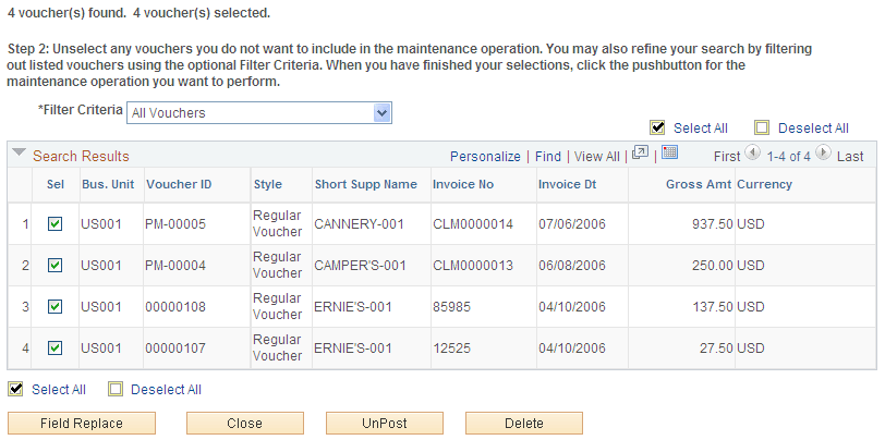

To select vouchers for mass maintenance:
  1. Enter one or more voucher field values or ranges of values.
    Restrict your search as narrowly as possible to increase the speed with which you retrieve your search.
    You can filter vouchers based on the supplier's financial sanctions status if financial sanctions validation is enabled at the installation level or the bank level.
  2. Click the Search button to retrieve the vouchers that meet your search criteria. The vouchers appear in the Search Results grid.
    Select the Reset Criteria link to clear the search results and enter new search criteria.
  3. (Optional) In the Step 2 region of the page, which appears after you click Search, you can filter the retrieved vouchers by the following Filter Criteria:
    • All Vouchers.
    • Vchrs that can be Fld Replaced (vouchers that can be field replaced).
    • Vouchers that can be Closed.
    • Vouchers that can be Deleted.
    • Vouchers that can be UnPosted.
    Each of these filter criteria is associated with its own set of eligibility requirements.
    See Understanding Voucher Mass Maintenance.
    If you do not apply filter criteria here, the system still filters out the vouchers by the appropriate eligibility criteria when you select the maintenance operation and open the page for that operation. The filter criteria here enable you to filter the vouchers before you begin selecting them individually.
    Note also that the vouchers available for field replacement depend on the voucher styles you have access to, as defined for your user preferences. If you select a filter criterion of All Vouchers, the results grid shows vouchers of all styles, regardless of your voucher style access. When you select field replacement as the maintenance operation to perform on your selected vouchers, however, only the vouchers whose style you have access to will be available on the Field Replace page.
  4. Select the vouchers you want to perform maintenance on by selecting or deselecting the Sel (select) options.
  5. Click the button for the maintenance operation you want to perform:
    • The Field Replace button accesses the Voucher Mass Maintenance - Field Replace page.
    • The Close button accesses the Voucher Mass Maintenance - Close page.
    • The UnPost button accesses the Voucher Mass Maintenance - UnPost page.
    • The Delete button accesses the Voucher Mass Maintenance - Delete page.

Navigation:
Select vouchers on the Voucher Mass Maintenance page and click the Field Replace button.
This example illustrates the fields and controls on the Voucher Mass Maintenance - Field Replace page.
If you did not use the appropriate filter criteria on the Voucher Mass Maintenance search page, some of the vouchers you selected may be ineligible for field replacement. The page informs you of the number of vouchers you selected and the number of these which are eligible for field replacement.
To replace fields on the selected vouchers:
  1. (Optional) Identify and describe the field replacement request.
  2. Enter the fields whose values you want to replace and the new values.
    There are selection fields that are not available for replacement.
    The only online validation of field values is for field length and data type. The Voucher Build process edits field values for field-replaced vouchers.
  3. Select to run one of the following on-demand processes.
    • Select 1. Mass Maintenance, which performs the Voucher Mass Maintenance process to update the voucher tables and sets the voucher entry status to M or modified.
    • Select 2. Voucher Build, which performs the Voucher Mass Maintenance process tasks, and also runs the Voucher Build process to edit the vouchers and update the voucher tables.
Voucher Mass Maintenance - Close Page
Use the Voucher Mass Maintenance - Close page (VCHR_MMT_CLSE_SEC1) to enter the manual close date and request ID and run the Voucher Mass Maintenance process to close the selected vouchers.
Navigation:
Select vouchers on the Voucher Mass Maintenance page and click the Close button.
This example illustrates the fields and controls on the Voucher Mass Maintenance - Close page.
If you did not use the appropriate filter criteria on the Voucher Mass Maintenance search page, some of the vouchers you selected may be ineligible for closure. The page informs you of the number of vouchers you selected and the number of these which are eligible for closure.
To close the eligible vouchers:
  1. (Optional) Identify and describe the closure request.
  2. Accept today's date, which is the default, or enter another date as the Manual Close Date.
    The system validates that the close date occurs in an open accounting period.
  3. (Optional) Review any associated purchase orders.
  4. Select to run one of the following on-demand processes.
    • Select 1. Mass Maintenance, which performs the Voucher Mass Maintenance process to update the voucher tables and mark the vouchers for closure.
    • Select 2. Voucher Post, which performs the Voucher Mass Maintenance process tasks, and also run the Voucher Posting process to close the vouchers and update the voucher tables.
    • Select 3. Journal Generator, which performs the Voucher Mass Maintenance and the Voucher Posting processes tasks, and also run a process that creates PeopleSoft General Ledger journal entries.
      For performance reasons, it is not recommended to run 3. Journal Generator when you are processing more than five vouchers.
After the process completes, a message appears informing you that it was successful.

Voucher Mass Maintenance - UnPost Page
Use the Voucher Mass Maintenance - UnPost page (VCHR_MMT_UNPS_SEC1) to enter the unposting accounting date, reversal accounting date, and request ID and run the Voucher Mass Maintenance process to unpost the selected vouchers.
Navigation:
Select vouchers on the Voucher Mass Maintenance page and click the UnPost button.
This example illustrates the fields and controls on the Voucher Mass Maintenance - UnPost page.
If you did not use the appropriate filter criteria on the Voucher Mass Maintenance search page, some of the vouchers you selected may be ineligible for unposting. The page informs you of the number of vouchers you selected and the number of these which are eligible for unposting.
To unpost the eligible vouchers:
  1. (Optional) Identify and describe the unposting request.
  2. Select a new accounting date for the unposted vouchers in the Update Voucher group box.
    The system validates that the date occurs in an open accounting period.
  3. Select the accounting date for the reversal accounting entries in the Reversal Accounting Date group box.
    This group box appears only if:
    • One of the vouchers you are unposting has had its accounting entries journal-generated to the general ledger, loaded to asset management, distributed to the Project Costing tables, or distributed to the VAT subsystem.
    • One of the vouchers is enabled for document sequencing.
    If there are any vouchers that are ineligible for the reversal accounting date option that you select, the system will apply the original voucher accounting date to the reversal entries.
    If you select either the Use Current Date or Use Specific Date option, the system validates that the date occurs in an open accounting period.
    The business unit default accounting date is set up on the Payables Options - Payables Options page.
    • Select 1. Mass Maintenance, which performs the Voucher Mass Maintenance process to update the voucher tables and unpost the vouchers.
    • Select 2. Journal Generator, which performs the Voucher Mass Maintenance process tasks, and also run a process that creates PeopleSoft General Ledger journal entries.
      For performance reasons, it is not recommended to run 2. Journal Generator when you are processing more than five vouchers.
Voucher Mass Maintenance - Delete Page
Use the Voucher Mass Maintenance - Delete page (VCHR_MMT_DLTE_SEC1) to enter the request ID and run the Voucher Mass Maintenance process to delete the selected vouchers.
Navigation:
Select vouchers on the Voucher Mass Maintenance page and click the Delete button.
This example illustrates the fields and controls on the Voucher Mass Maintenance - Delete page.
If you did not use the appropriate filter criteria on the Voucher Mass Maintenance search page, some of the vouchers you selected may be ineligible for deletion. The page informs you of the number of vouchers you selected and the number of these which are eligible for deletion.
To delete the eligible vouchers:
  1. (Optional) Identify and describe the deletion request.
    This is required if any of the vouchers on your list are enabled for document sequencing.
  2. Select 1. Mass Maintenance, which performs the Voucher Mass Maintenance process to update the voucher tables and delete the vouchers.
    Typically, you cannot delete a voucher if there have been accounting entries generated. However, if only Period End Accrual entries have been generated for the voucher, the voucher will still be eligible for deletion. This will not impact the reversal entry generated by the Period End Accruals.  In this case, you should consult with your General Ledger Accounting product members to determine if a manual Journal Entry is desired to reflect the accounting of the voucher being deleted and its effect on the previously generated Period End Accrual.
    WARNING:
    Once you click this button, the vouchers will be deleted immediately from the system.
