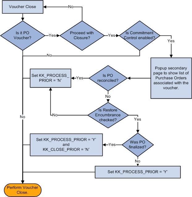

The following diagram illustrates the PeopleSoft Payables voucher closure processing logic for scenarios involving associated purchase orders and Commitment Control integration.
PeopleSoft Payables voucher close processing logic, for scenarios involving associated purchase orders and Commitment Control integrationvoucher closureprocessing logic, diagram of
